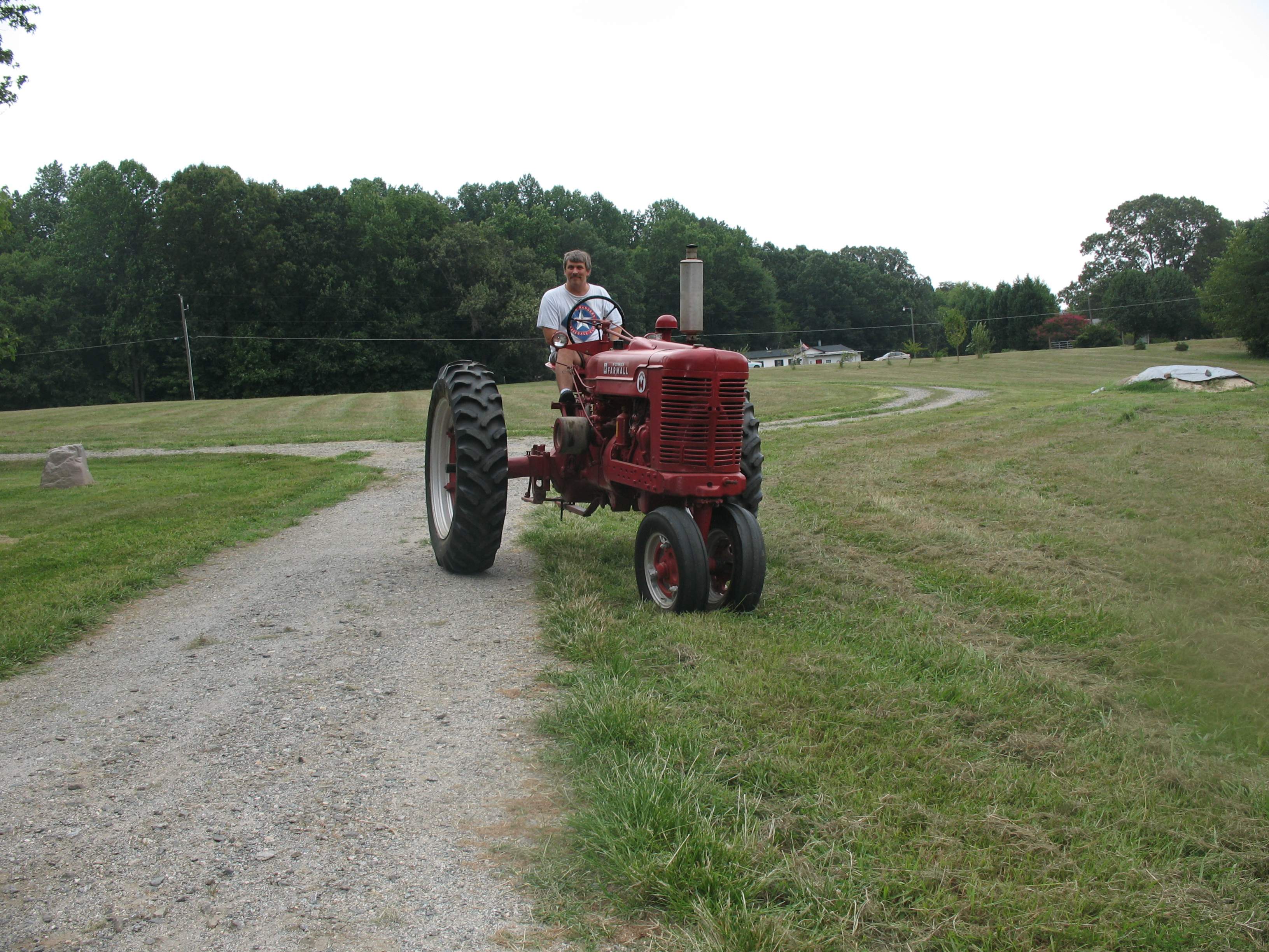

Can you use the cutter as a mower? Depends on how "finished" you expect the place to be. If you're keeping a finely-groomed lawn (mowed every week at 4" or less, watered when necessary, fertilizer, weed control, clippings taken up, etc.), no, a brush cutter isn't in the picture. If you figure to keep it a bit taller (say, 6") and generally have a more rustic look, the cutter is probably going to be OK.
Here's a random photo from our place, taken a few weeks ago, showing a field that we keep mowed with the cutter. I had just mowed the previous day in anticipation of weekend guests (one of whom is driving the Super M). You can see the clippings, it's all about 6" tall and looks fine as a field (but nobody would ever call it a "lawn", which is OK with me).
