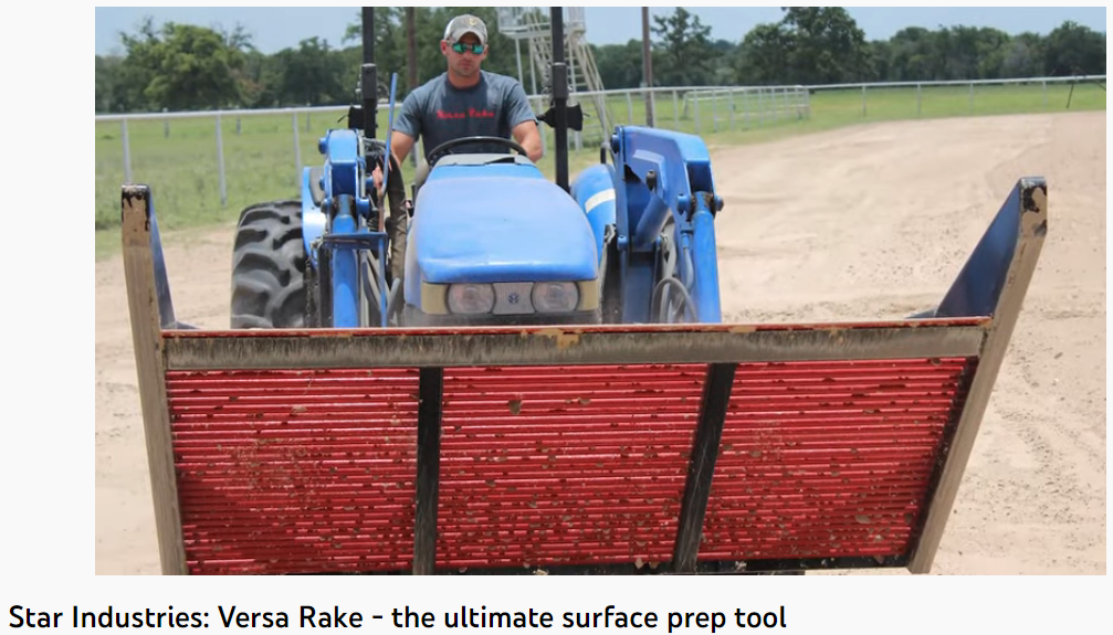

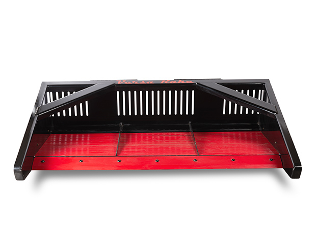

Evidently your tractor has SSQA (Skid Steer Quick Attach).

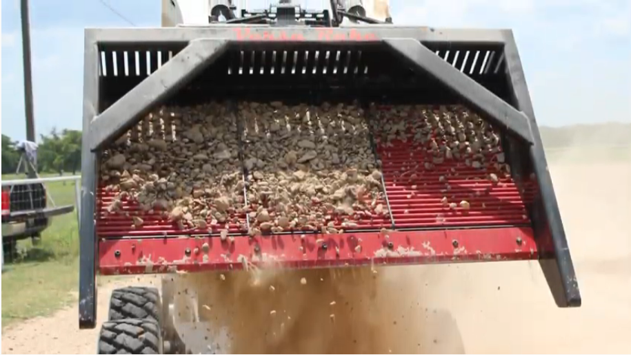

This is a sifting bucket that is on my wish list: https://www.starindustries.com/product/versa-rake/

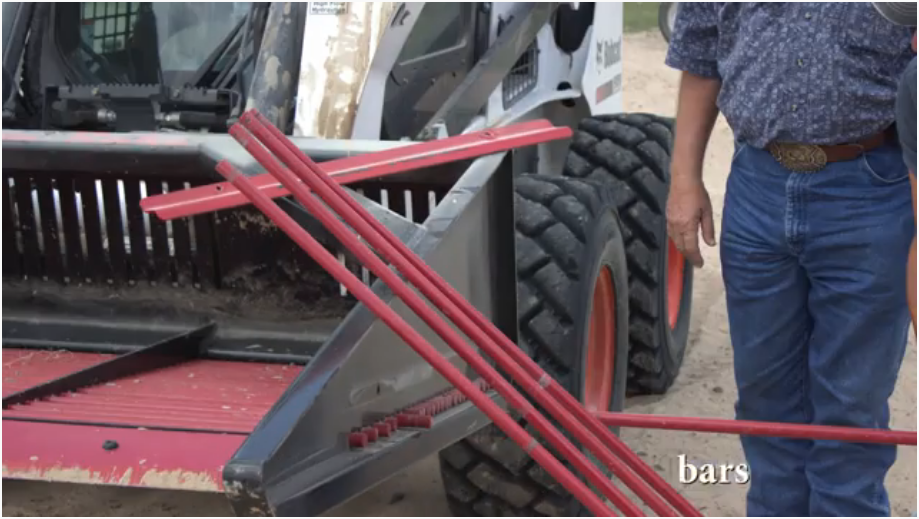

And the bar spacing is adjustable:

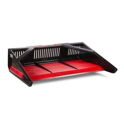

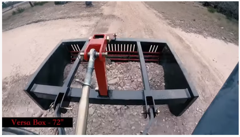

And the 3 point version:

Well, this is the first time I've seen something like this with the ability to adjust the slat size. Pretty smart. Looks a little flimsy from the pictures but the weight seems to say otherwise. Lots of steel for sure. Know how much they cost? Probably go for the 60" if I were to go this route.

I use my rock/skeleton buckets a lot - we have sevearl. Used mostly for sorting the rocks out of dirt. Our land is old creek bottom and has lots of stones. For such a simple implement, it took a surprisingly long time to get really good at using it for sorting. But now after a few hours one pile becomes two - we have pile of dirt and a separate pile of stones.
There is a trick to using the rock bucket - pick up a little bit of dirt and rock with the teeth in the front and then tilt the bucket so that that small amount slides back.....sorting as it does. A bucket used this way tends to be longer front to back than side to side. And the necessity to slide it back does limit how much can be picked and sorted in one bucket load, but nothing works better. At first we tried picking up a full bucket and shaking it, but the load just sits there. Maybe some dirt dribbles out the bottom but not much.
Slat shape and spacing counts for a lot too. Also, the bucket needs to be able to tilt up quite a bit more than most do. So you will need some protection at the top of the back of the bucket to prevent dumping a load on the hood or in your lap.
I've written on this before, but we ended up buying several different configurations of rock bucket before figuring out what worked for our soil and sorting. My first buckets had flat laser cut bottom slats which looked fancy and aggresive - but worked poorly. The one that worked best has round tines with a bend in the front and it definitely longer front to back
Looks can fool with ground-engaging implements and buckets. The versa-bucket I see in the posts right before this one doesn't look like it would work for us. But you can't tell until using one.
