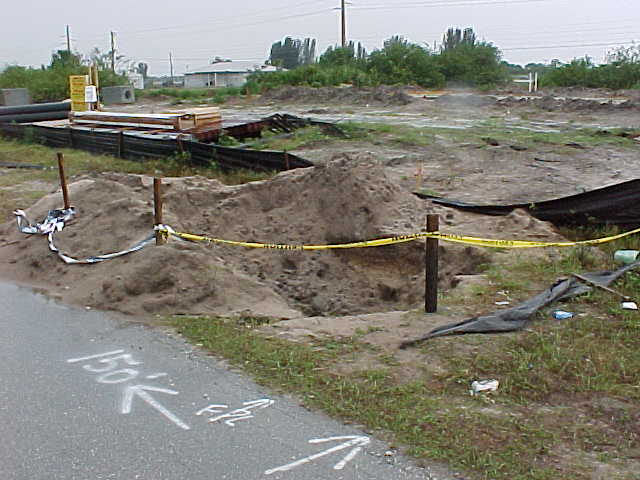

But, look at what the city's utility department did, right outside the silt fences! This hole, and the one in the next post, are to bury a water line under the street. They dug them over a week ago, and then just left them.

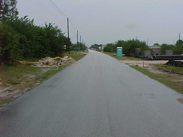

This is the matching hole across the street.
My driveway is just down to the left.

Interestingly, it had been raining -- very hard -- for about 4 hours before I took these pictures, and there was not one ounce of silt or washout. These things may have value where there are slopes, but here, where it''s flat, they appear to just be a waste of the developer's money. We have had over 41,000 homes and commercial buildings constructed within the city in the last 30 years before these regulations came into effect, and I can't remember ever seeing any silt or clogging in the swales that wasn't caused by machinery driving through them.
