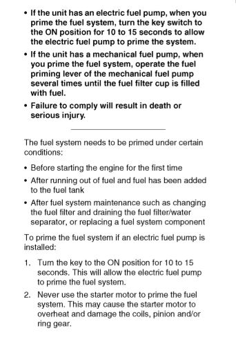

Anyone have advice on cleaning water separator, it appears to be located in front of the radiator on the RK24, I have never done this type of procedure before and the manual is vague unless I am missing something.
Words of wisdom appreciated.

I hope this provides some help. If not please let me know Daniel Patterson
  • fuel filter.pdf
