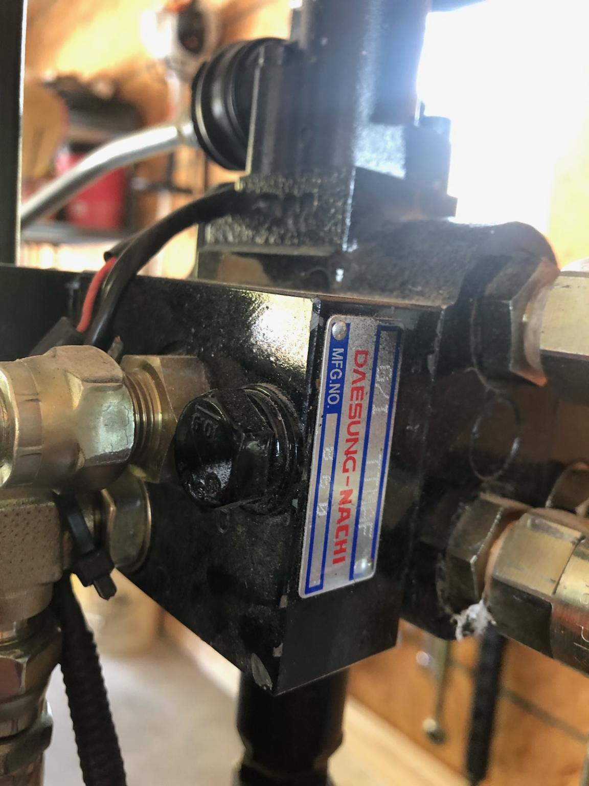

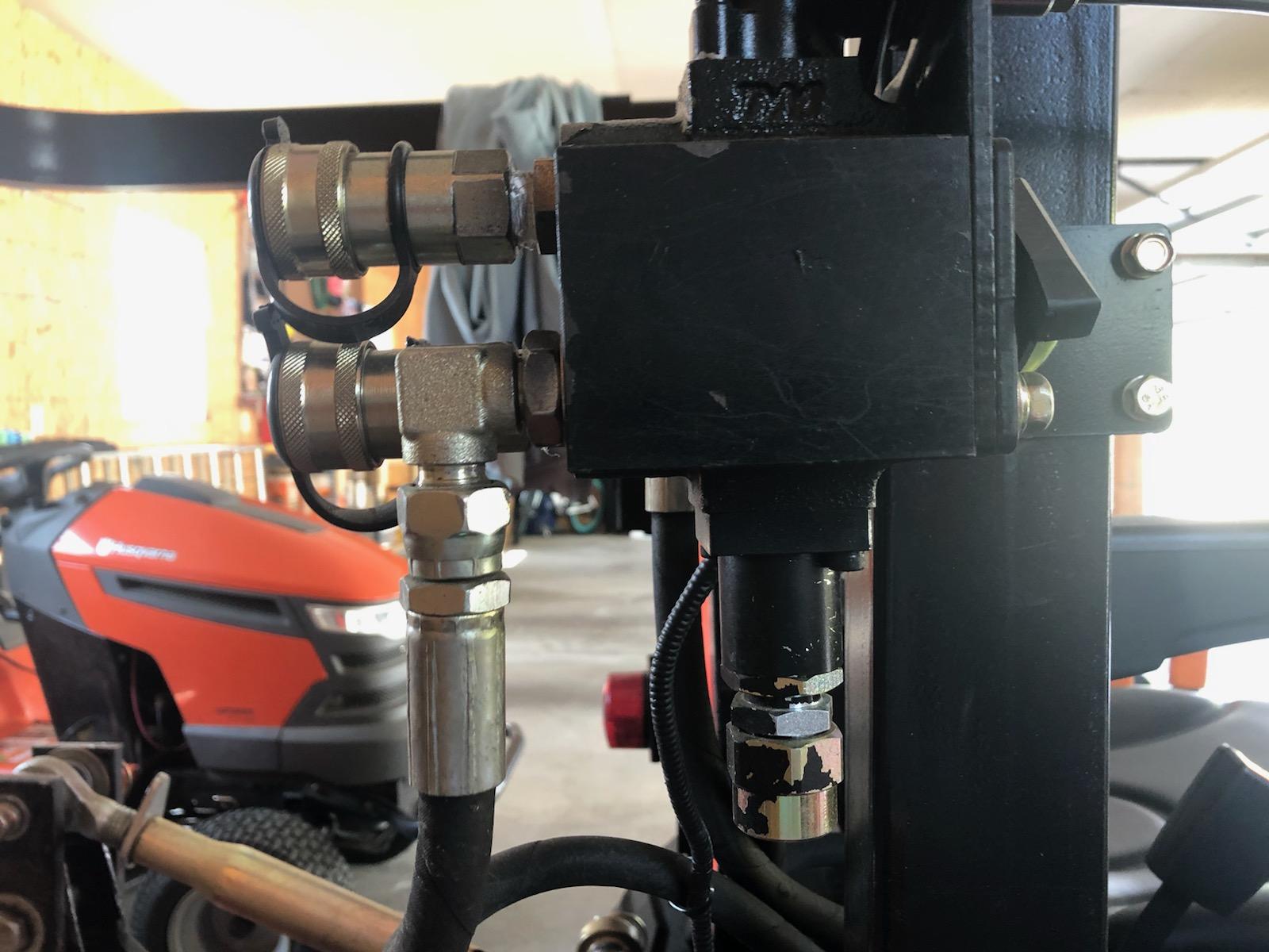

Rural King RK24H
Looking at the rear auxiliary valve on the RK24 there are two ports, one on the bottom unit and one on the ROPS side of the unit that are plugged. I have searched the manufacture sight ( DAESUNG-NACHI) and cannot find a match for this unit on the tractor. Any idea what these are, or could be used for? Was wondering if these ports could possibly be used for another hydraulic source. Any hydraulic engineers out there that might know?? IMG952428.jpgIMG952426.jpg
   / RK 24 Auxiliary Valve #2
The thing on the bottom isn't a port, it's the end of the spool.
The one on the side might not be a port either. It might be, but it might also be a retaining plug for part of the internal valve mechanism.
   / RK 24 Auxiliary Valve #4
Rick,
It is used if you are using aux hydraulics, like a log splitter...there is a handle near that valve that activates that aux system. You want to be carefull not to accidenty move that lever, I think it will make either your FEL or BH inop,
