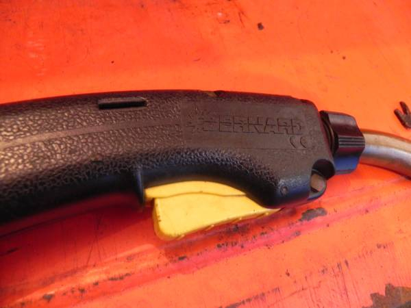

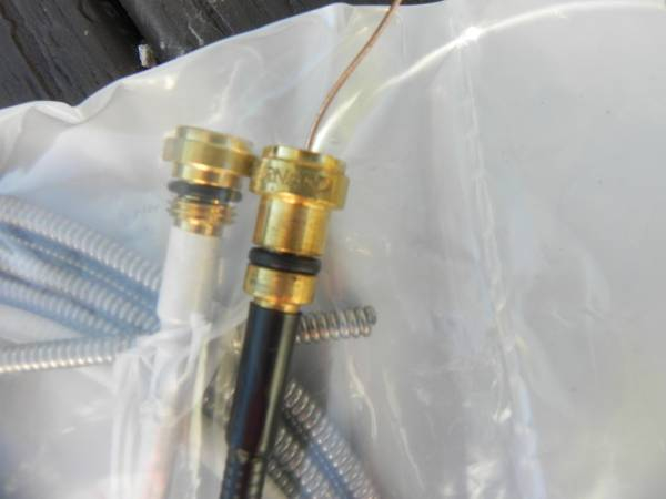

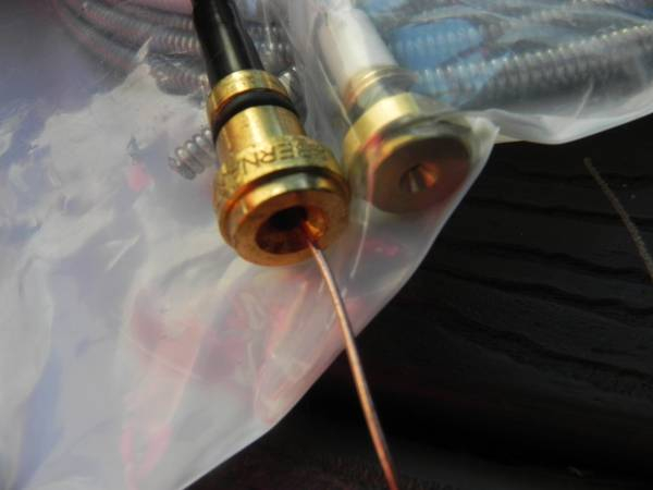

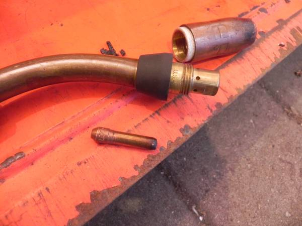

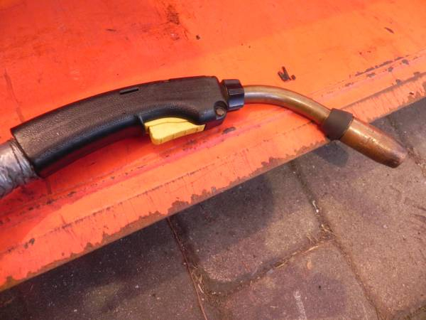

Hello. I was having feed issues, and then the wire jammed in the liner (so it's safe to say I need a new one) and I keep striking out. A bought a jump liner to just replace the last foot (or so) at the gun where the curve is, but I can not seem to unscrew/ take off the silver (curved) 'barrel' of the gun. Then I ordered a new bernard 'universal' liner, but as you can see the ends look quite different. any insight/ anyone run into the same issues.

What you have is a bernard centerfire series gun and the liner you received looks to be for a different style bernard gun.

i agree, but at least on their web site i could not find a different liner for the center fire line. i am a little surprised that there does not appear to be any model #, or anything printed on the gun, unless it is on the cord/hose part of it

The screw in Liner is for the newer Tregaskiss style back end. Bernard and Tregaskiss are ITW Brands. Just tell the LWS you need the old style liner for a Q gun.
