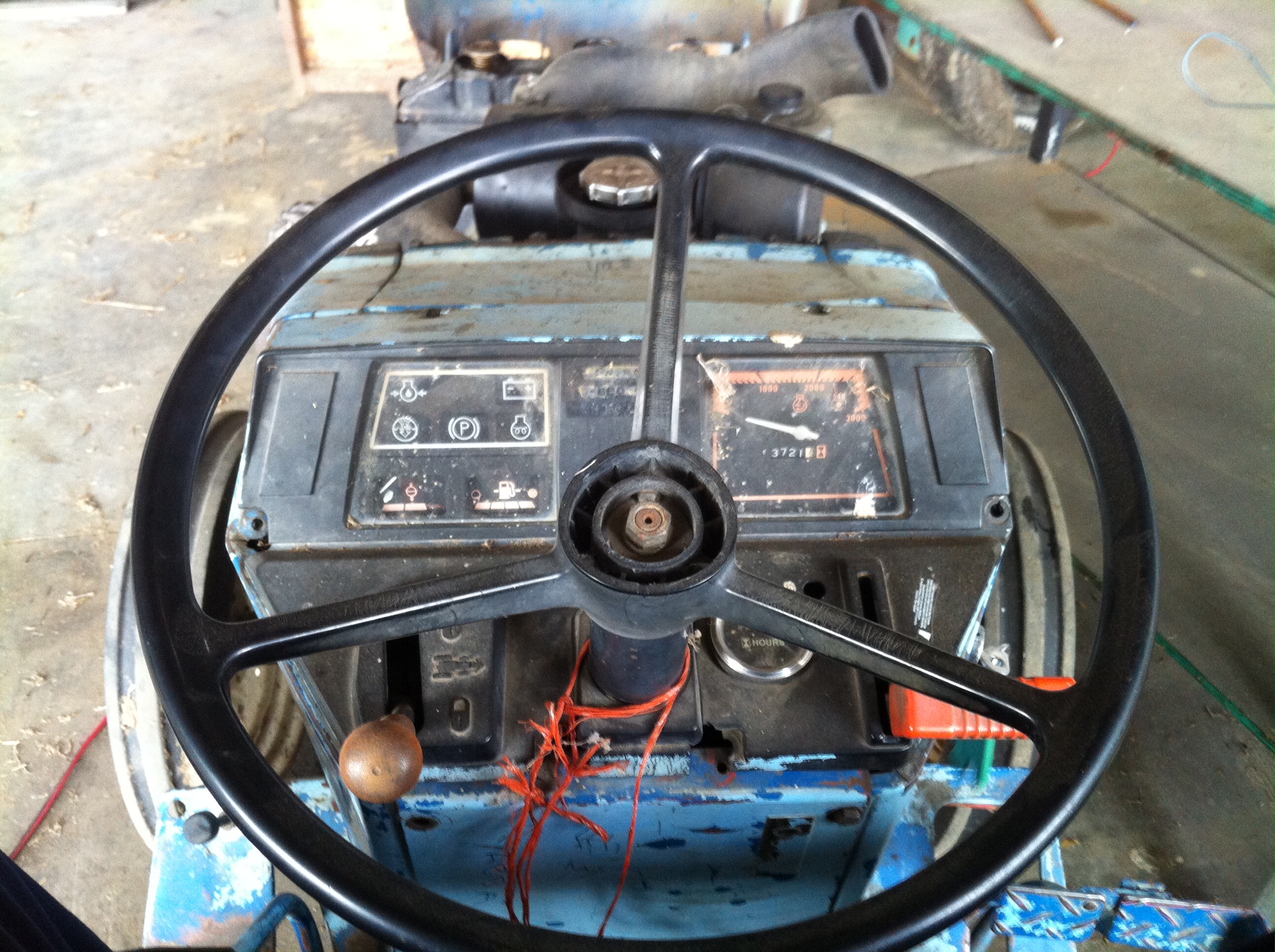

Reviewing the photos I agree with RickB.
It looks like a 20 series Ford 1720, 1920.
Regardless I would check the engine for all issues and then weight a rebuild versus engine swap.

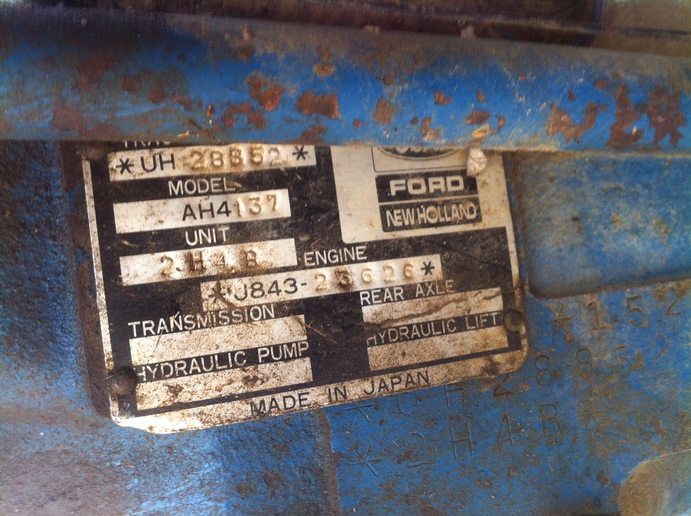

As Rick B. said, it isn't a 1910, but looks like a US TC30, which parts are still available. Your pictures don't indicate why you say it is beyond repair. Aftermarket kits for these engines are availble even if you have to bore and sleeve.

The two posts are my fault, I should be more careful, but get carried away when I think I'm on to a fix or a plan. The tractor turned out to be a 1510 identified by one of the members here by numbers off the block I think. They directed me to find the ID plate
