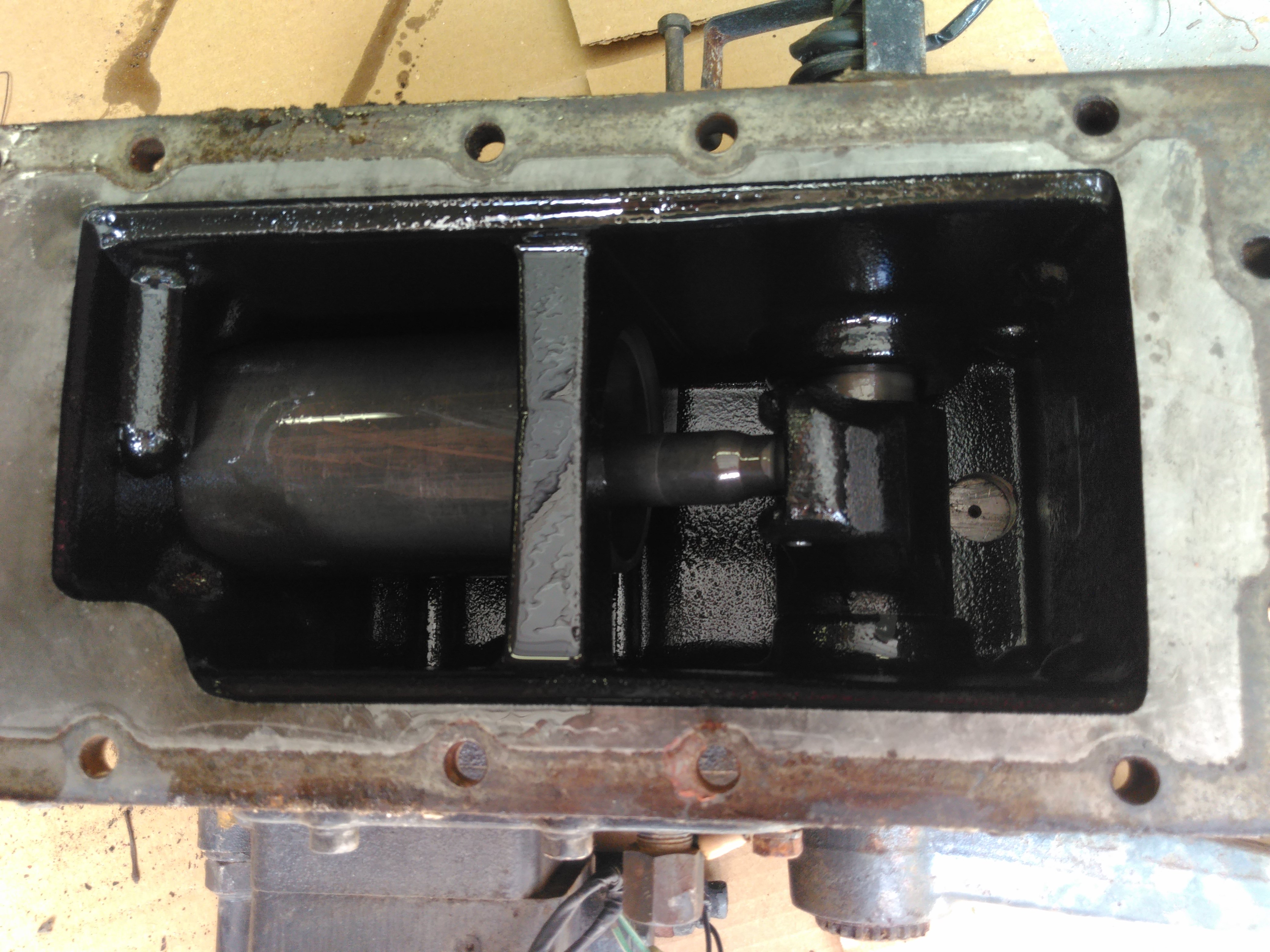

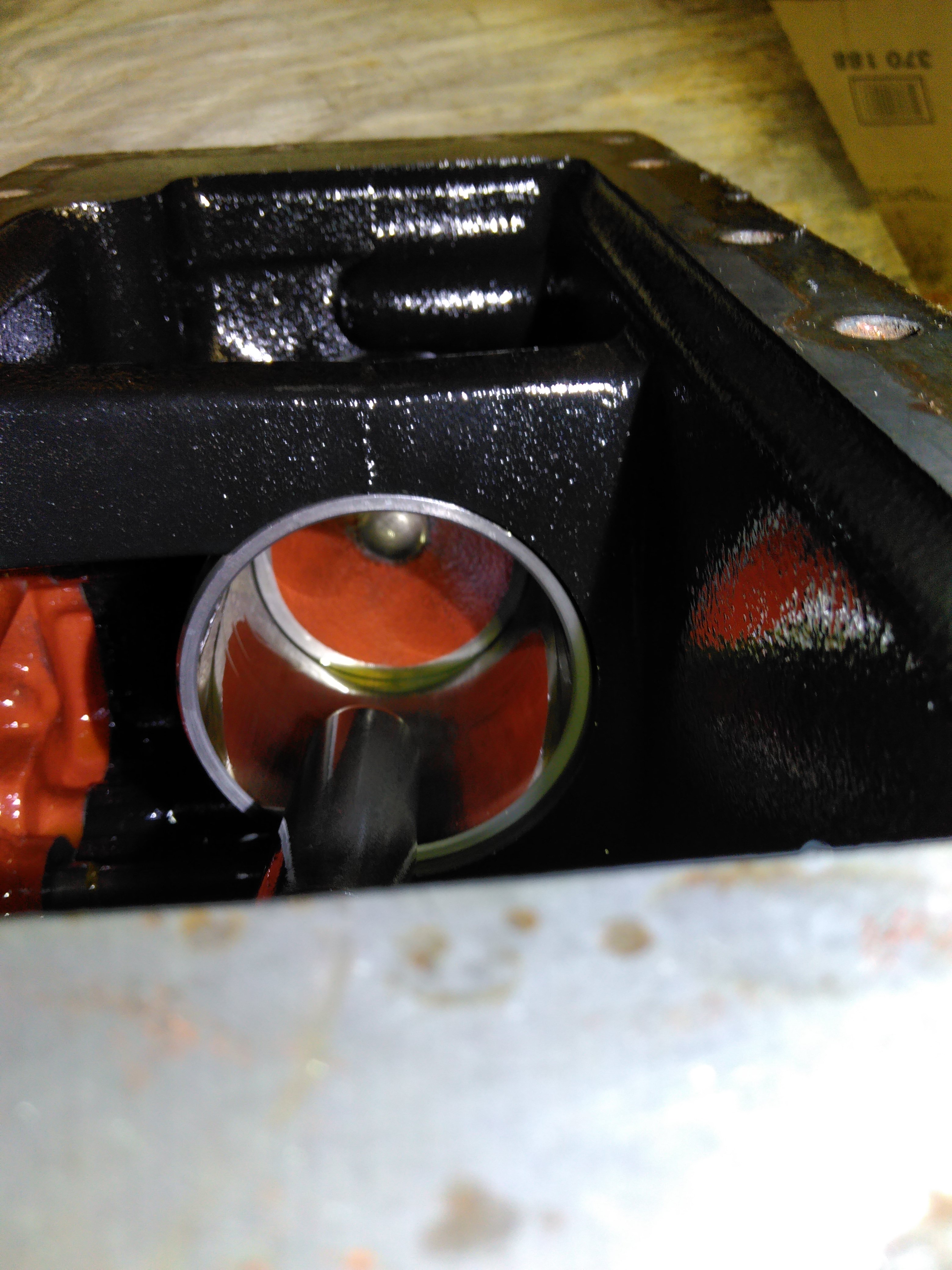

To gain access to the housing, I removed the seat, and the sheet metal deck between lift housing and the seat. It was held in place from bolts accessible from the front, and through the fender wells. There was a single rigid high-pressure hydraulic line attached with a banjo bolt high on the left side of the housing. The housing is attached to the transmission case with with M10 (17mm hex head) fasteners mostly bolts but there were two studs with nuts because the hydraulic control above prevented clearance for bolts. It was necessary to remove the top lift mount on the rear of the housing to permit the bolts to be removed. The housing was a bit heavy but can be lifted by one person.

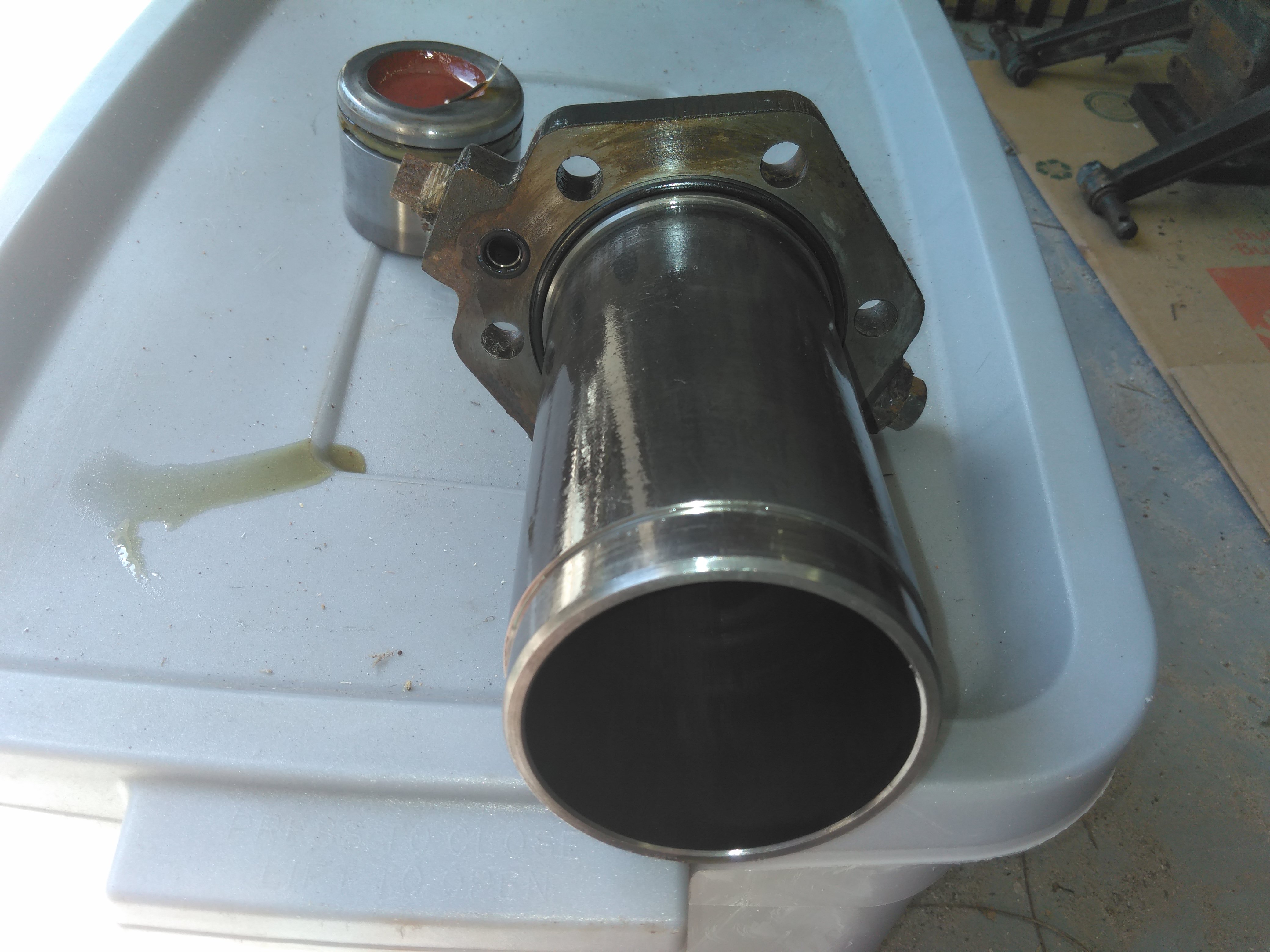

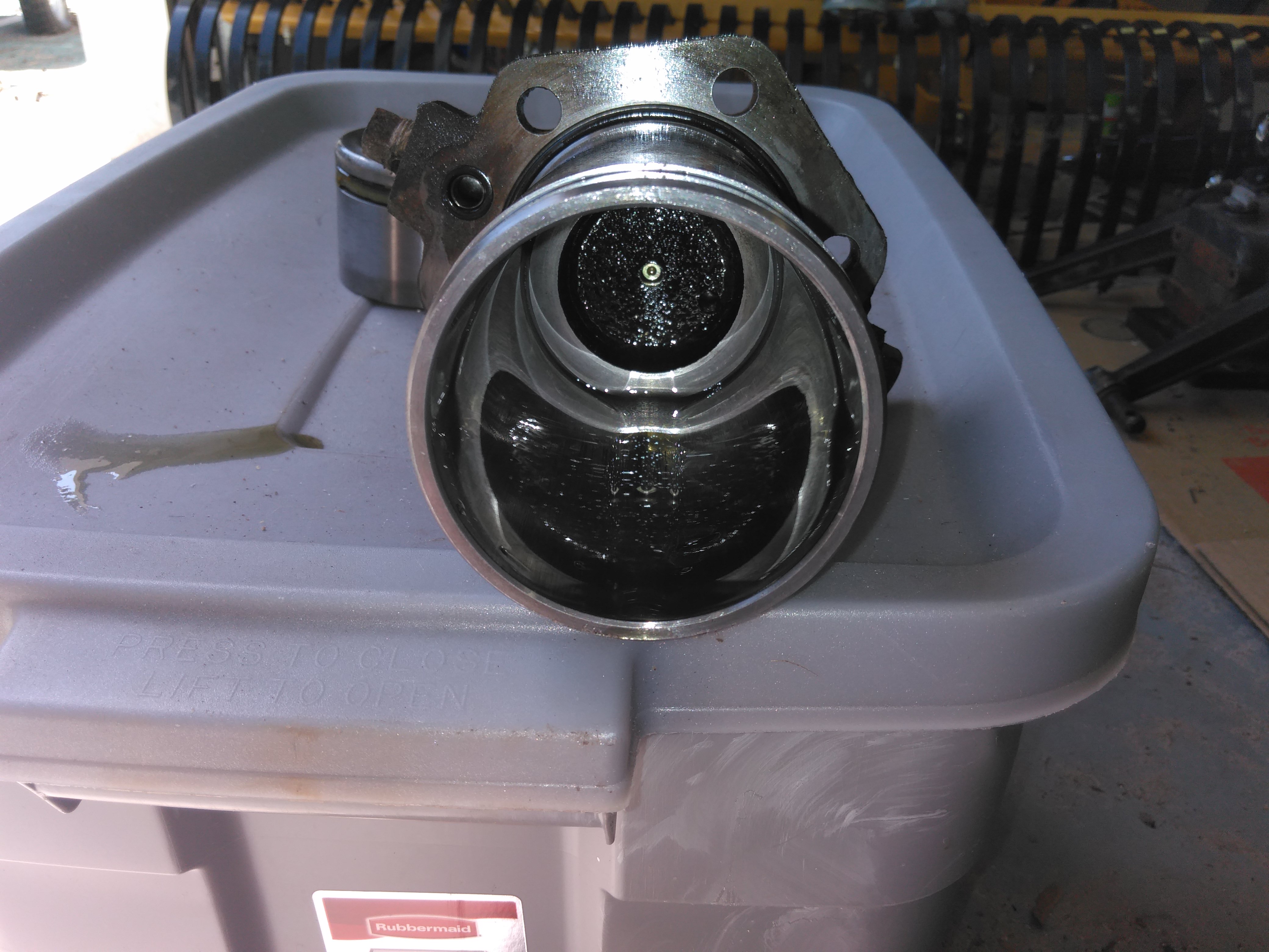

I removed the head (forward) end of the cylinder which was held in place with 6 M12 (19mm hex head). The cylinder assembly slid easily from the housing and the piston slid easily out of the cylinder.

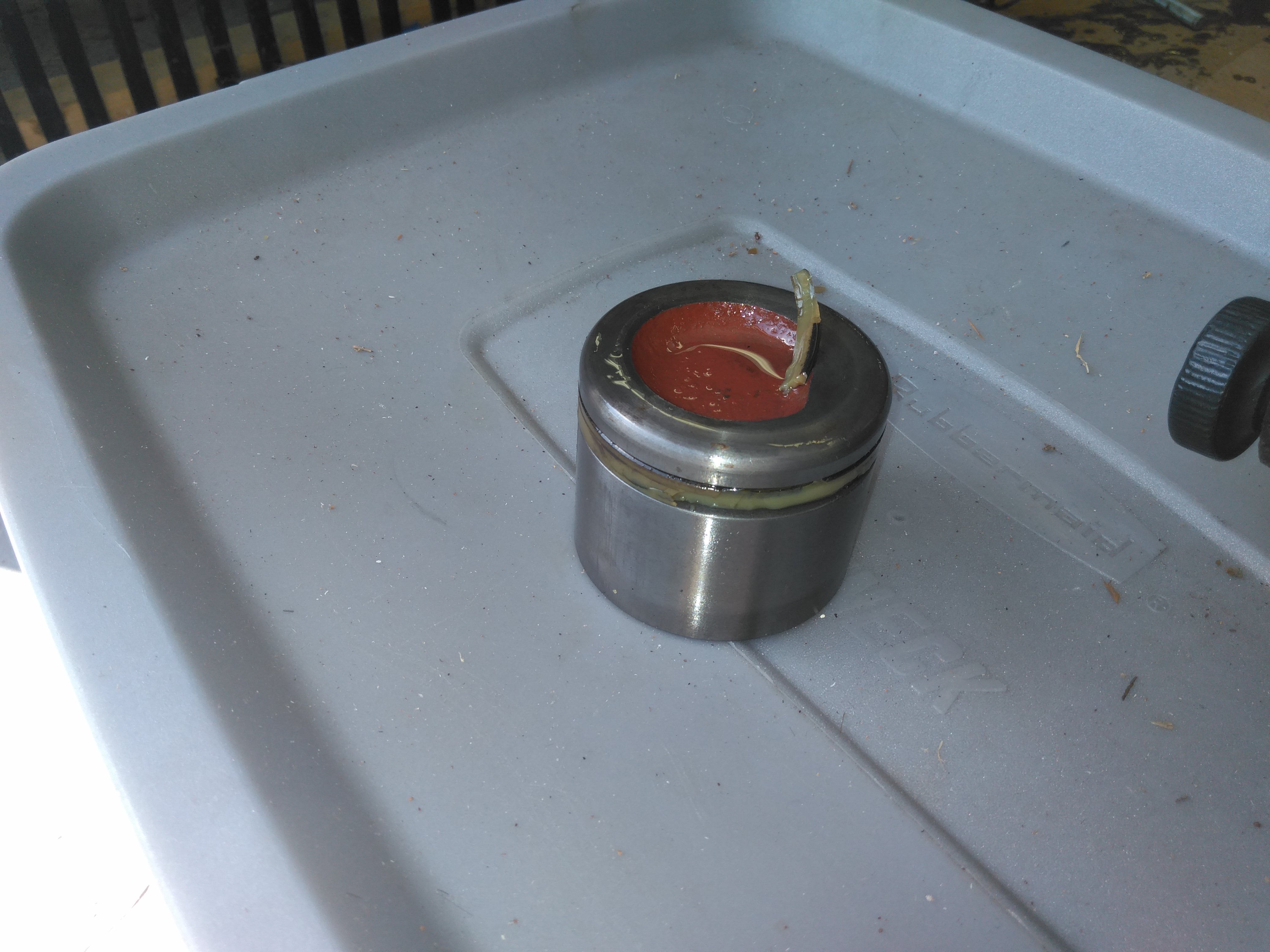

There is an O-ring (about 3.25 inch diameter) between the head and the housing and a small O-ring on the head itself. I imaging both should be replaced. The cylinder seems undamaged but the piston seal is shot. It is hard and brittle. I believe when it was new, it was slid over the piston which seems to be a machined casting. The piston diameter is just under 3 inches I measured 2.954.
I expected a C cross section but this seems to have a rectangular cross section. I am going to go to a hydraulic place tomorrow and see if I can find a replacement. I will take the piston and cylinder since such a place will have been tools for measuring than I do.

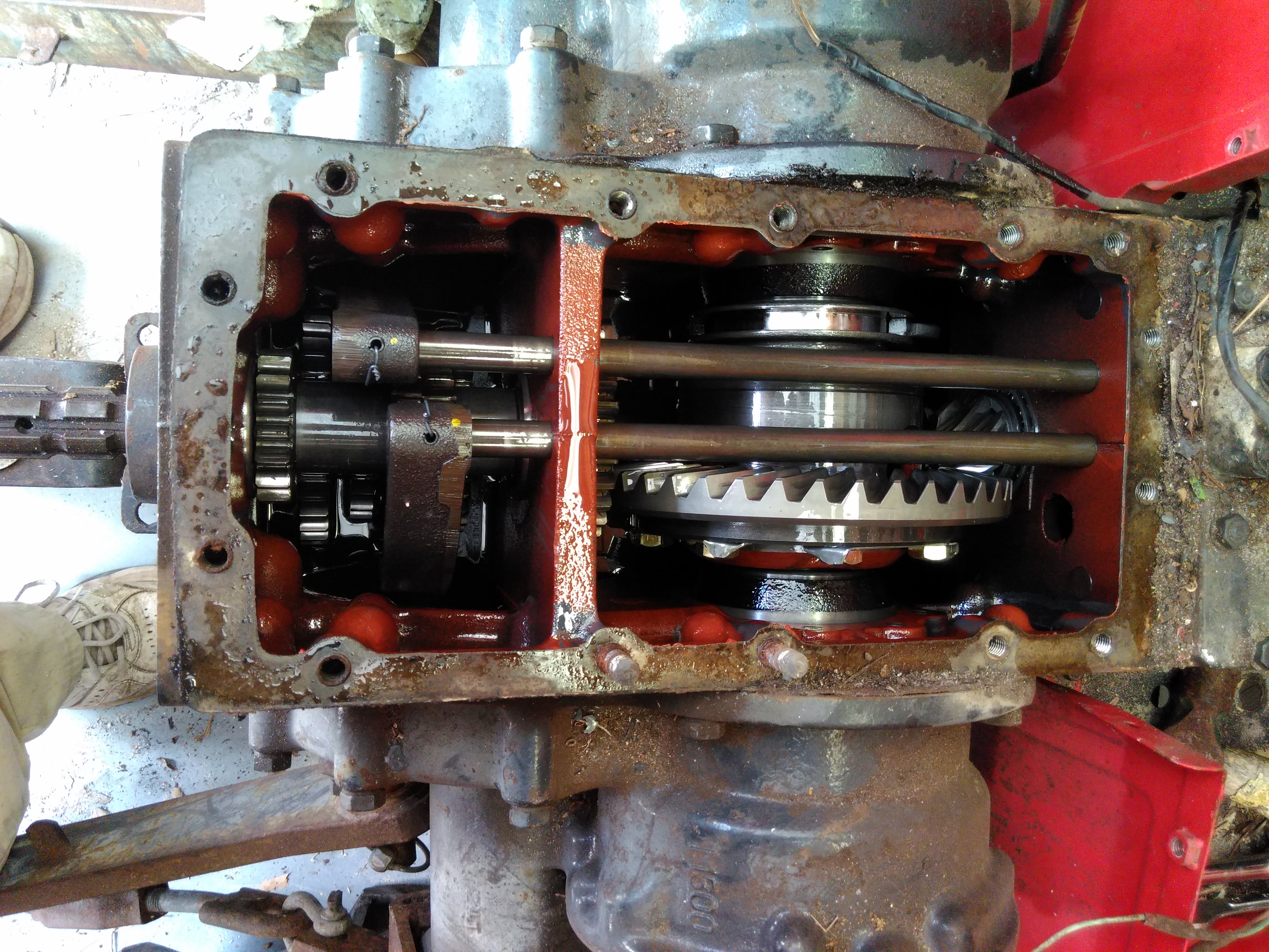

This is the first time I have seen into the transmission housing. The portion below the lift housing is for the 4-speed PTO and the diff lock. They look like I expected except that the parts are more beefy than I am used to from automotive work and, there are no obvious spider gears so I am not sure how the diff works when the diff lock is off. I will attach some images.
I realize I should have blown off the area around this before removing the housing. Access was difficult. I'll be very careful to clean it well without allowing any debris into the transmission case before I reasemble things.
