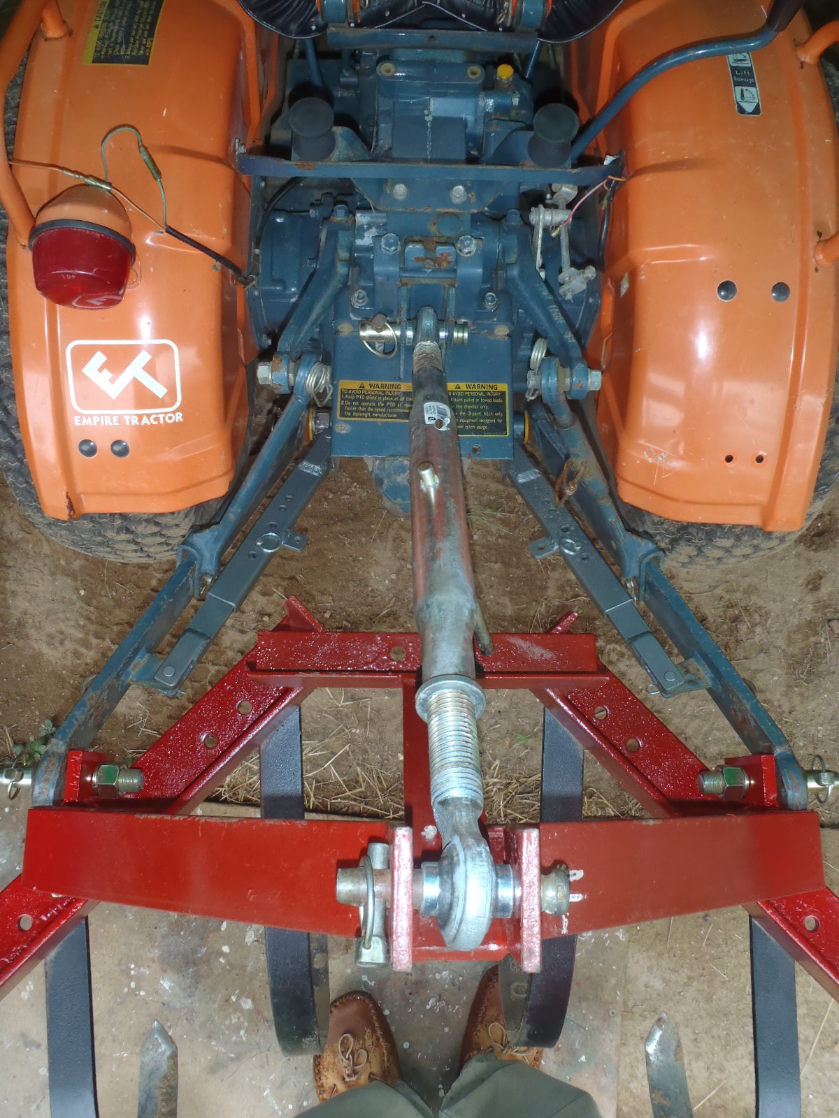

Just replaced the turnbuckles on our B5100 with telescopic stabilizers from StabilWorks:
StabilWorks
The installation took about 20 minutes and they are a huge improvement.
Hitching an attachment is much faster now. I had considered Pat's, but didn't want to move the mounting point any further aft.
Our B5100 can only manage a little over 300 lbs on the 3 point and we have a 40" tiller that it just manages with the present geometry.
Mark was very helpful and warned that I might have to trim the PTO guard a bit (it's close, but so far no clash).
I highly recommend these as a very affordable upgrade to anyone who frequently changes implements and wants to preserve their present hitch geometry. Cast off the turnbuckles of oppression!

Looks good.As I mentioned in another thread I made a set for my BX 2360 and find them to be a definite improvement over the turnbuckles.Just curious what the tab is for on each one?
   / Replaced turnbuckles with telescopic stabilizers
The tabs are parking spots for the pins while you are adjusting the length so you don't drop them.
I paid $131 for the set, which included shipping.
Very reasonable price for a well made, hand built product that works right.
I thought about making my own, but couldn't find exactly the steel sections that I wanted and knew that there would be a lot of trial and error to get everything just right - there isn't much room in that area on the B5100.
