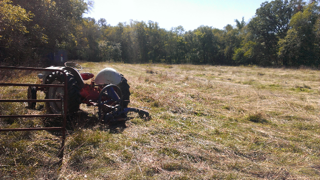

I got it unstuck.... PB blaster soaking for a while. Then, put feet against mower and pulled shaft with left hand while tapping shaft with a hammer in my right hand.... Sanded with sandpaper, lubed and now it slides like a trombone.
Thanks for the help all!

I got it all mowed today. Raking and Baling Friday!

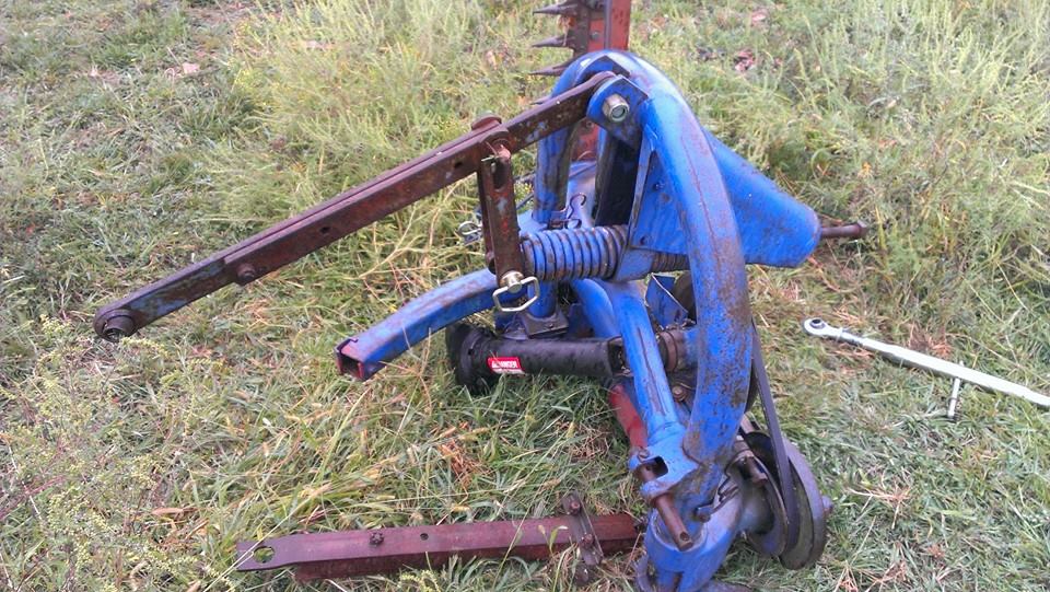

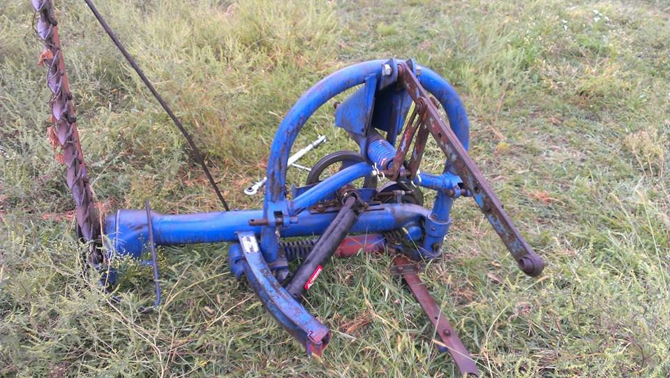

Sorry to hijack but can you tell me what the big spring does that connects to the top link? Mine is missing but I don't understand its purpose. Also is there a way to adjust the blades so they touch the stationary blades? You can see what I mean in my pictures.

The spring acts as a shock absorber of sorts that protects the mower when hitting a foreign object. The sickle needs to lay flat in the bar and shimmed down with the spacers under the toe clamps. Once the sickle is down and level, peck the rock guards with a hammer to get them to touch the sickle. Some may be high and some may be low. Ken Sweet
