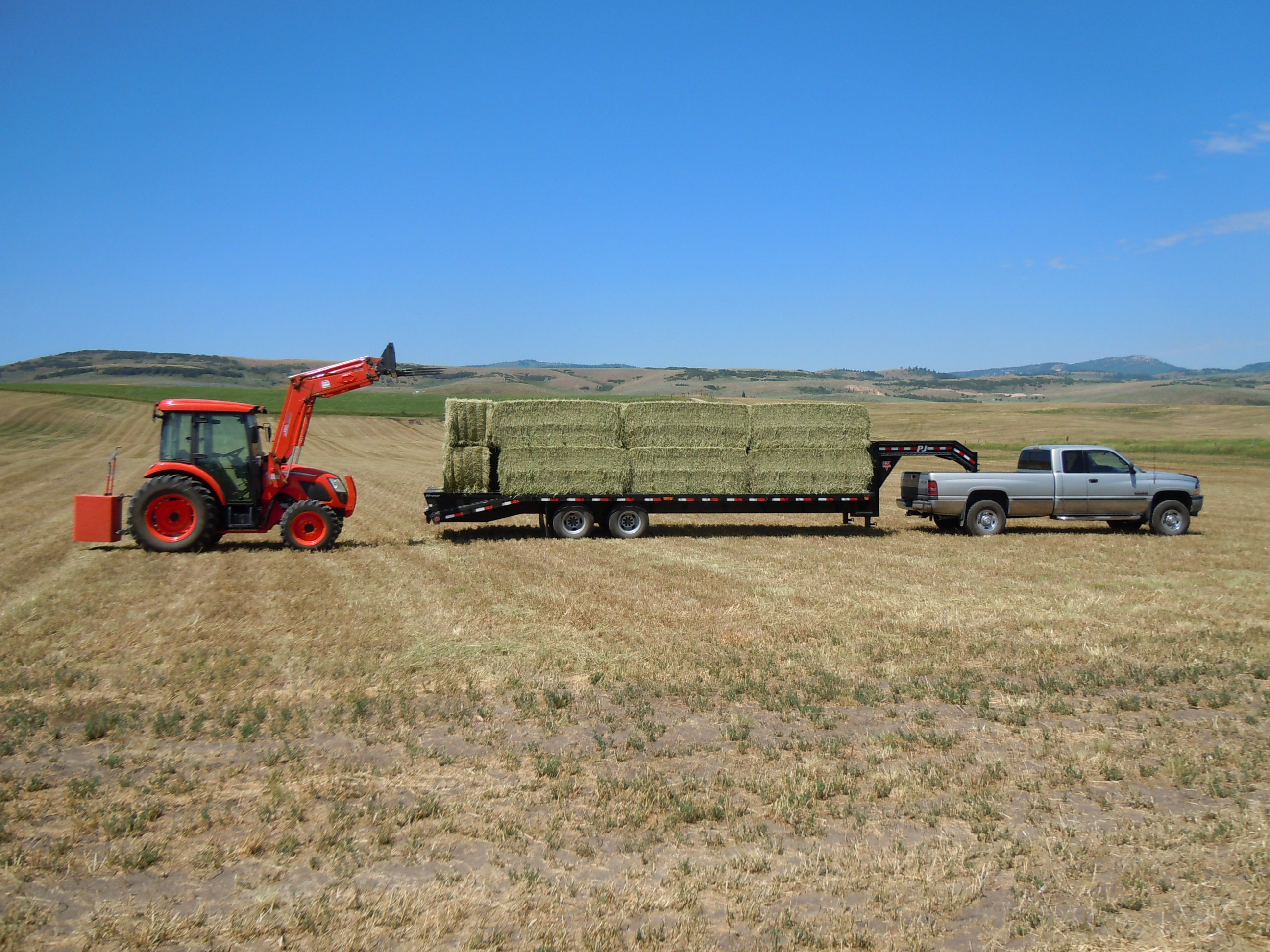

Here is the obligatory tractor picture.:laughing:

Cat Fever, lovely looking countryside. Very happy with my Kioti as well. Not as large as yours but I was extremely impressed with how much snow would push just with the loader last winter. Did not need to use snowblower.
