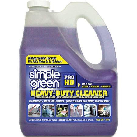

Try this. Home Depot keeps it.
I keep a quart spray bottle to spot spray oil, grease, chain saw bar oil, etc.
