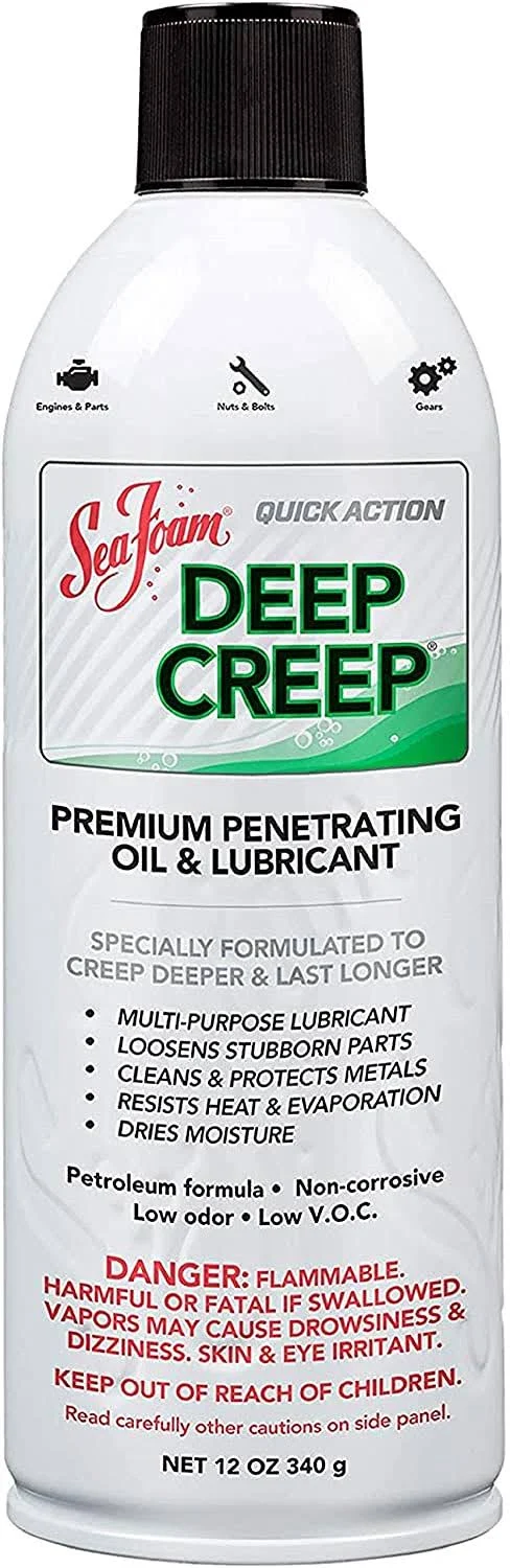

Good stuff, eh? I've never used anything with the words sea and foam on it thus far. Maybe time to end the spell.
   / Remove brush guard bolts-Kioti ck2610 (actually bobcat 2025)? #14
I've seen it at professional mechanic shops several times and my buddy recommends it. Just remember to let it sit for a while. The longer the better. Up to overnight.
You gotta be careful with an impact, they'll round the edges off the bolt/nut sometimes and then -- Well, then you're kinda screwed. And not in a good way :)
If you have to use heat, try a heat gun. If you care about your paint that much. I don't. Mine's not even out of warranty yet and it's not in bad shape - at all - but....... It's a tractor. I used Chevy Engine Orange (some say it's red but it's red-orange or orange-red. whatev) when I buggered up a couple places while installing my brush guard. I used it on my Brush Guard and it matched almost perfectly. I got tired of looking at the orange and re-painted it black. Should have done that in the first place.

Thanks Eric. Forgot, my son had a pneumatic-we walked em off today👍.
