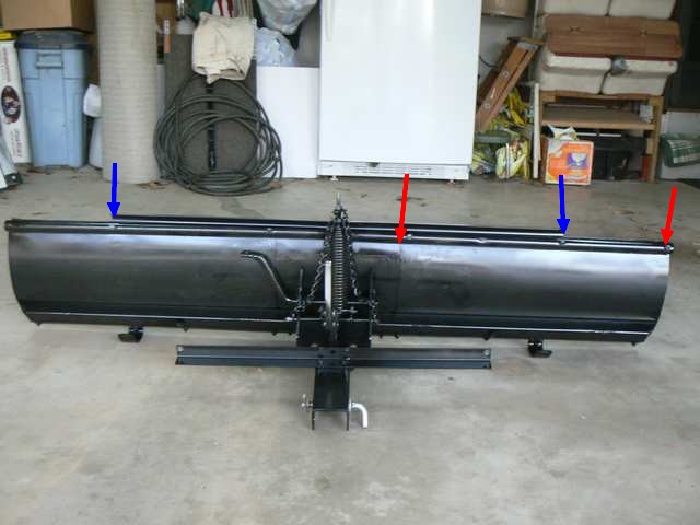

When I widened my old riding mower plow to work with my BX I used a couple of pieces cut from the inner tank of a 50 gal water heater. I added about 10 inches on each side. The curve of the tank was almost a perfect match for the plow. You might need 2 or three pieces stacked to match the thickness of your back blade.
Blue arrows show the original plow and red is the extension.

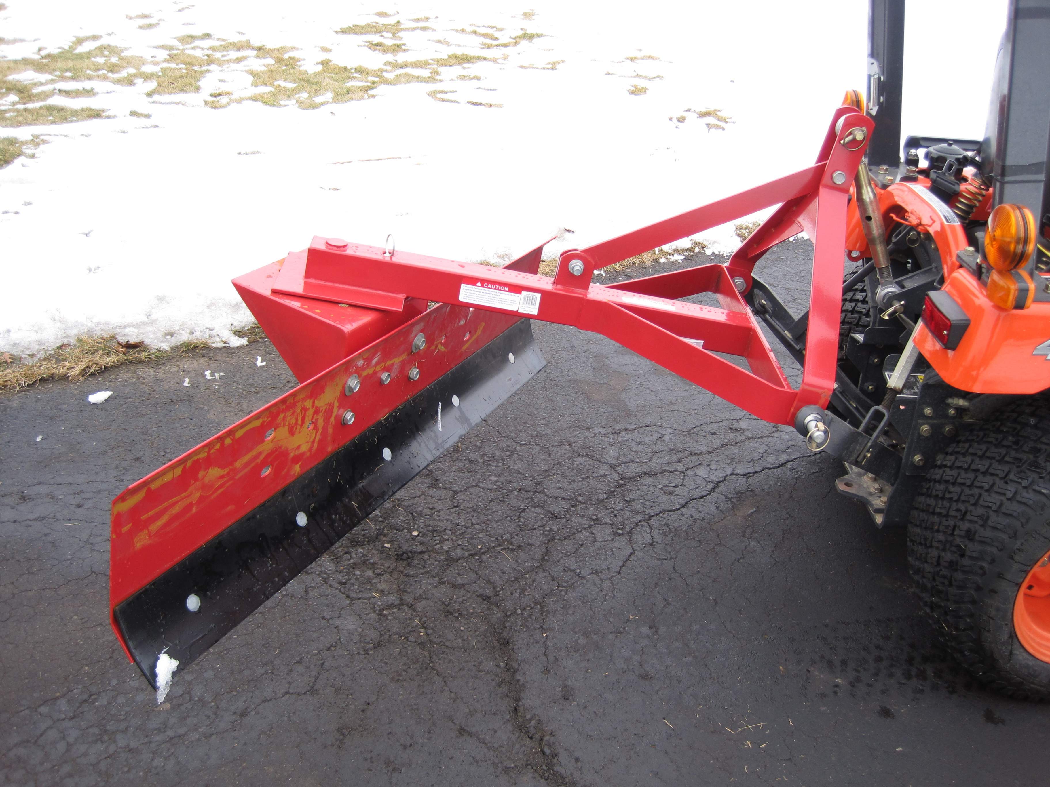

My back blade has multiple mounting holes in the blade (can kinda see them in the picture). Could just re-mount the blade to one side. Not sure if you have the same option....and you mentioned wanting to swap sides, that would be a pain this way.
I just got to put my new blade to it's first use here a few days ago with about a 10" snowfall. Works sweet, but I was thinking the same thing about being able to knock the snow farther off to the side without driving in the snowbanks. I don't need to worry about moving anything side to side so I think I just may try re-mounting my blade to "stick out" more on one side. And no...I'm not worried about bending anything on the blade or 3pt.
Or, build a sleve (water heater tank is a great idea) with some mounting holes on each side of the blade and sleve....move at will.
Just some ideas...let us know what you come up with.
