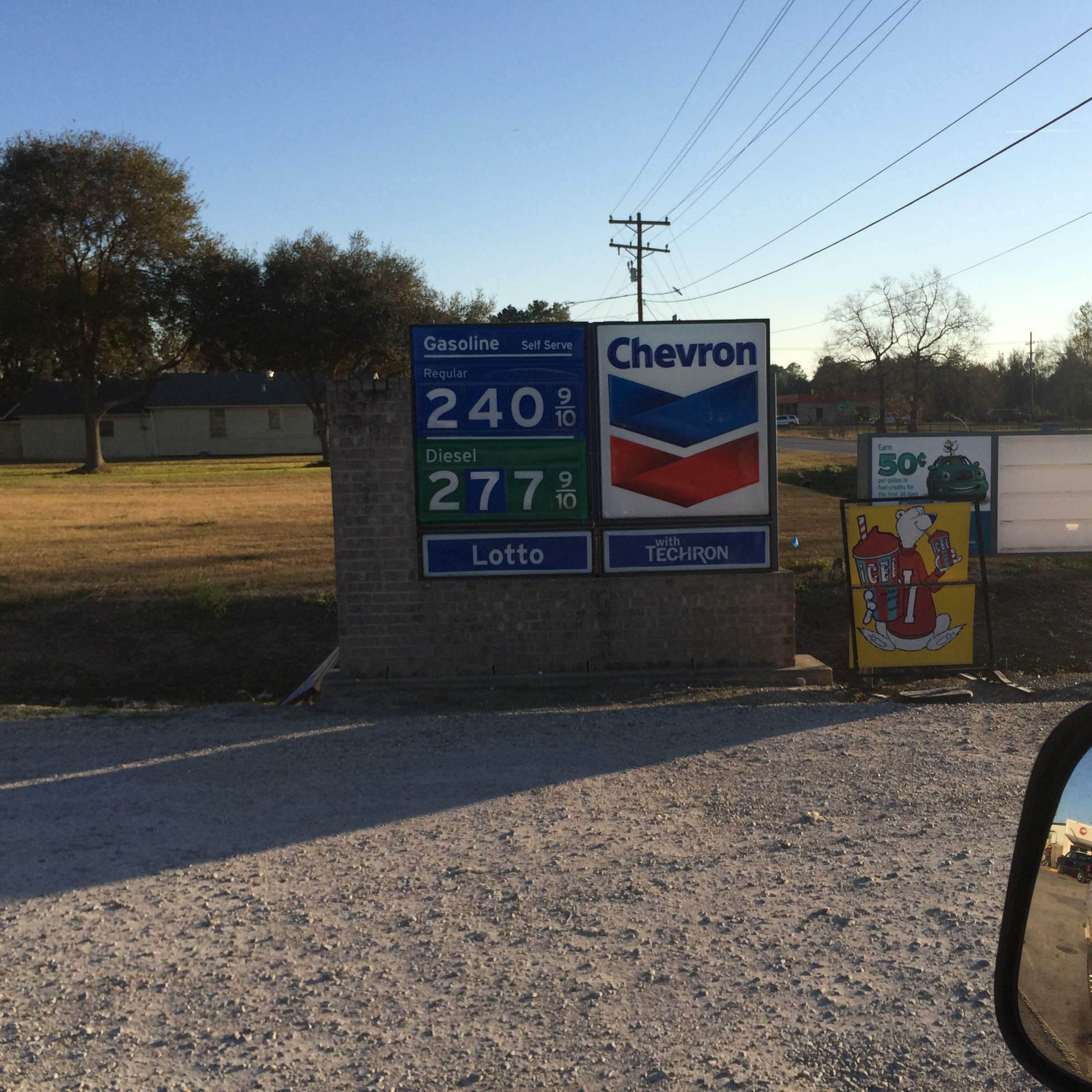

Just got my fuel invoice for the month and here are some numbers.
2012 Dodge cummins diesel 4wd - 2064 miles....average cost per mile for fuel = $0.27
2010 F250 - 5.4L gas 2wd - 1080 miles....average cost per mile for fuel = $0.22
This picture was taken about a week ago, and you can see the difference between gas and diesel at this store is only $0.37
   / Reminder - Cost of Ownership of Gas vs Diesel #137
I'm curious, are the trucks driven the same, same traffic, any trailers etc?
   / Reminder - Cost of Ownership of Gas vs Diesel #138
They are similar, but you can never be exactly the same. The Dodge pulls a trailer more, but also has more 'highway' miles. The Ford pulls a trailer less, but also has more 'city' driving.
