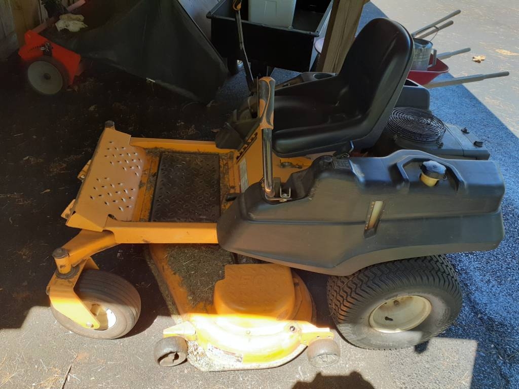

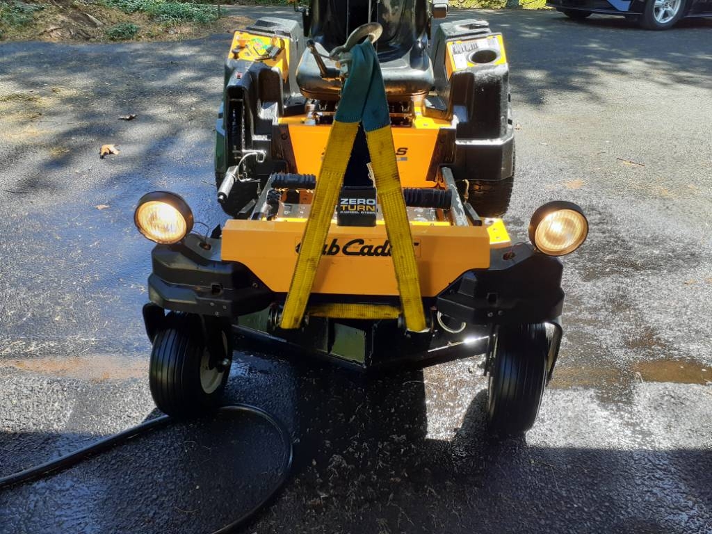

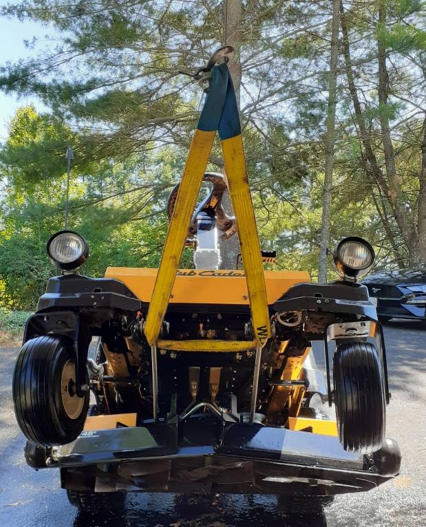

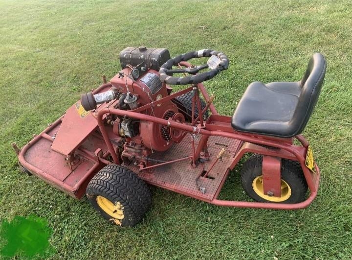

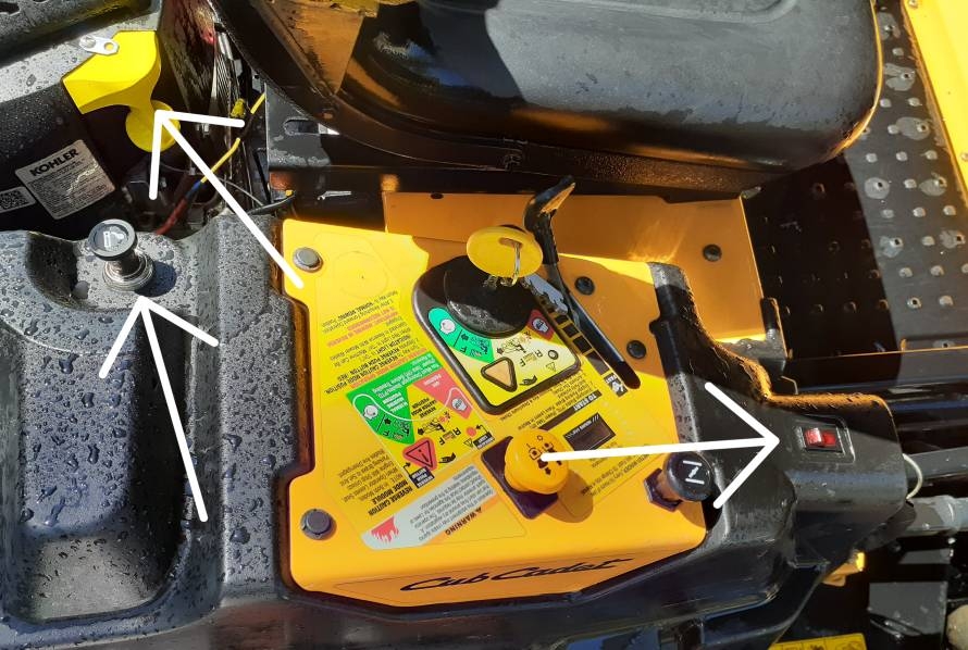

I need to bring home my Grandfather's Yazoo he bought in 1970. It's a zero turn and cuts before tires run over it. I just washed the Z Force for the first time . Arrows point to 3 changes I made, lights, cigarette lighter and hold down for oil dipstick. Sometimes cutting under trees a limb would flip it up and I'd get sprayed with oil!
I did have one problem. Sometimes cutting along and deck would be floating. Turns out the adjustment lever pin was slightly worn enough to disengage.
I'll report back later after I cut.

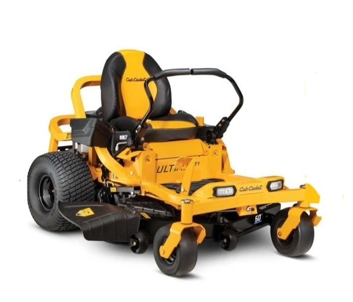

If I had to buy one today this is probably what I'd get. It already has lights (I added mine), I like the deck, probably has zerk fittings on spindles. $3,299View attachment 865426
Looks exactly like the one I have. Kawasaki motor that runs great after roughly 2 years of use. Only complaints I have are: no hour meter and non greaseable spindles (one is starting to make a little noise this year). It does cut well, and handles hills better than expected.
