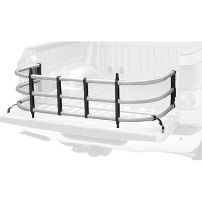

We got on a deer lease an hour and a half away and I face a dilemma of carrying a few coolers and the 4-wheeler in the bed of the truck. We use the ATV daily here so I can't leave it up there. I have a 1/2 ton GMC crew cab Z71 and a Suzuki 400 Eiger. The ATV rear tires sit right on the edge of the bed between the bed and the tailgate. I can't use a normal hitch packer because the tailgate has to be down, or removed.
I'm looking to build something that will come up level to the tailgate to be able to put 1/2 or some of the coolers on between that and the tailgate. It would be possibly a combination of:
Carry-On Trailer Heavy-Duty Hitch Packer, 20 in. x 60 in. - 0189155 | Tractor Supply Company
and:
Thule Extend A Truck-SUV-Car Canoe Kayak Lumber Rack on eBay!
Anyone ever done anything or built anything similar? I have a 12' tandem axle trailer with ramp, but prefer not to have to drag that down there all the time.

You might also consider something like this...
You could take the concept a little further and extend beyond the tailgate if you needed more room to fit coolers. This option keeps your tailgate on, brings the load up to the level you want, and uses some of the tailgate space to keep your butt end from hanging out as far.
