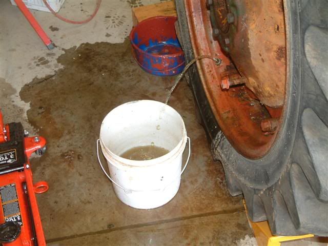

I have a rear tire flat on my Kubota M 6800 and it is loaded. My dealer loads the tires with antifreeze not CaCl. I am trying to decide if I should have my dealer come out and pick up wheel and repair it (I have no idea what he would charge, he's closed today) Or I can remove the wheel, slide it onto a trailer (yeah, I know it will be unbelievably heavy) and take it to a local tire shop where they will fix it for free (he owes me a favor) But he can not load the tire, so I will have to do that myself. Or third option, trailer the tractor 20 miles to my dealer. If I load the tire I will need to buy the stem/hose adapter from tractor supply. Any advice or tips??? I am leaning towards doing it myself (with several friends to help roll the tire) How much antifreeze and what type should I use. Only gets in teens occasionally here. And yes, I know there are opinions on the use of antifreeze, but since that's what's in the other wheel, that is what I plan to use. I do not have a loader or any way to lift it, but I have moved a rear tire in my truck before (before liquid loading) and had no trouble sliding it off and rolling it in place. What does a dealer usually charge to pick up a wheel, fix it and reinstall it?

Happy ending!! I drained the fluid out of the tire, jacked it up and placed jack stands under the tractor. Two of us rolled it off and with the help of a 4-wheeler, slid it up on a landscape trailer. Had a tire repair shop replace the tube and they loaded it into my pickup. Litterally rolled it off the back of the truck and let it fall. Then we rolled it back to the tractor. The hardest part was aligning the lugs. It would be nice to have some sort of rollers to place it on so it could be rotated easily. Finally we got it in place. Now I just need to load it with fluid. Nice thing is it was free.

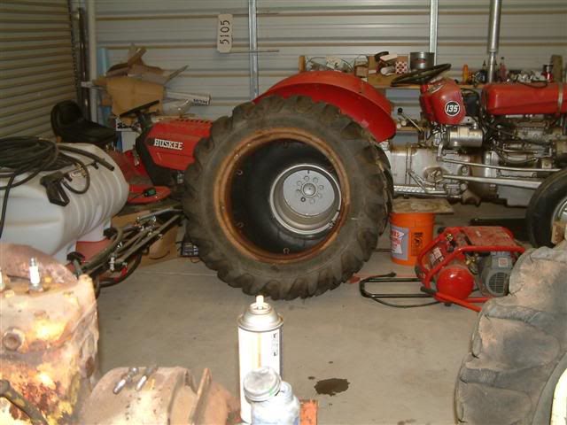

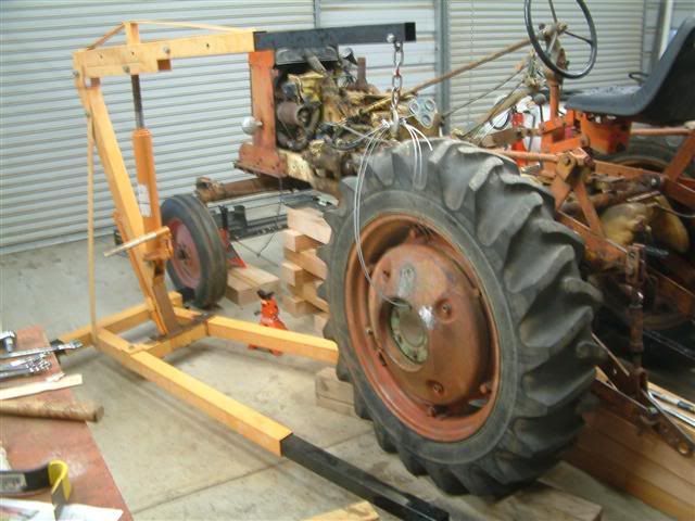

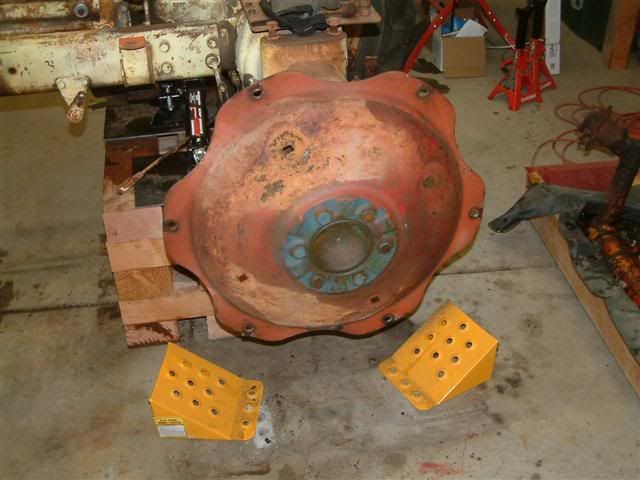

A few weeks ago I had to remove the 11.2-28 rears on the 1951 Minneapolis Moline BF tractor that I'm restoring. It had both wheel weights and were water filled (don't need antifreeze around here). Used the engine hoist to remove the weights.
I drained about 11 gal out of each tire. I suspect there's a gallon or two still in the tire
Then had to cut the heads off the six thoroughly rusted 5/8x4" fine thread bolts holding the rim onto the center part of the wheel.
Even with the outer rim only, those tires were a real handful to move across the shop. They're leaning on the rear tire of the 1964 MF-135 diesel which has 16" dia rims on the rear.
What size are the rears on your Bota? TractorData has them at 7.50-16. That doesn't sound right for a 70 hp (engine) tractor.
