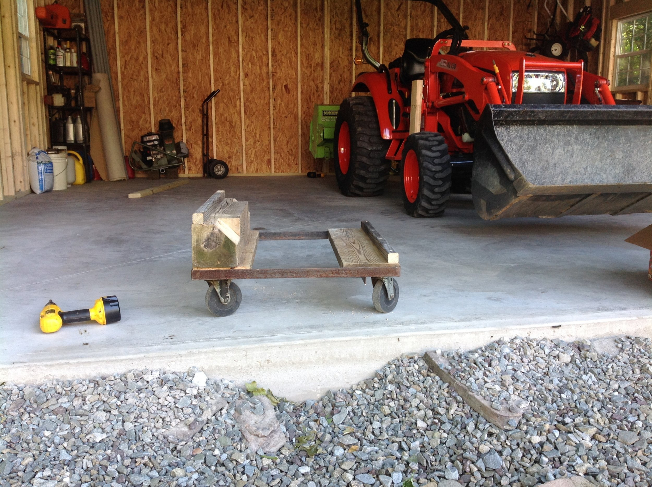

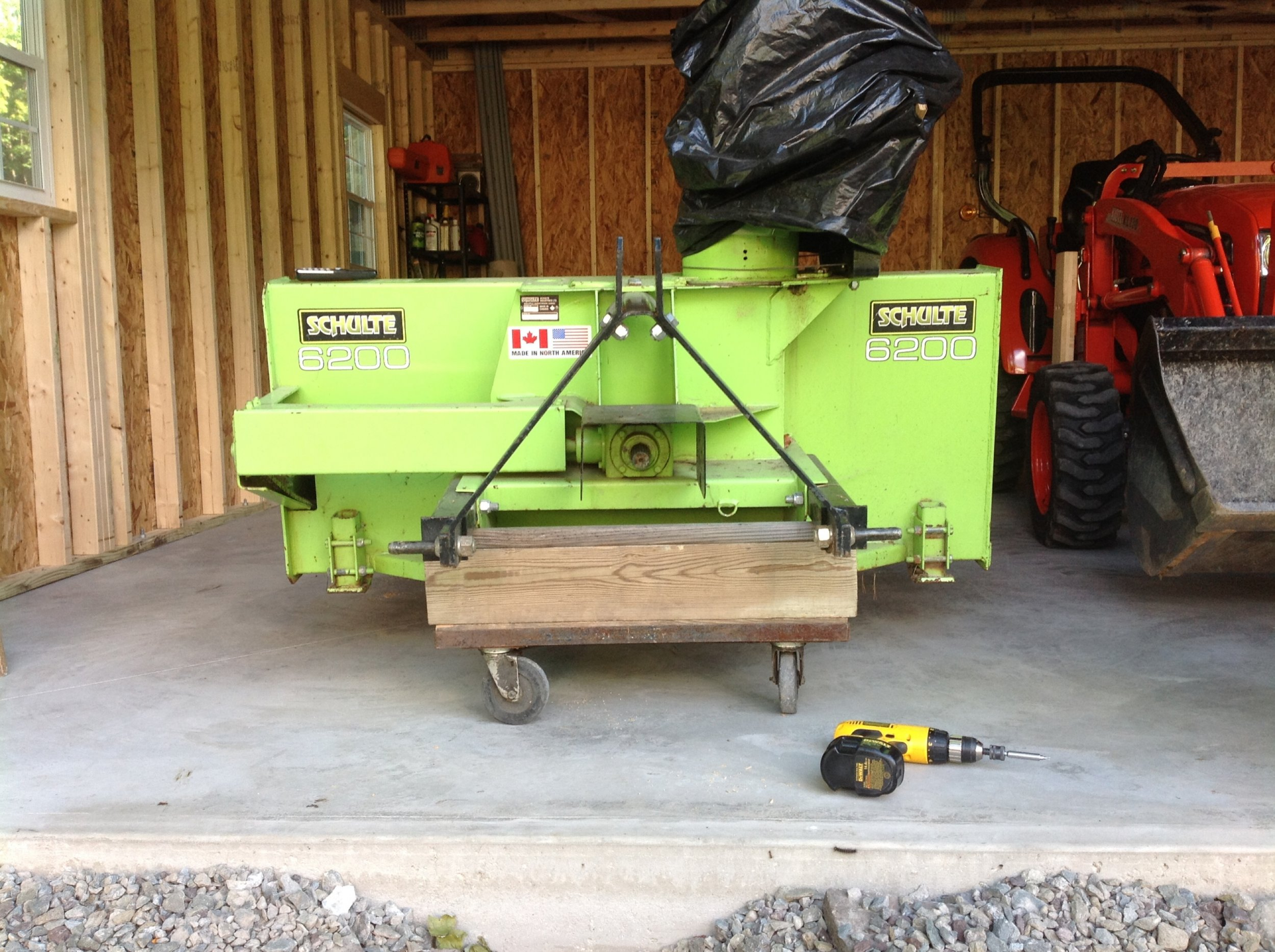

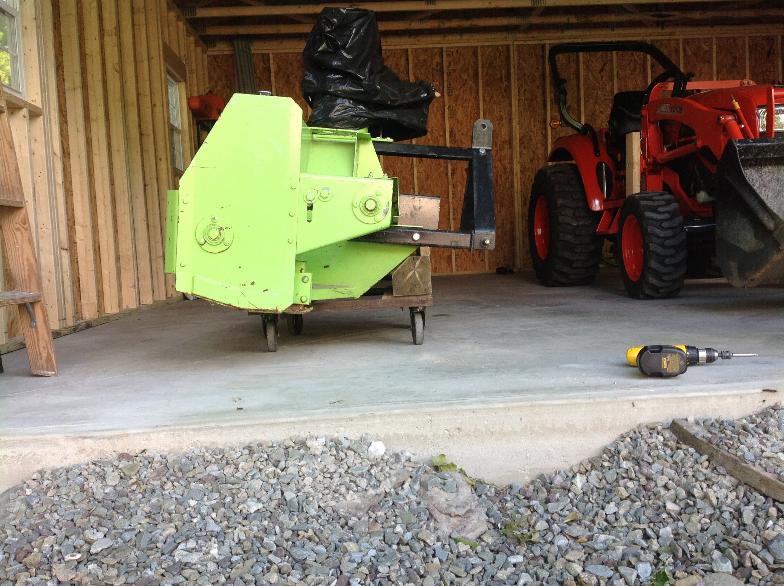

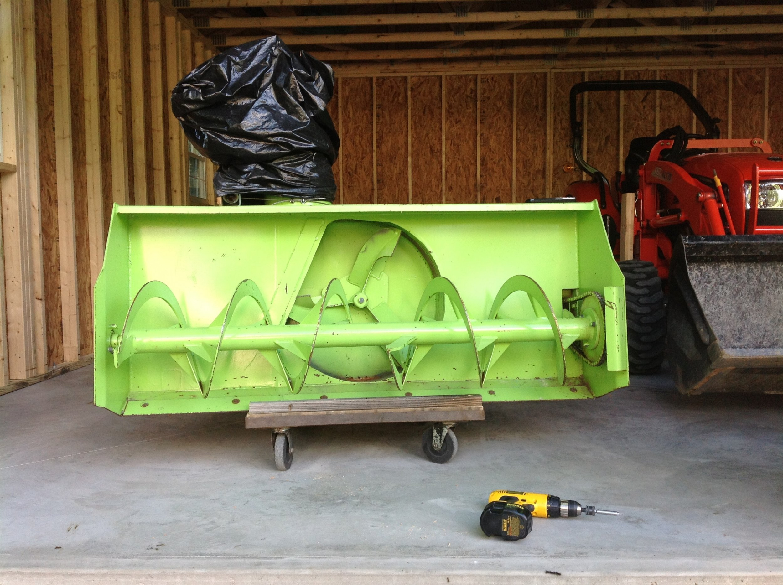

You did a Very nice job building that dolly !
I’m kinda surprised how similar your Schulte blower is to my MK Martin blower, how do you like the shoe setup ? that’s about the only thing I wish was somehow improved on mine. Once the ground is well frozen the shoes work fine.

Thanks. The skid shoes are not that great. I run the blower with the top link shortened like it sits in pic 2, then lengthen it up once the base is frozen.
Planning to make some larger rectangular shoes and orientating them parallel with the cutting edge to maximize the footprint when tipped back. Otherwise a great blower.
   / Rear snowblower storage advice ? #24
Here is a cradle I made out of a found dolly a few years ago. Blower weighs a little over 400 lbs and with a swepted floor you can roll it around with one hand. With the blower still on the tractor roll the dolly under it and add what ever you need to cradle the blower.
I screwed lumber to 2 dollies for my blower, and have been using screw type jack stands to hold it up on the hitch side. It never occurred to me to use permanently attached lumber. That will be a project for next season!

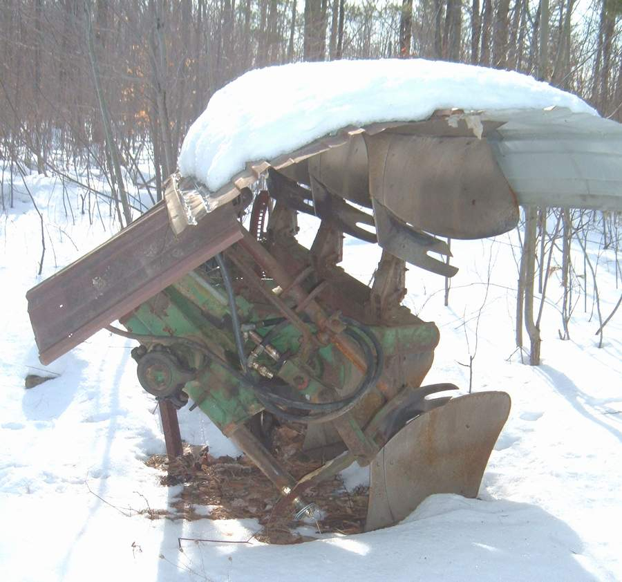

   / Rear snowblower storage advice ? #28
Made a new cover for the fert deal the other day, one piece.

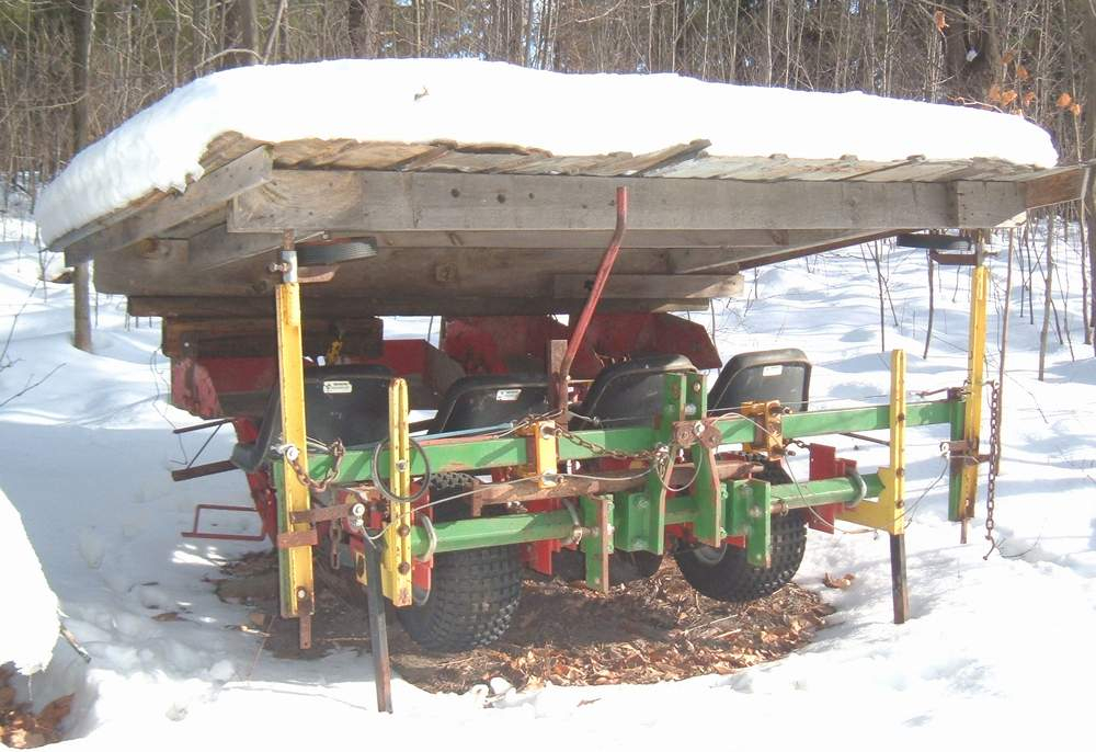

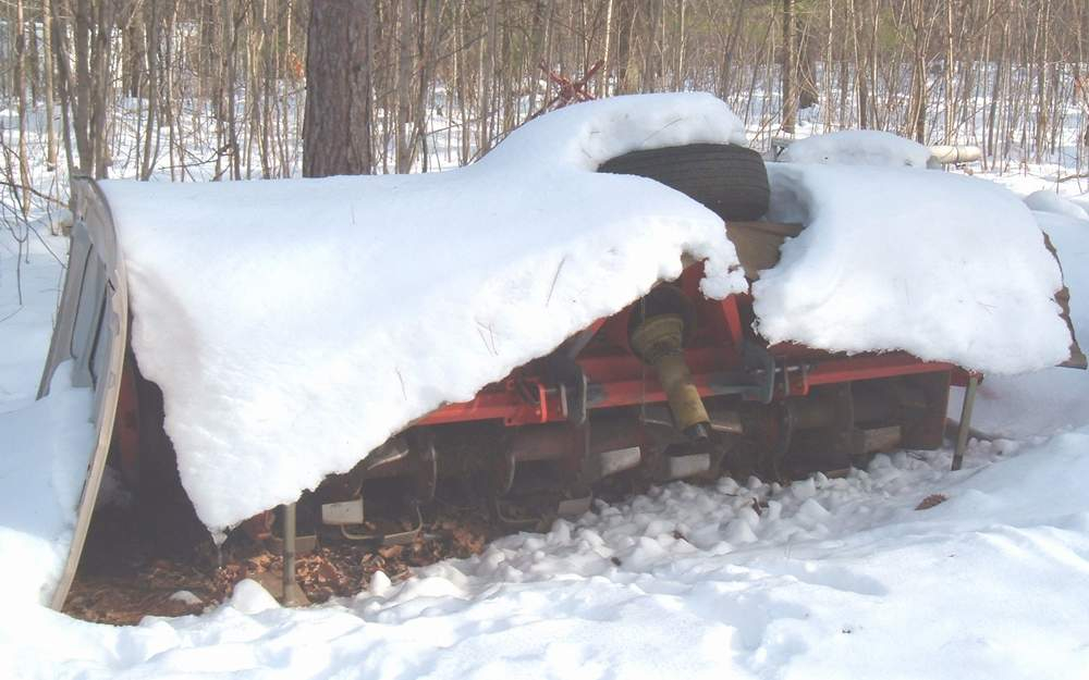

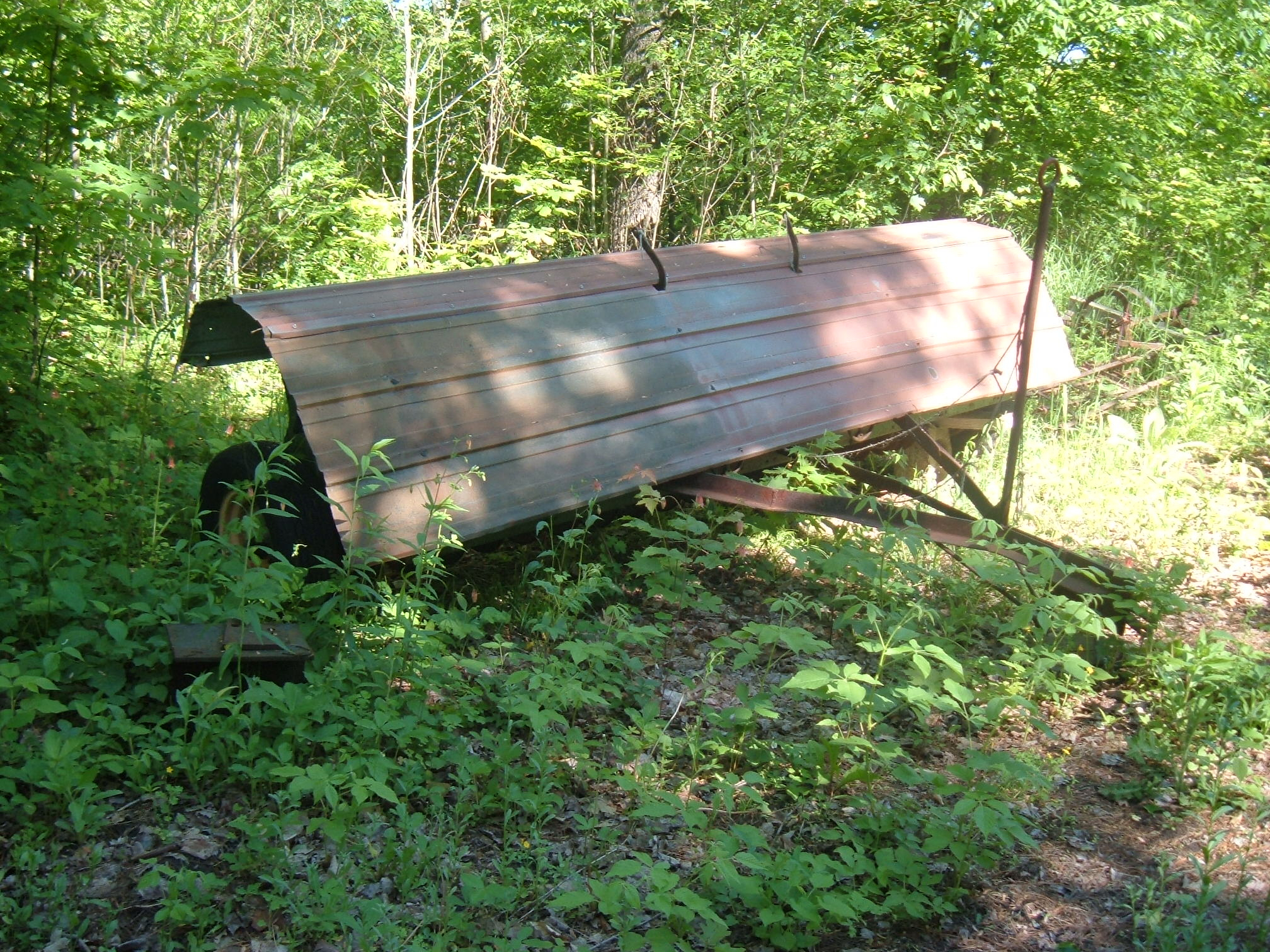

   / Rear snowblower storage advice ? #29
Some of these use part of a day a year, some old, dont want to work around it all in storage.
