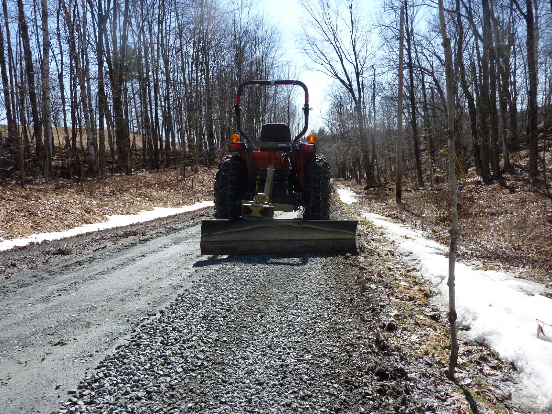

I have a 9" blade. You can clearly see that I was not cutting 9' wide. You have top & tilt, (easy control) I would go with a 7' blade. ;)

No!
Your assumptions are not correct!
You can make a crown with a 7', 8', or 9' blade, you just need to set the proper tilt.
An offset blade would be very desirable for what you want to do!
Forming the crown is all about technique.
You might try to find a video showing how a road/highway/construction grader works.

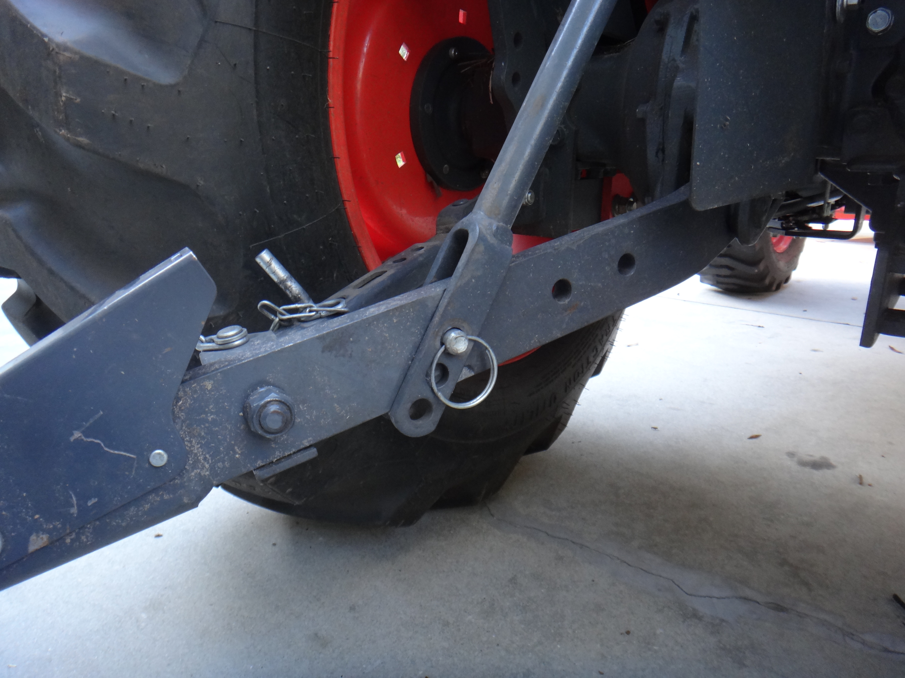

Better to produce tilt by moving Lower Link stirrup pin adjustment from default upper pin position, to one of two lower pin positions on the left side, lowering left side of blade, raising right side relatively. Remember: Lower hole = lower implement.
(Small tractors have only two pin holes in the stirrup, some Category Two tractors have four pin holes in the stirrup.)
Usually you obtain a greater degree of manual adjustment making the pin adjustment(s) and the two Lifting Rods share the load more. You can fine tune tilt by screwing the right Lifting Rod adjuster in or out.
Make the pin adjustment before mounting the implement. Clean and grease the pin(s) for easier insertion and removal.
When using a Three Point Hitch mounted Cultivator or Box Blade, and perhaps rear blade oriented perpendicular, sometimes it can be helpful to lower right and left pin adjustments, obtaining more bite from the implement.
And, YES, hydraulic Top Link and right Lifting Rod adjustment from Fit Rite is much superior. With T'nT installed you have hydraulic control on the right Lifting Rod and manual adjustment on the left Lifting Rod plus hydraulic control of Top Link length.

Very nice. Having a hydraulically operated blade DOES make a difference...makes your tractor just like the county's road maintainers (almost) with their hydraulically operated blades. Grin
