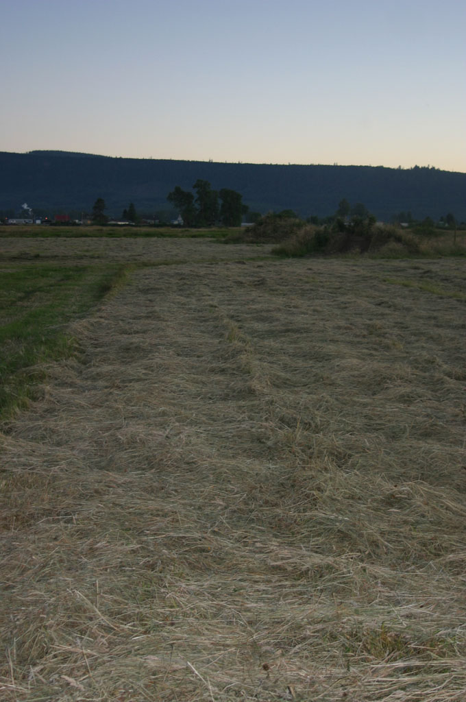

Tedding....
Basically, this fluffs-up the hay, inverts some of it and un-bunches it so that it can dry more uniformly. All the research I've read says it actually does not make the hay dry faster, but it does help it dry uniformly. Regardless, after you have mowed, the grass is in long parallel lines in the direction you cut. Once you have tedded, it's horizontal to the way you've mowed.
It's really hard to see in the photo, but I'll give it a try.
One other note, always ted in the morning while dew is still on the hay, or after dusk. Doing it during the heat of the day will break leaves off clovers, reducing the forgage's nutrition.

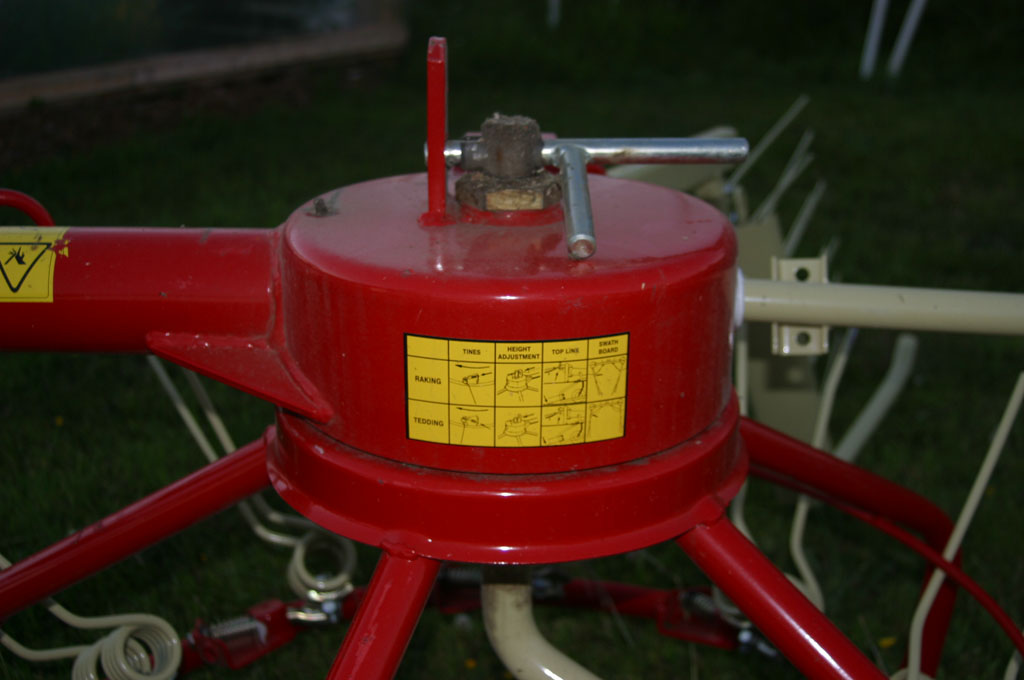

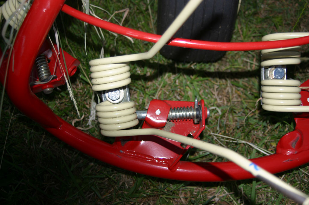

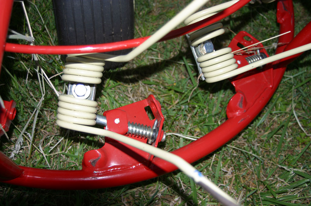

Basic instructions on raker / tedders...
Many rakes today both windrow and tedd. This is how mine adjusts.
The picture shows the diagram on the rake along with the top adjustment, which raises & lowers the wheels in relation to the rake. As it raises and lowers, it also tilts the rotating rakes more or less horizontal. You also need to adjust your top link so that the tines run about 1" above the ground (or just above the stubble). The top adjustment is in the tedding position in the photo.
The tines along the rake adjust as well, depending on your mode. The first shows the tedding mode, the second the raking (windrowing) mode. The tines just pull out and snap back into the different hole.

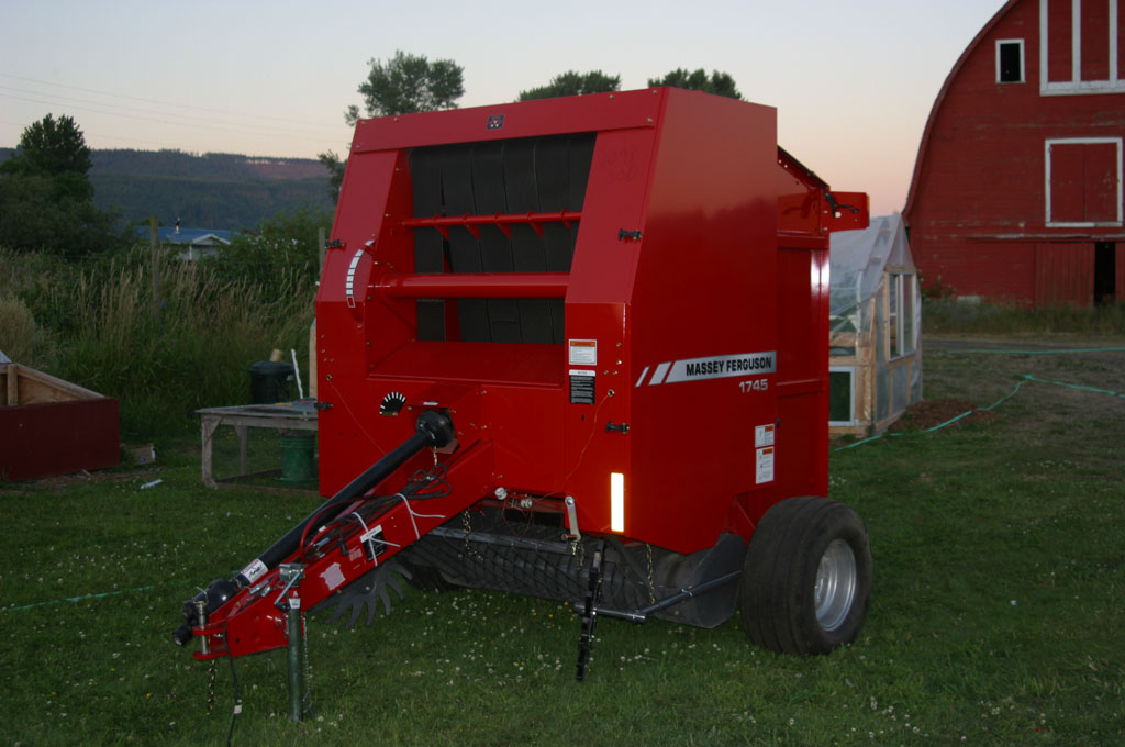

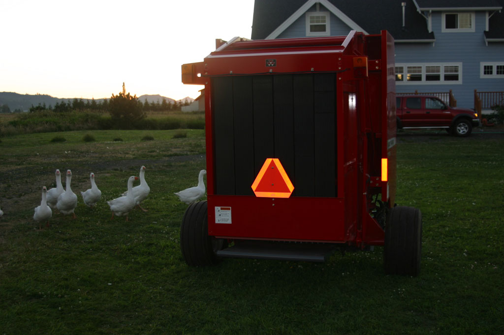

Finally, the baler has arrived. I drug it home from Salem on the back of my Toyota Tacoma (V6 power, baby). It took a long long time to get home....
Oh and regarding discs... a neighbor has let me 'borrow' his 10' wide offset discs, because there was no way in **** he thought my tractor would pull them. It turns out, I can pull them with no problem. I may get a free set of discs out of this if I keep shaming him over it.

Sharp lookin baler, how'd it go?
   / 'Real Farming' with a CUT #17
I'm glad to see your land is flat, that is a lot of baler for a little tractor. The rake tedder you have is based on the decades old PZ-Haybob design. Very solid and reliable but uses a lot of teeth compared to other designs. I didn't notice on yours but some of the new teeth for haybobs have a tie to hold them in place after they break so they don't get left in the field.
Those disc mowers are reliable things and do a great job in tough mowing conditions. With more hp you could probably mow at 10 mph.
Have fun and make sure your hay is dry before baling if you are storing inside!
