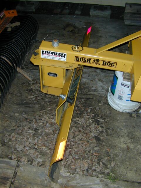

Oh, I agree Jim!, I have had much trouble with mine too and small bites is the only way unless you rip it first. I'd always rather pull a horizontal blade. If I was in Scrounger's position though, i.e., no BB, I would really try to make my RB work before buying a BB especially if it's a one-job situation. Also, please note that I offset the top of my cutting edge frame 2" so as to make the cutting edge less aggressive ... really helped ... in addition to extending the top link all the way!
Cheers!
