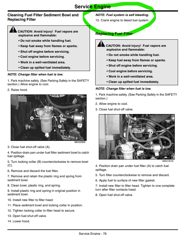

Your John Deere is self priming. Just keep trying to start it as it may run/stop/run/stop several times before it stays running. It's a Yanmar engine
At least that is what I've done twice now that it ran out of fuel. My issue (at least my excuse) is the fuel gauge shows almost 1/4 tank when in fact it is on empty.
Should say that in your manual.

If one elects to loosen injector line at injector be sure to keep fingers clear from spraying diesel fuel. Diesel injected under skin will require serious medical attention. I agree with beenthere that one should check manual for correct instructions. Photo from operators manual below states model 3320 is self bleeding

Everything is self bleeding if you crank for Long enough...
Anyway, watch a video or two before doing the bleeding process, it's not hard, or that messy, and not dangerous, but you only loosen the line until you get air then diesel coming out, that's part of why a 2nd guy/gal is useful; you don't want to completely remove the line/nut. And it's all better understood visually than with text.
Once you are running again, it might stutter and bog for a minute or two; but if it runs funny for longer than that, you likely need to replace filter, or drain a sediment or water separate bowl.

Bleeding at the injectors would be the last step and only if needed. First bleed to the fuel shut-off, then work your way to the injection pump. Up to this point, you can use gravity, the lift pump (key on), or a manual lever pump to bleed. Then, with fuel bled to the injection pump, IF it doesn't start, you may have to bleed the injectors.
