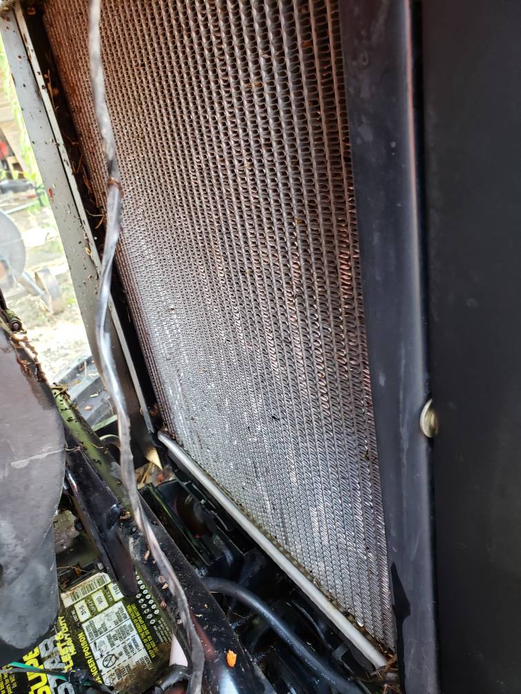

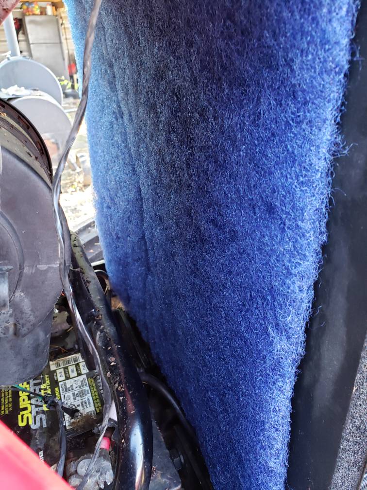

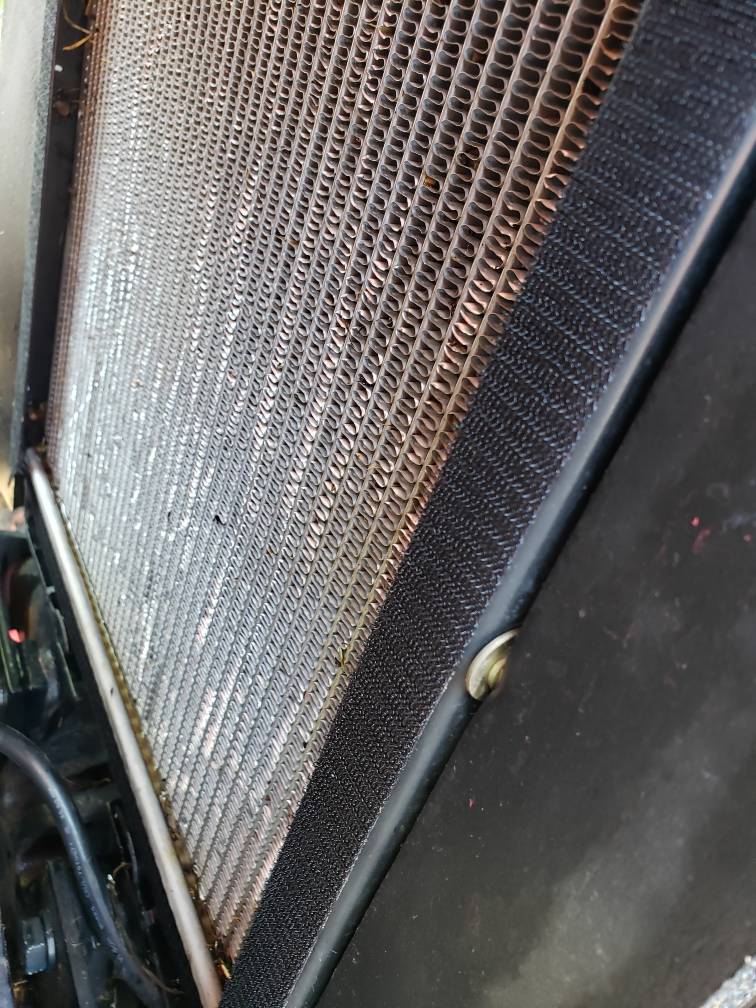

Here's what I did for my 4025.
I cleaned the radiator with the scrubbing bubbles bathroom cleaner, and then applied the velcro. When the filter gets dirty I just shake it off and reapply. 20190902_155459.jpeg20190902_160412.jpeg20190902_160507.jpeg20190902_160737.jpeg

It will restrict a little, that's why I made sure the radiator was clean and I plan on keeping it clean from here on out.
Ron, does it restrict ANY air flow?
If not, thats a good idea.
