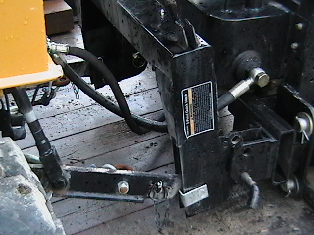

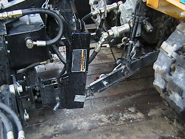

I use the HFT quick hitch on my dozer with a LW-6 BH, 1,000 lb. counterweight, and commercial scraper w/ scarifiers, and like Greg said, " the only problems I've had is hooking up to non-AGMA Standard attachments".

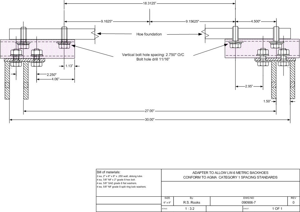

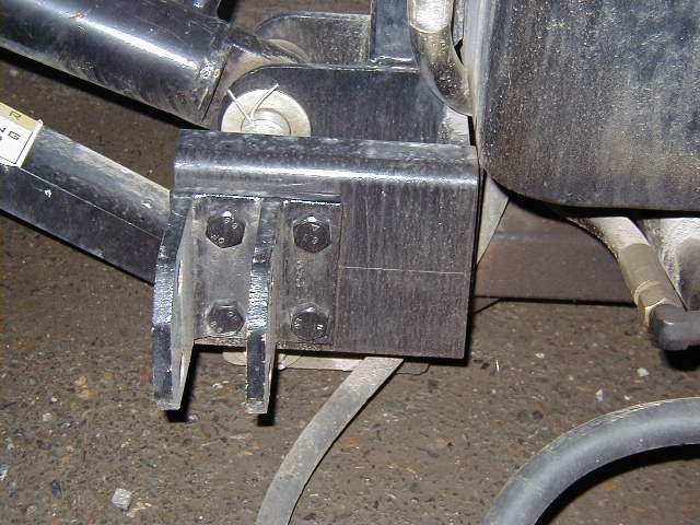

Correct me if I'm wrong, but I believe the AGMA standard for category 1 hitches is 27" inside face between the legs or 28-1/4" OC. I found that I had to "adjust" my legs about 1" total (1/2"/side) with a port-a-power to get the correct measurement, and I found it necessary to fabricate adapters to make the LW-6 BH compatible with the rest of the world. If anyone is interested, I can post the drawing and photos.
I'd love to see them, or even just a photo and description.

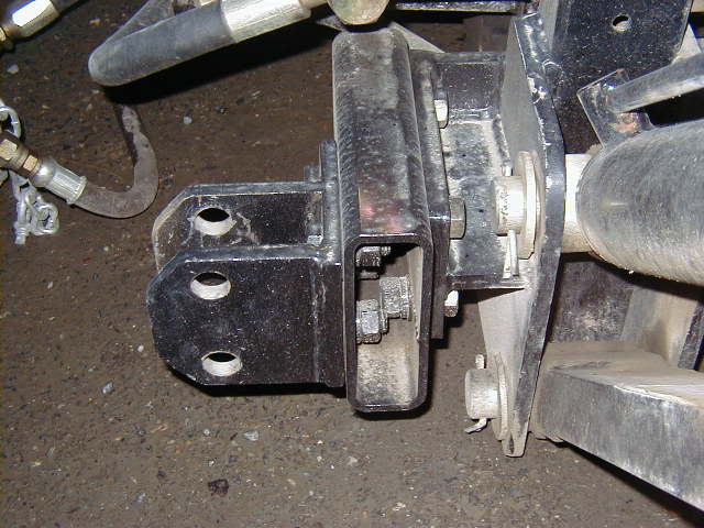

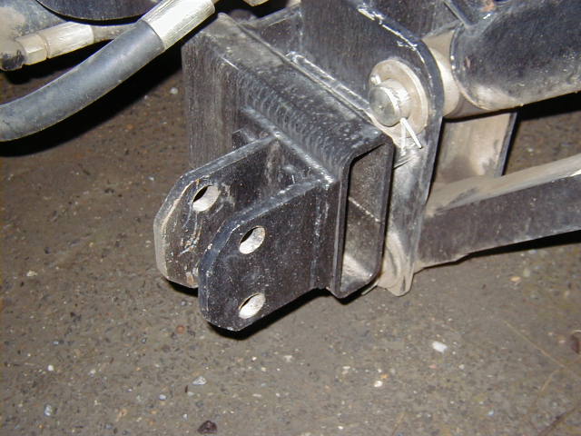

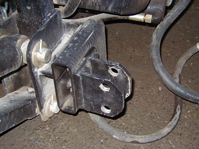

These adapters bring the inside hitch pin spacing on the LW-6 BH to match the AGMA standards to which the Quick Hitch was built.
