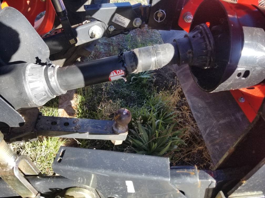

Good luck with your new toy! I think the PTO will just need less cut off if anything. The quick Hitch moves the implements further away from the tractor.
One thing to consider when using the PTO is clearance between the PTO shaft and a drawbar.
This picture shows what happens when the rototiller PTO shaft interferes with the hitch ball on the drawbar.

I remove the drawbar when using PTO, just to be sure I don't hit it.

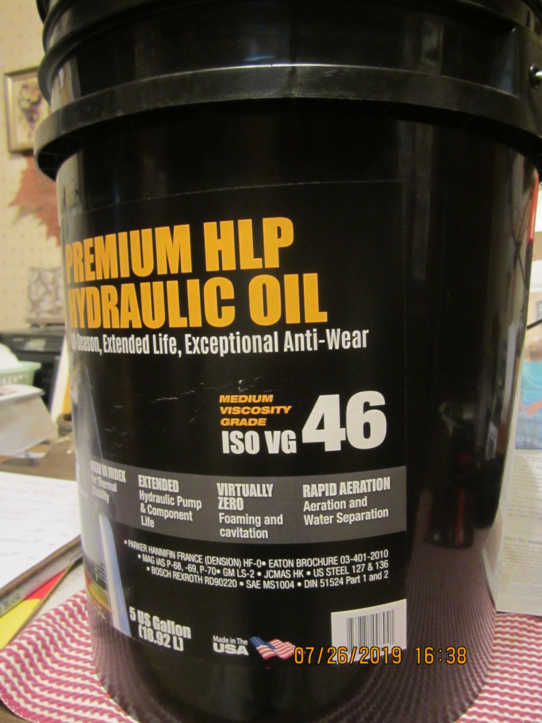

Here's what I put in myWC 68...running it on a 26 HP (19 at PTO) Kubota . The Woodland rep said my selection of a 5 gallon pail of ISO-46 was alright for my temperature range here in Kansas. That was July of 2019. BTW, I have put lots of hours on the machine with no issues chipping several varietys of tree limbs ( less than 6 inches) and even some shrubs. The ISO-46 was $75 at that time.

Incidentially, I had also texted one of our head mechanics at the job and posed the same question to him before I posted my last, he just responded a few minutes ago and basically said I would be wasting really good hyd fluid (and $$) if I used my Permatrans and suggested I just go buy a bucket of ISO 32 if that's what WM suggested.
He also said that while ISO 46 is indeed better for prolonged use at higher temps, he doesn't think I'll see any difference between the 2 unless I'm above 100° and working the heck out of the unit as ISO 32 will work fine into my temps ... and then added, BUT, if I were in Phoenix in July when it's 115° in the shade, then I should definitely use ISO 46, lol
