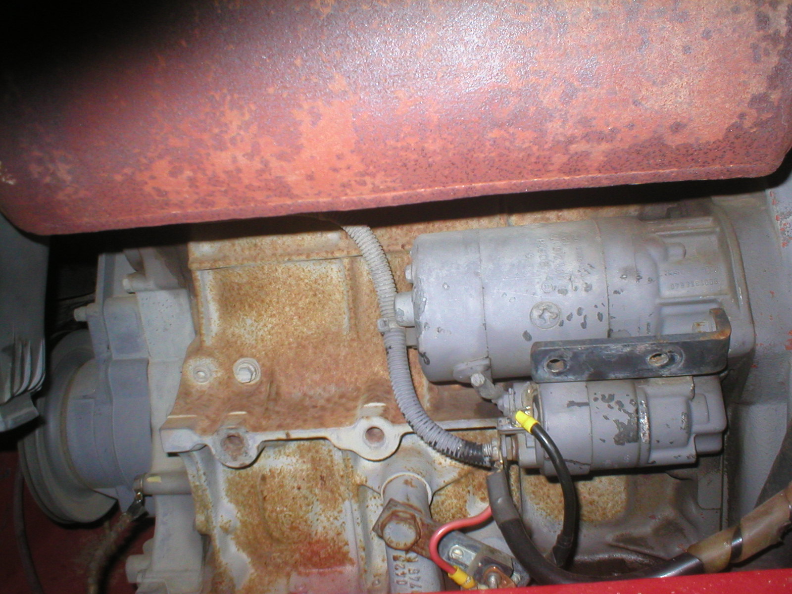

I am attaching a picture of the bracket I am talking about it is right beside the starter. Today I ran it for about 5 or 10 minutes the temp. gauge went up about half way and the fan did not kick on. 1 hour later I went to start it and nothing. The beeper comes on but when you turn key to the start position not even a click. I left it sit while I changed a tire and then tried it and it started right up.

Check the voltage to the starter solenoid when the key is in the start position. No voltage check key switch and wiring. Voltage at solenoid, something is probably up with the solenoid. Check the grounds.

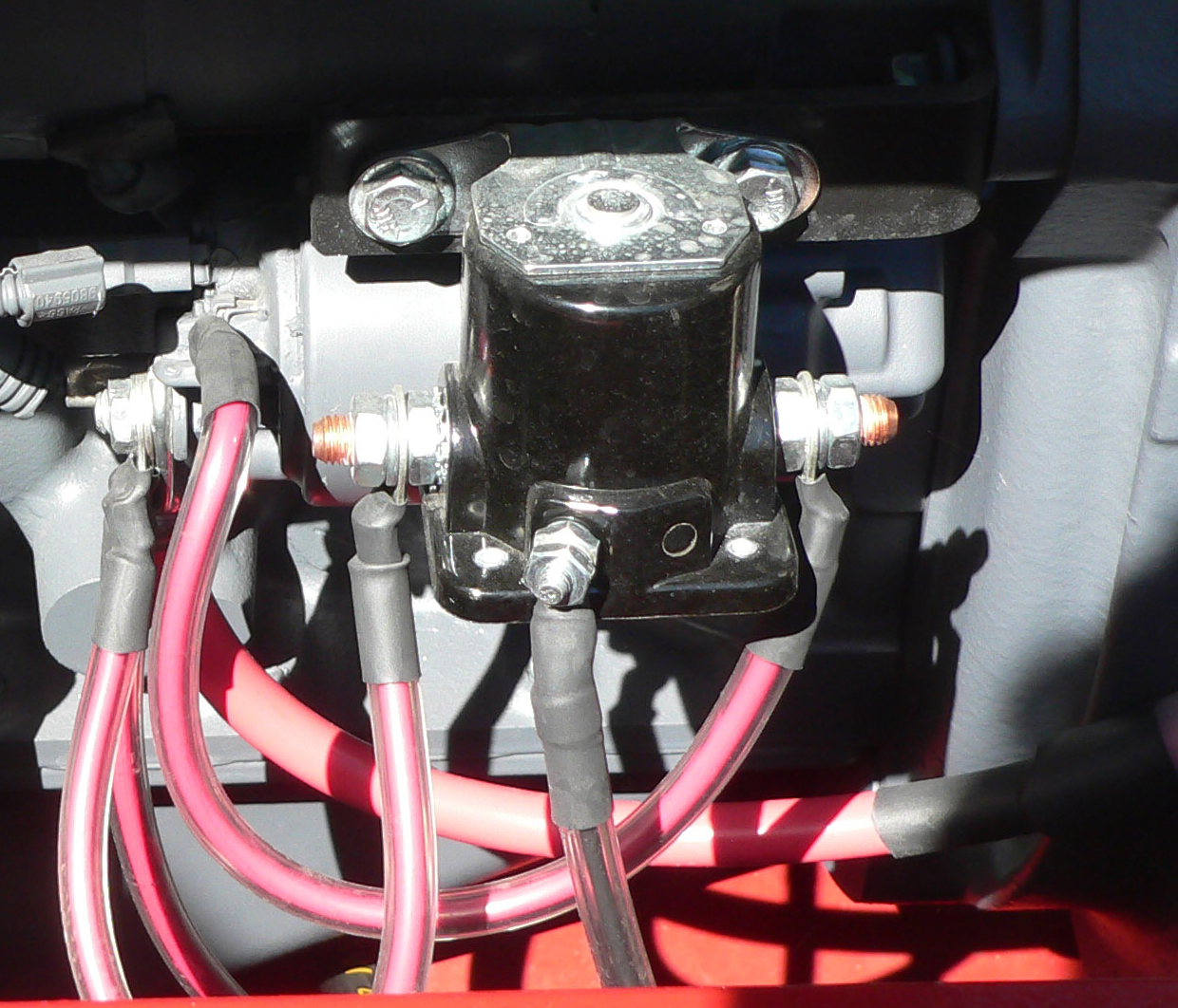

Dear Ernemats,
That is the bracket for the second starter solenoid. You should have a 1986(ish) Ford starter solenoid on that bracket. (See image below. The exact year is on a different post.) The lead from the ignition key goes to the second solenoid, which switches power on to the actual starter, which is pretty finicky about having enough voltage. When it gets hot, the rather circuitous routing of the starter solenoid wire can leave it at under 10V, with the problem that you are experiencing. With a little cooling off, the battery recovers, and the voltage is high enough to start the engine.
Of course, you can have the problem that even with the second solenoid, the voltage is too low, but that's another post. (I think Charlie Iliff and I are going through that at the moment. I think that the ignition switch may have too high a resistance in it.)
All the best,
Peter

Ernemats, I was looking at your picture again, and it almost looks to me as if you already have a second solenoid, but mounted in a different location. What is down below the starter in your photo, to the left?

Not sure, but looks like an auto-reset circuit breaker perhaps?
