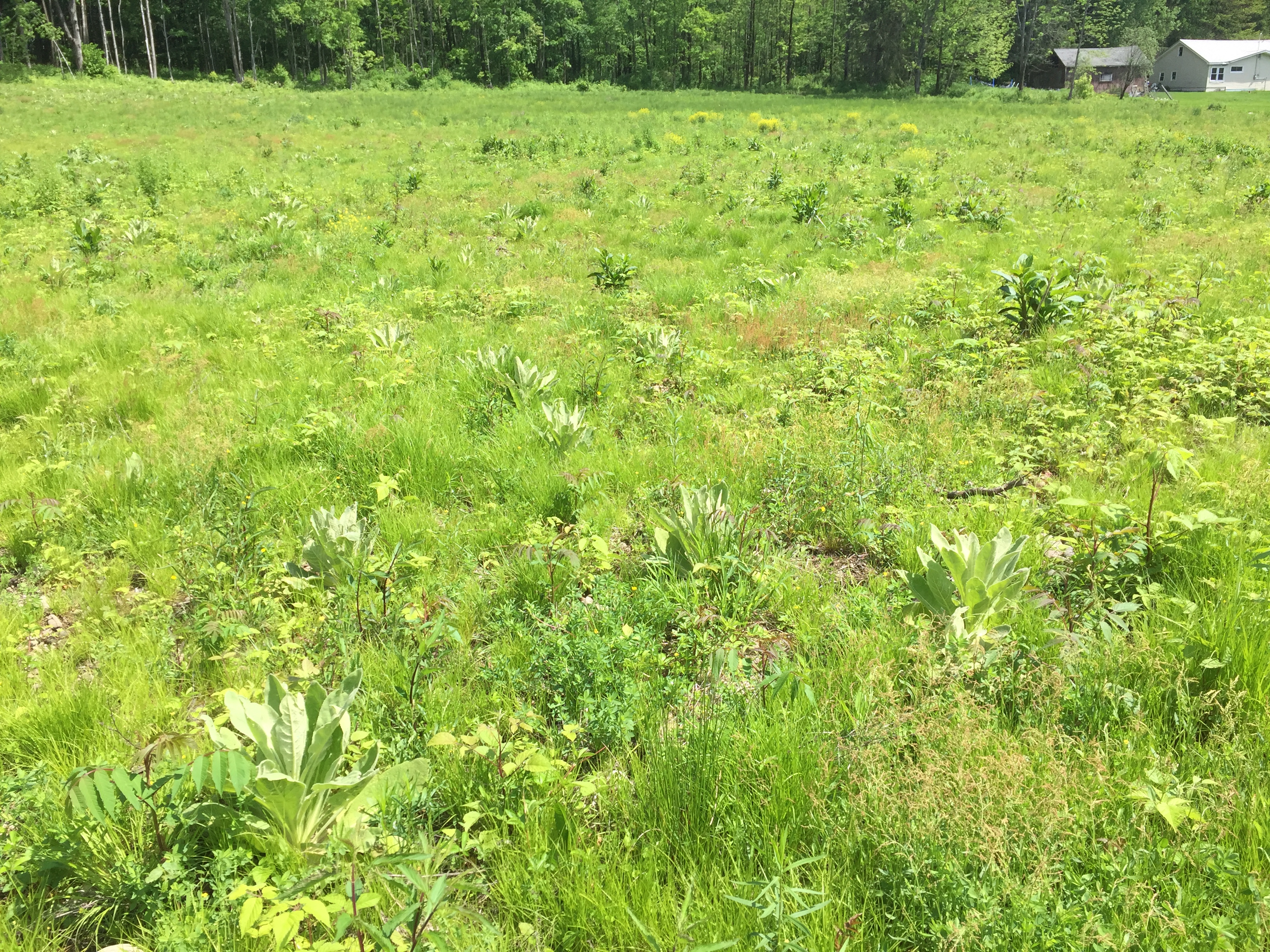

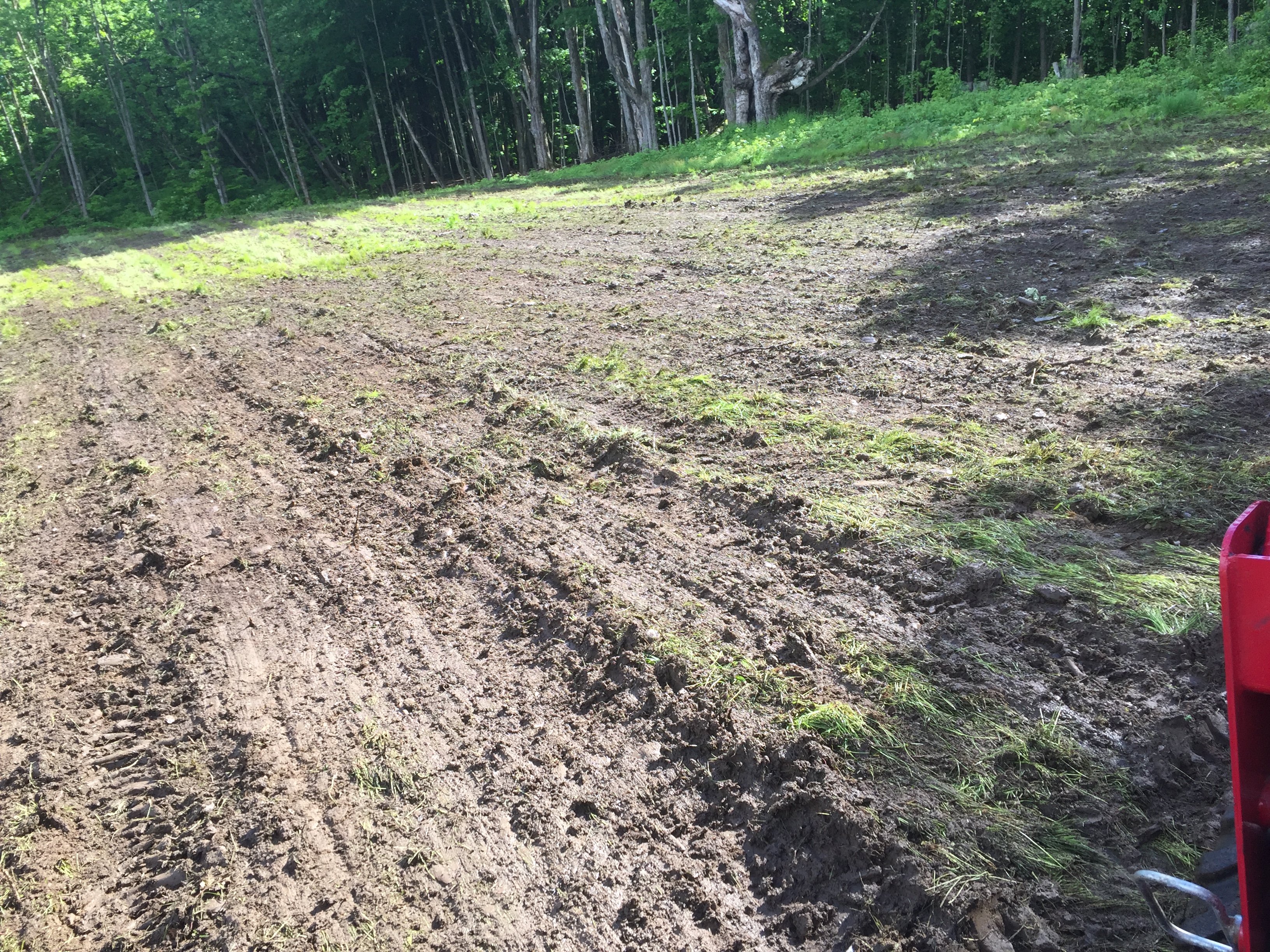

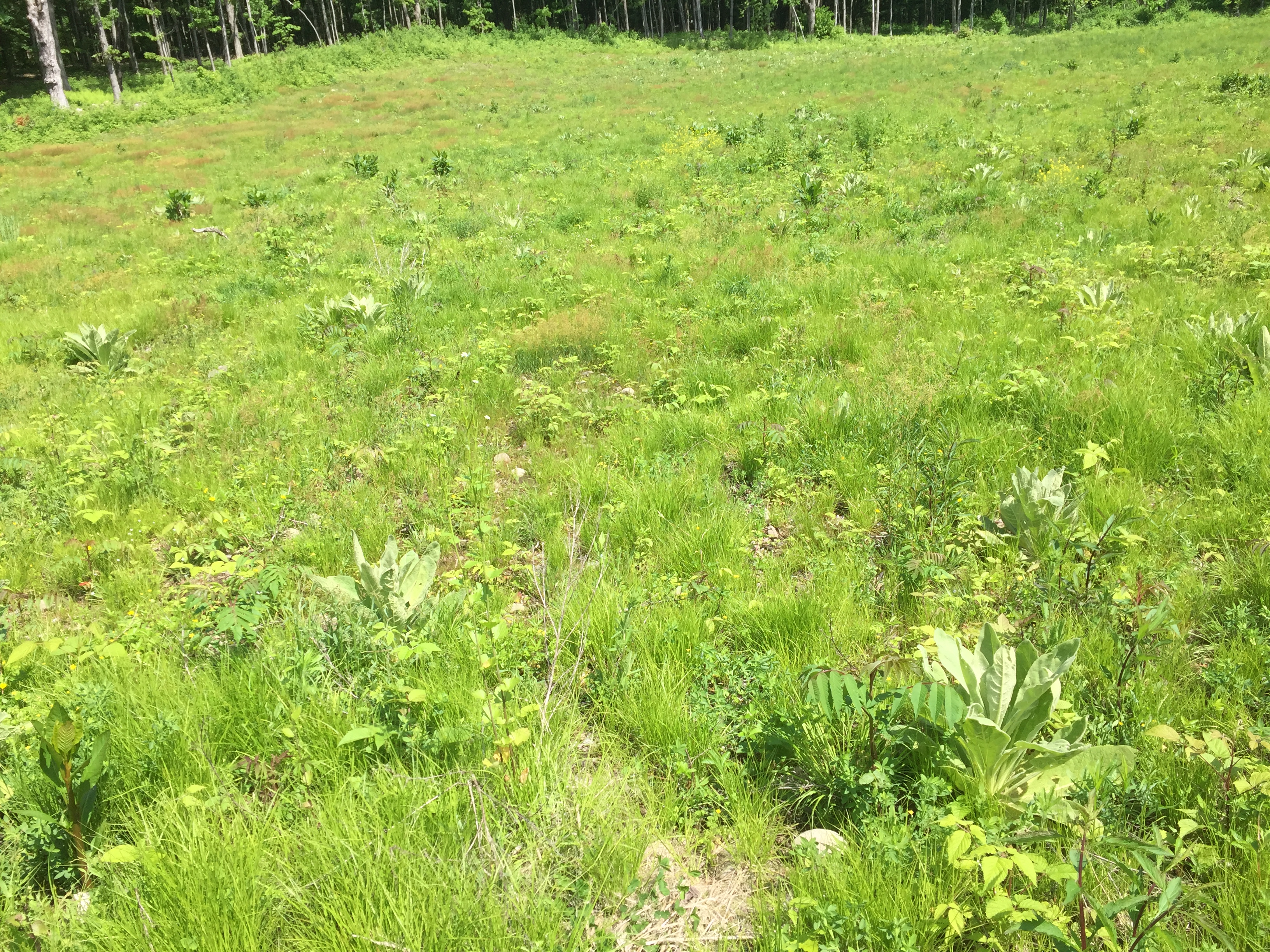

I moved into a 4 acre parcel today that an older lady wants cleared and seeded. Trees have been removed but some remains are still there. Grass has grown upward of a foot and thick in spots. I am wondering how a tiller will do in this type of condition. My box blade and york rake are very slow. I will get to the goal but could be after I retire. I have talked to some folks and they say the grass will be an issue. I ran a large tiller back in the day on a large tractor and grass was no issue for it but it was very large. I am looking at a 6 footer. Possibly the Mahindra brand. What do you guys think? Will the grass wrap it up?

If it were my land I would spray it with Roundup and then mow it as low as possible after you see it is dying. Then I would till it till smooth and seed it. If you broadcast the seed you will need to drag it to get the seed down into the soil a little, 1/4" to 1/2" is plenty. You don't have to wait long to reseed after Roundup, 3-7 days is plenty. It takes that long for stuff to start dying and to get the soil prepared.

We are in full agreement on the roundup. I need to finish this asap. At the rate I am going 4 acres is going to take 3 days. Too slow. I need to get it done in two and ready to seed. Not sure a tiller is the answer in grass this tall. I have no way to cut it either. I wonder how bad it would wrap up. I could always use another attachment :)

I have a 60" Taylor Pittsburgh tiller, I get a little bit of tall grass wrapped around the very ends but nothing in the center of the tiller. It's not like a walk behind at all. A couple of weeks ago I turned under my annual rye cover crop in the garden, it was about 30" tall, I pulled a few dozen stems off each end when I was done.

I have a 6' Taylor Pittsburgh tiller, and tilled up a few places without mowing first. And the tiller did fine. Had some grass wrapped around the ends, but was mostly clean.
.. It's not the way I would normally do it, but it worked fine for the 1/4 acre I did that way.
