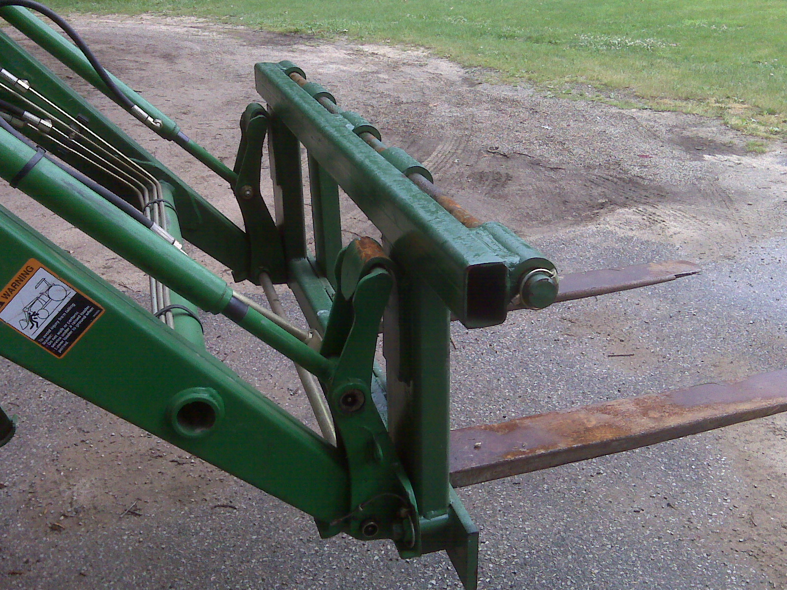

In order for those locking pins to be functional the bar that it rests upon must be notched. You could do it with a torch and grinder, but the bottoms will not be square which may inhibit the function of the pins in the first place. It would be best to use an end mill to make the slots. Probably another hour of machine time to do so. IMHO replacing the springs and getting those pins to work as designed is a waste of your time and energy. When I made my forks I cut off the "L" shaped lugs on the back and welded double extra strong steel pipe to the top of the fork with some E7018 rod; 1/8" gap between top of fork and outside of pipe. then multipass welds to fill it in. I wouldn't depend on it for a 8000# daily use fork lift, but for the 900# max lift my JD 790 can generate I am comfortable with my welds holding. Used a solid bar for the pipe to slip over allowing the adjustment of the fork widths The same pipe was welded to the quick-tach frame to hold the bar. The pictures can explain far better.
yeah, i hear ya. my original plan was the sliding bar, and to be honest, i'm not 100% certain which way i'm going to go yet. i'm leaning toward the bar/slot setup, as the forks already match. it's a 45 minute+ drive to buy steel, so it's also a matter of what is available when i have to pick up the few other odd pieces i need. i'm probably going to work with whatever they have in stock, and that may dictate which method i use. i do have the milling capability, and putting a 1/2" slot in a 1/2" plate shouldn't be too much of an issue. can't be certain cause i've never used the mill/drill yet. kinda looking forward to the chance to see what it can do be honest. whichever setup weighs less will be important too. lift capacity is hampered by the weight of the implement.

I have the same type of forks and milled slots in the upper bar. I also put a 1/4" bevel across the top of the bar on the front and back. The forks don't slide very well on the sharp edge.
