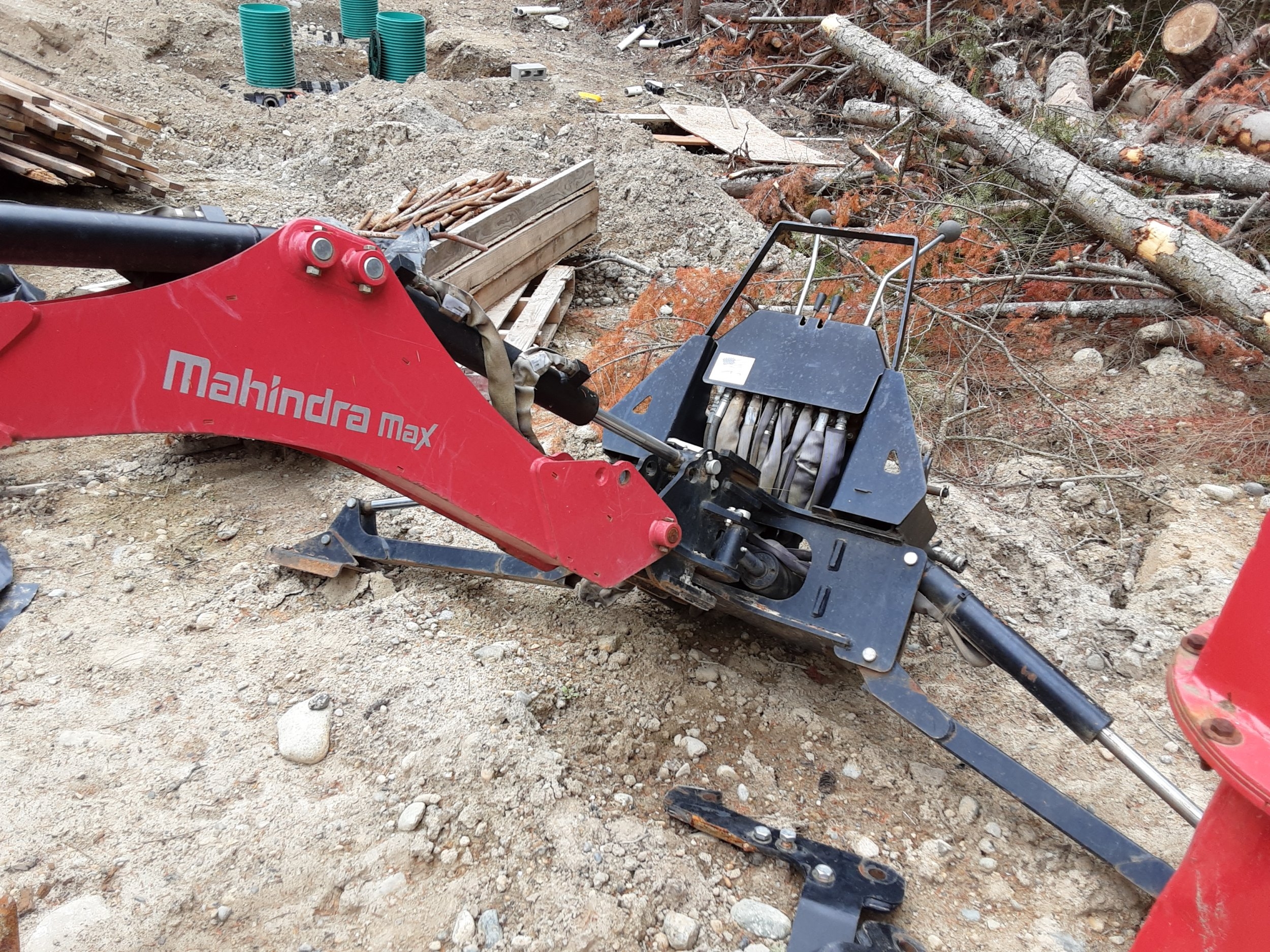

I am considering buying a Mahindra backhoe to use on my Ym2310. Please see the pictures.

Does the Mahindra BH need an under plate on the tractor to work? This would prevent the tractor from twisting in 1/2.

You can make anything fit with time and steel. You'll want to make a sub frame to hold it together. I would make it so that you use the stabilizers would pick it up and use bucket to push into place on mount. Don't rely on the 3 point to hold it. I put a Mitsubishi loader on an Iseki.

yes it does, it has a subframe, that goes to the front,
shame to see that machine abused like that

I'm not sure if this backhoe is still available but if it is I am thinking I could adapt it to my Yanmar YM2310. The backhoe was sorta frame mounted to the Mahindra tractor. The mount was not a 3 point. There were instead plates welded to the tractor frame. These plates had hooks cut in them at the factory and the hoe was captured by them. I'm not sure what the top of the hoe connected to but the seller has these parts too. The seller cut these plates and the mounts from the tractor and they come with the hoe. The hoe weighs less than 1000 lbs. I think.
It is powered by the tractor hydraulics. I will instead use a PTO pump and reservoir. I do not like dripping oil every time I take the thing off. I know, it's not much. The seller told me it's about 1/2 cup, maybe a little more, whenever he mounts or dismounts the hoe. He told me I cannot dig stumps out with the thing. He has 2 excavators that he uses for jobs like that. He got the tractor, complete with hoe, tiller, and other stuff as part of a trade for work done for a friend, so I don't know how many times he has connected or disconnected the hoe.
I already have a Case 580CK. It is great for digging big stuff. But not so great for tight spaces. Anyway, I have posted about this before and have read all the comments. So the real question is: can this backhoe be used on my Yanmar? Is it practical to adapt it? I am a retired self employed machinist and I still have my complete shop. So I can fab a frame mount. The hoe just has to fit.
Besides the PTO mounted pump I will also need a reservoir. I think that the reservoir does two jobs. It holds the hydraulic fluid and cools the hydraulic fluid. I thought about using a 20 pound propane cylinder but it may not have enough surface area for proper cooling. I also have a steel scuba cylinder that's about 8 inches diameter and 30 inches long. And I have some .060 thick steel sheet that I could bend and weld into a large surface area tank. I don't know how many gallons I would need to keep everything cool.

I would need to build a subframe. The parts the seller cut from his Mahindra I would weld to the subframe. The subframe would bolt to the FEL frame and the rear axle. The FEL frame attaches to the tractor on the engine side of the bell housing. So when digging the force would tend to rotate around the rear axle and push up on the FEL frame. So the forces would tend to push the tractor together. I'm not sure about the forces when pushing up with the hoe.

I was talking about the mahindra, there are bolts missing in the pin on bucket, etc.
I have no idea what this guy is talking about welding anything, the mahindra kit is a bolt on setup, for the backhoe, there are 0 welds in any portion of the machine, the entire subframe drops down
clearly you would need to modify it to fit your machine, but when people make comments like it was welded, had to be cut off, NO, no it doesn't, which makes we wonder what he is doing.

Maybe the seller doesn't know that the subframe can be unbolted. He showed me the plates that he cut off and where they were welded to his tractor. I saw where the plates were attached. He is supposed to be around on Saturday so I will try to get a few more pictures and then post them. He had a bunch of stuff piled around the hoe so maybe the missing pin is there too. The plates he cut off had hooks cut into them for the backhoe. He told me the reason he cut off the plates was because they interfered with the arms for his 3PH. If those plates are indeed part of a subframe that can be unbolted then maybe I can point that out to him and get those too if I buy the thing. I would love to have a complete subframe to modify rather than just the two plates he cut off.

he butchered the machine.... the 3 point hitch works perfectly, with the backhoe subframe on, it wouldn't make sense for it not to.
I wish you luck, he clearly did not know what he was doing.

The backhoe looks to be in good condition and he will hook it up and operate it though it will of course just be the hoses connected which will limit the kind of tests I can subject the hoe to. If I do buy it I will want to operate it from a PTO driven pump. Do you see any problems with that? Also, do you know if a hydraulic thumb is or was available for this hoe?
