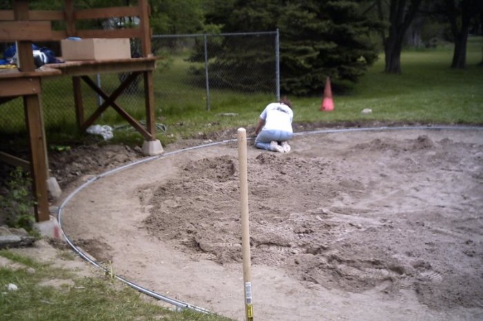

We just put a 27 footer up at my sisters house. We have about 3-4" sand base. here's some photos

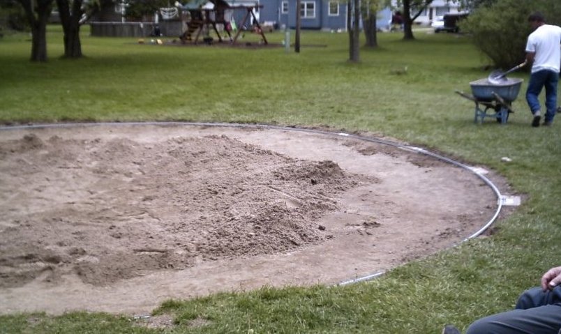

photo 2

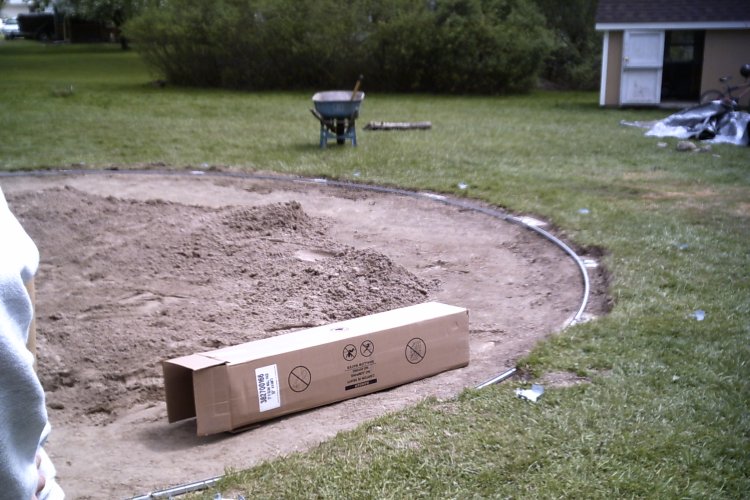

photo 3
