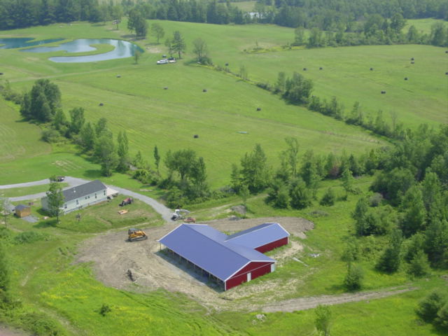

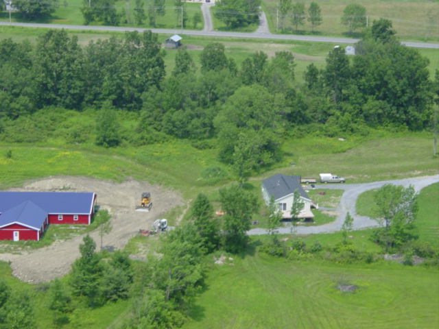

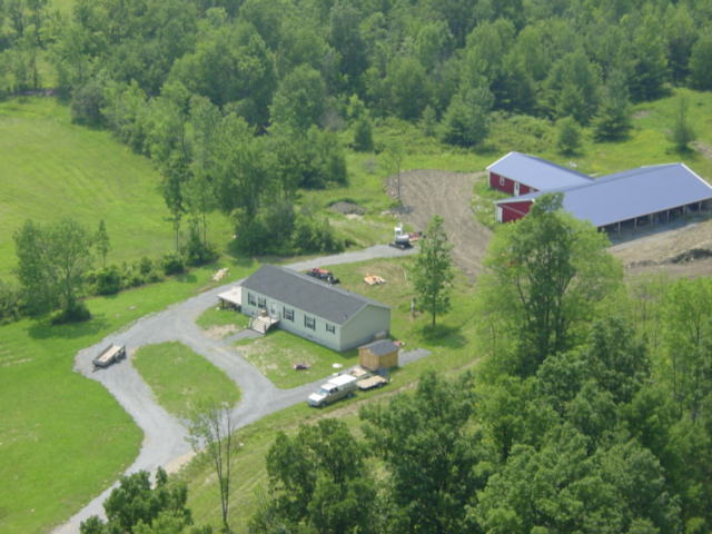

I know I have promised pictures this is not complete but it will give you layout of land. I will also post pictures of before we started and then after pictures.Here are some aerials of the place. I have more pictures and I was going to post from home last night but response time so bad I did not take the time.

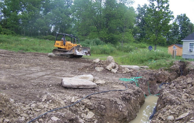

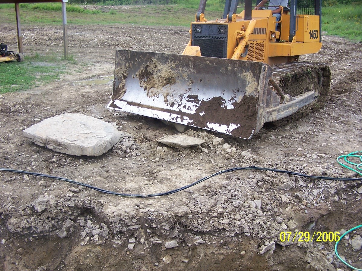

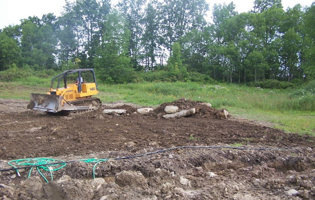

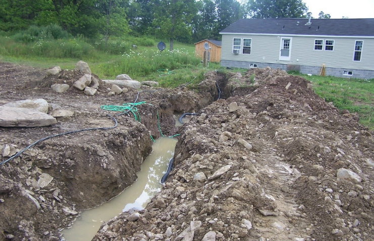

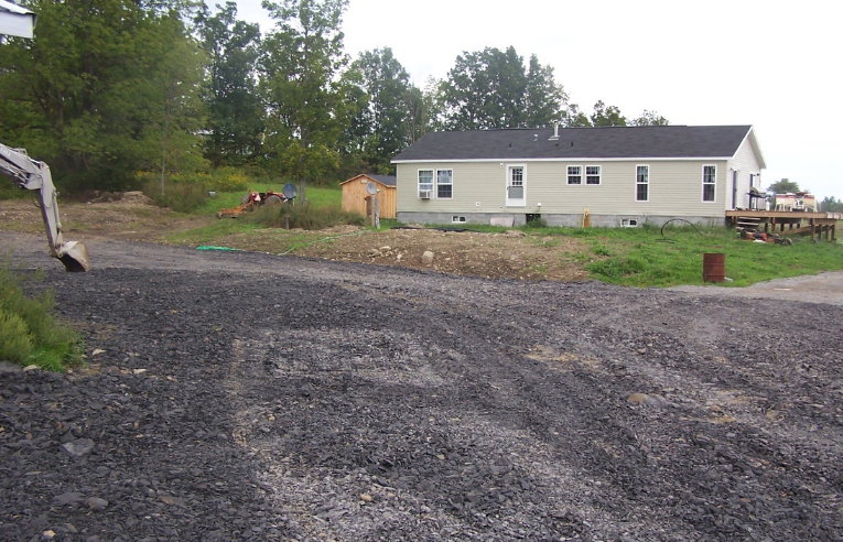

ok here are some pictures. Here is the trench I dug from my house to the barn as you can see it is full of water. That is what holes do here they fill with water, which means a trip to tractor supply for a trash pump to get water out of ditches. I also used sand to back fill ditchs even though everything was in pipe. Due to wet ness the sand in the ditch turned to quick sand so I placed long blanks on top of sand to keep the rocks that had to go back in the ditch from hurting anything. The really big rocks we pushed in the area we filled in to make a parking lot. There was so any rocks it was impossible not to place some them back in. But here are some pictures of the ditch open and then the water pipe is what is floating in the water.
picture aug0601 is water in ditch with pipe floating
picture aug 0604 is ditch and some of the rocks we dug out electric along side ditch put not in pipe yet the dozer in the picture is a 1450 case with a 12 foot blade to give you and idea of rock size
picture aug0605 dozer next to rocks
pictures aug0606 water is almost to the top of the ditch and dozer guy is pushing stuff from bank
picture sep0604 is ditch closed and shale down from same angle

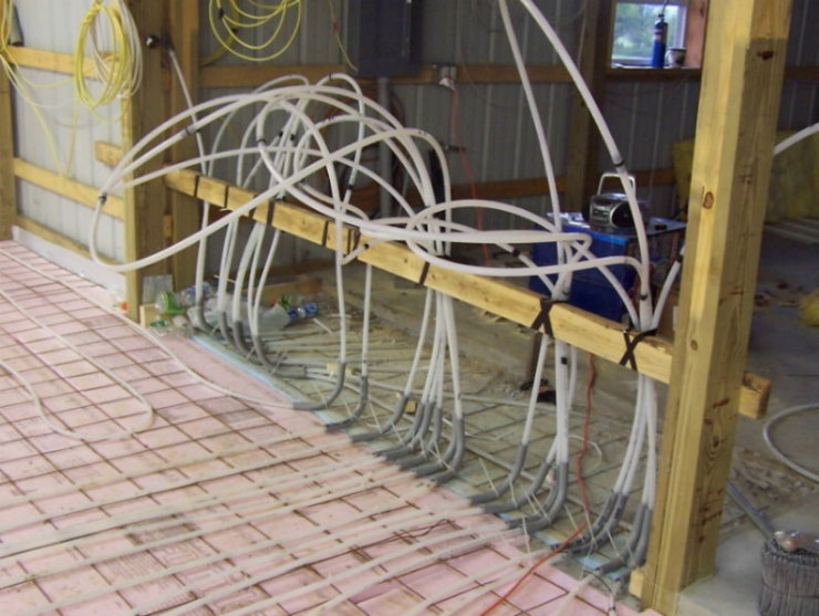

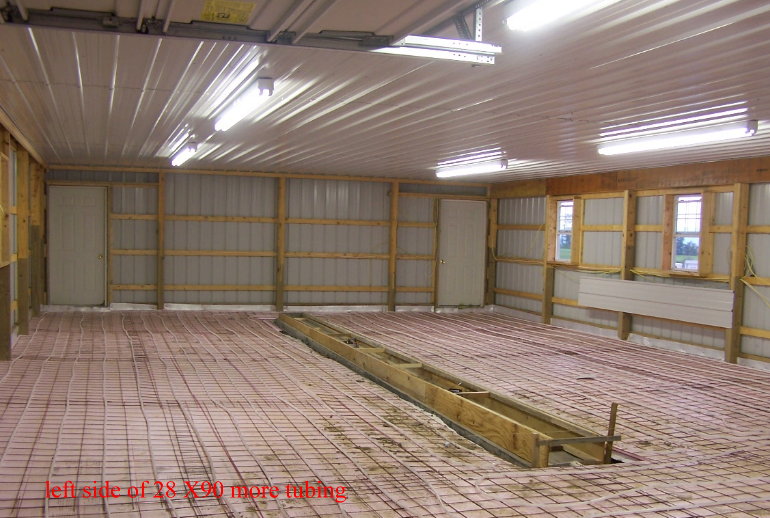

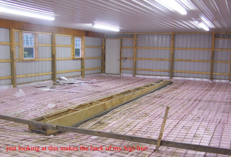

ok here are some pic of the tubing we laid in the barn this is 2400 feet of tubing and it also shows the 30 X 40 we already poured
pic sep0605 is where tubing is all connected togther and under pressure
pic sep0607 this is one side of barn there is 1200 feet of tubing here
pic sep0608 this is the other side of barn again 1200 feet of tubing
pic sep0609 this is the 30 X 40 we poured the other weekend

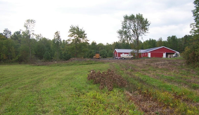

ok here are the pictures for the hedgerow I had taken out.
The first two pictures show the hedgerow the third one it is gone.

Photos looked good; thanks for reminding me to come look :)
I got my tractor back together after breaking it in 4 wheel drive, but found a cracked fuel line after getting it backtogether & running for an hr or so it started leaking bad enough to cause a miss so Ihad to shut it down. now waiting for parts again.
OPPS: forgot to ask are those SWEEPS for electrical conduit to protect the PEX exiting of the concrete? or???
