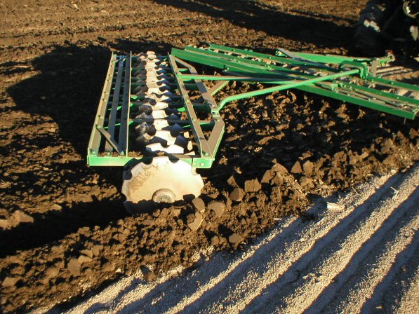

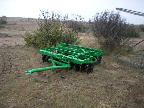

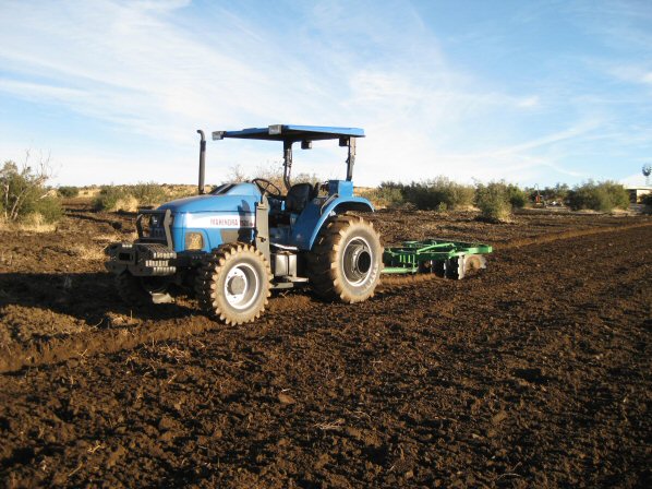

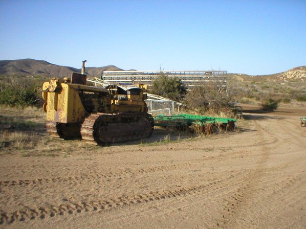

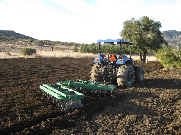

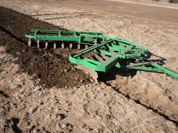

So much depends on your exact conditions. I would say that an 8' or 9' at tops would be what you could use. I have old Kielfer pull disks with 22" pans that weigh around 2500lbs for the 8 footer and around 4000lbs on the 12 footer. There are times going up our rolling hills that it is all that my 75hp 10,000lb plus tractor wants pulling the 8 footer.
I can pull the 12' disk on level ground only and only on a one pass run. It will not pull a 2nd pass. The Cat is typically used when the 12 footer is used.
If you can find a 9" 3pt disk, you could use that along with making use of the tractors draft control feature.
I hope that some of this helps. ;)

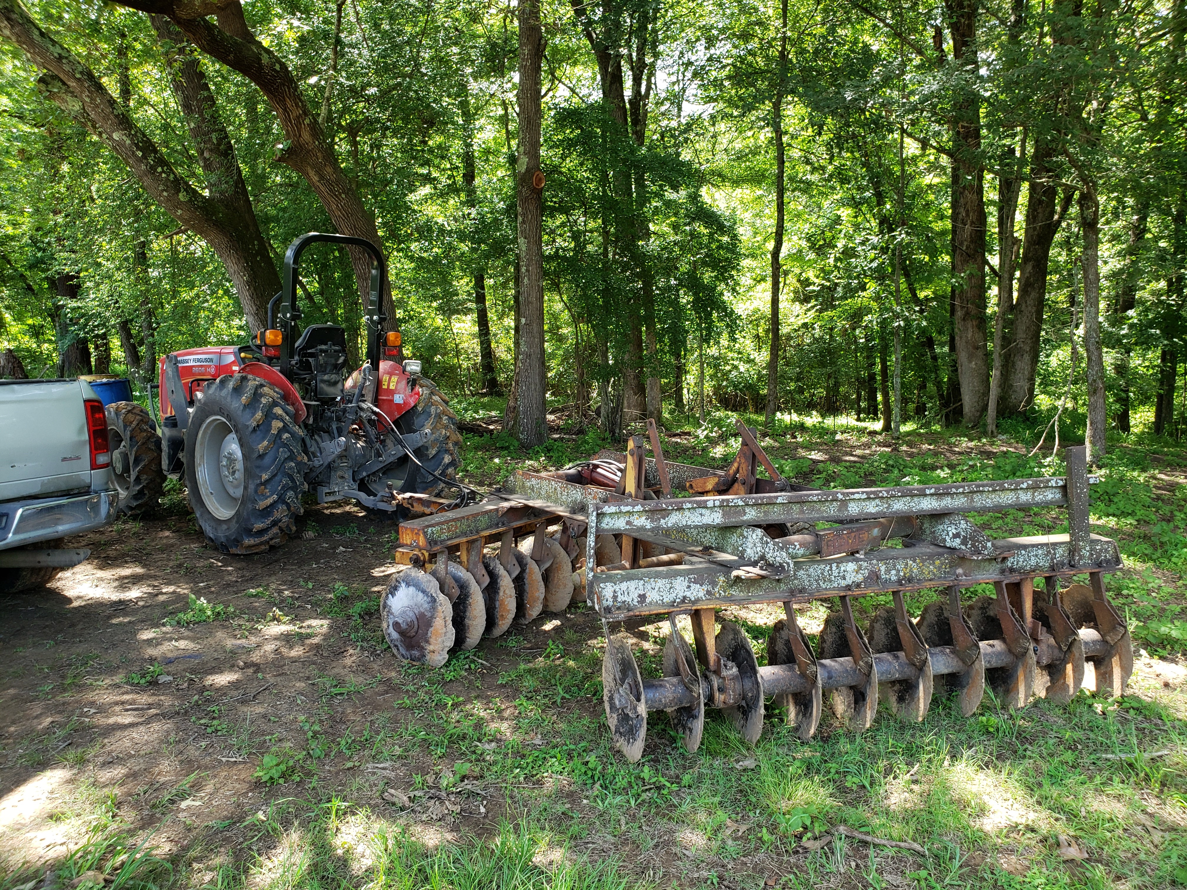

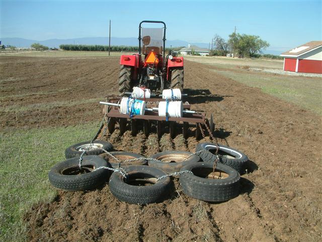

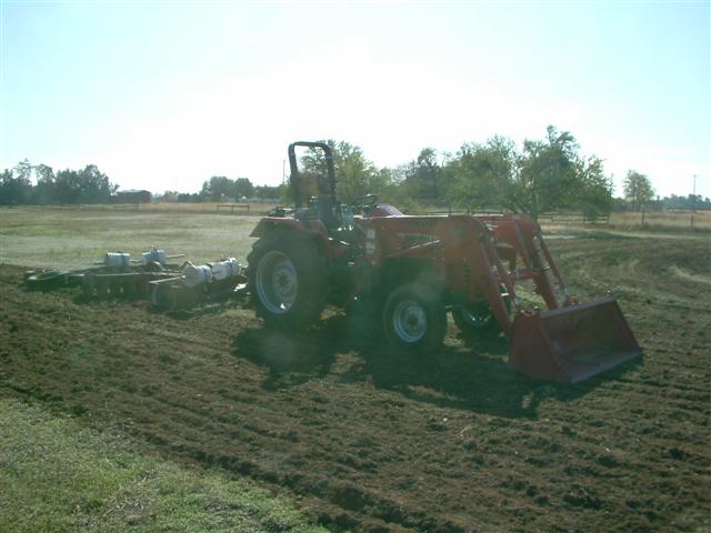

I could pull an old 7-ft Towner offset disc with my 2008 Mahindra 5525 (55 hp engine, 45 hp pto, ? hp drawbar). I added about 480 lb of concrete weight to get it to work in pretty dry soil.
Good luck
