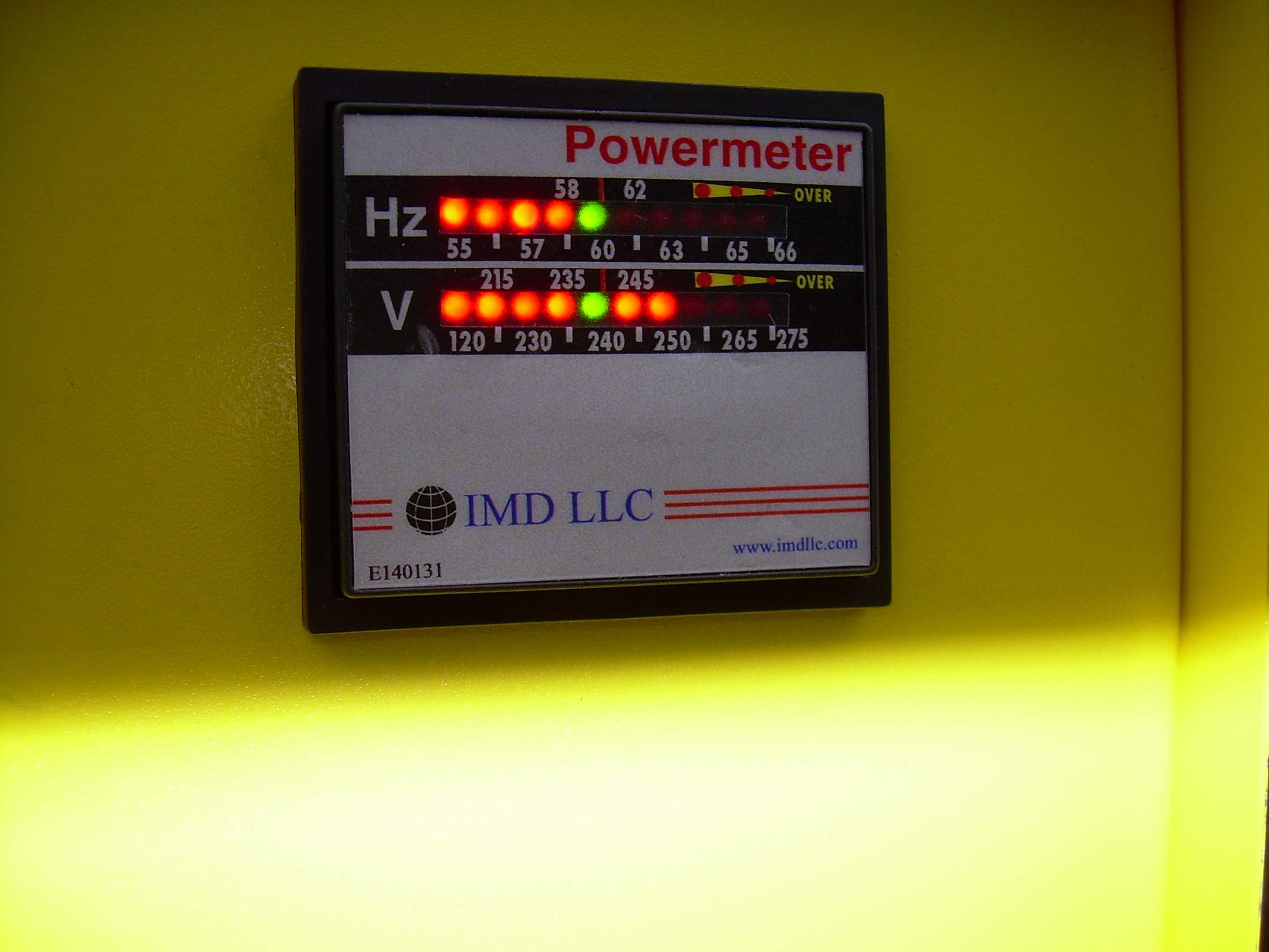

I just finished building a 3pt hitch mount for a new 7200 watt Northern Tool generator I bought. All went well and I decided to do a test run. All was great except for the tractor tachometer reading. The tach should be reading 2600 rpms to get 540 at the PTO. I ran the rpms up until the volt meter on the generator was reading center of the green band. (only 2200 rpms on the tach. ) Then I plugged in a salamander type heater into the gen. It started right up and ran great. I then took a hand held meter and measured the gen output while the heater was running. It was right on at 118v and freq. fluctuating between 59.99 and 60 hz. Seems perfect except tac. is 400 rpms below what it should have been. Based on the two volt meters and frequency meter, I'm guessing the tach is off. I wonder if it's adustable. The tractor is an LK2554 Kioti. Anyone else have inaccurate tach experiences? This implies that I have been running my pto attachments like snow blower, leaf vac. and finish mower at roughly 18 percent over speed, or 638 rpms. Seems kind of excessive.

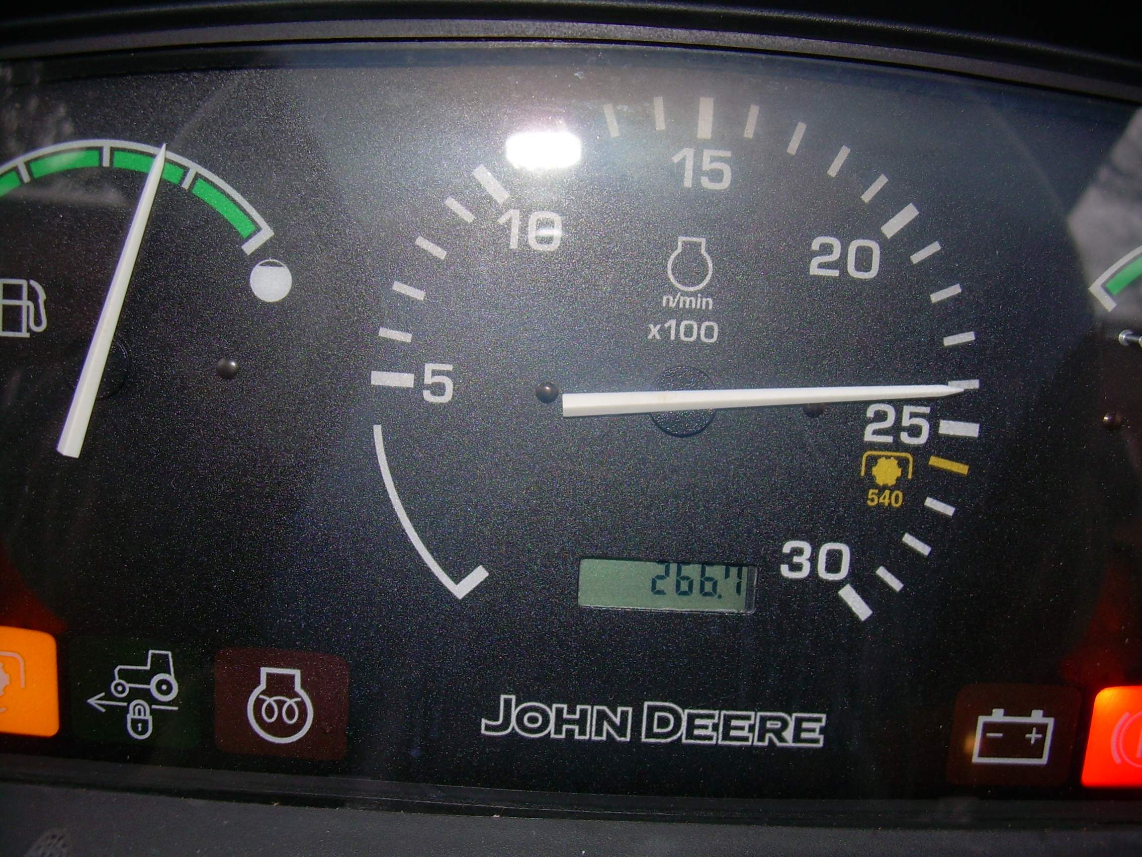

   / PTO Northern Tool generator and tacometer #6
Mine did the same thing on the tach, I was not worried about the tach being off. Thought it was better than than being higher.
Thanks Blagadan, not sure if I can afford to be that accurate:D But, it seems that I now have a good way of determine true RPMs. It seems to me that RPMs are directly proportional to output hz. If I know that 540 rpms is 60 hz then I can measure the frequency at any speed and calculate the rpms at the PTO.

   / PTO Northern Tool generator and tacometer #9
Sure its possible to change the tach calibration. It may even be available on the outside of the tach enclosure, but I doubt it. If you can get to the circuit board where AC is being converted to DC to drive the meter movement, there has to be a trim pot on there. Its probably locked with red goo, but can be changed if desired and more goo applied. You will need some test gear, like a frequency generator and lab bench power supply. But really, it is not worth it. I would mark it with a pc of tape, for future reference, on the face of the meter glass. to be sure though, you first have to count the input revs and the output revs (assuming there's a gearbox), to determine the ACTUAL reduction gear. It is possible that the generator requires 560 rpm input or something to acheive 60Hz, due to gearing that is close but not quite exact. Sounds like a fun project either way.
