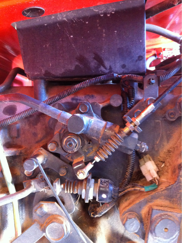

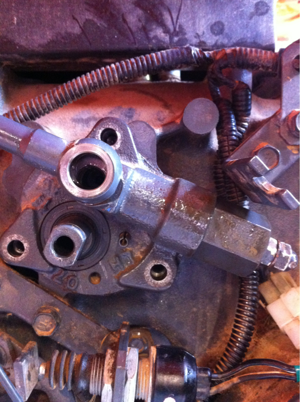

Hi. Im hunting the sqeek sound on my M7040. A nice gentleman on TBN, Greg Hammerstein had the same problem on his Kubota M7040, and Kubotas serviceman knew exactly was it was and removed this unit and behind he found metal shavings that creates this sqeek sound on idle when the oil is warm.
Please if anyone know how to remove this please reply. Thanks
Sam
   / Pto clutch remove problem m7040
#2
Found the solution:) but havnt found any metal shavings:( well pieces of rubber gasket in the small hole of the relief valve...hmm... Well I dont know if thats the answer to the sqeek sound!?
Ok ok. Today is a great day!
Thanks to TBN and GregHammerstein here I finally got to kill the screaming sound of my M7040!
(A few hours removing the rear wheel, fueltank and the ptoclutch cover)
Feels like a new tractor:D:D:D
Thanks Greg!
/Sam
