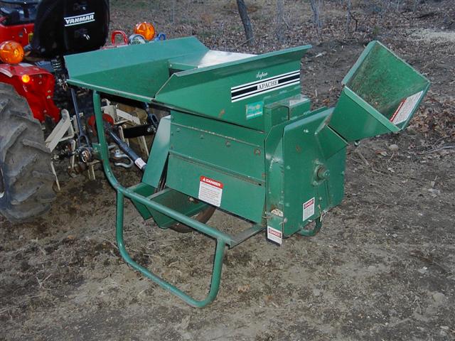

I think if you are looking at the DR or similar you are on the right track. I have a similarly sized machine, though its an older unit i bought used. My tractor is also 18hp, with about 16 or so at the PTO. My chipper will do about a 4 inch stick, but honestly, that is firewood to me. Most of the stuff i chip is brush, so i don't use it to capacity as i burn anything bigger than that in the stove. Mine has a shredder on it also, which is fantastic for the leafy small stuff. As far as the manual feed, auto feed argument..... i'm sure an auto feed must be better, but definitely not necessary for what i do with mine. I've never owned a machine with auto feed, but i can tell you i tuned up my chipper this summer (sharpened blades, new anvil, set clearances) and it works fantastic. A light push on the limb is all it takes, the chipper actually draws it in pretty well on its own. If you aren't doing alot of large hardwood, i think a DR sized machine is all you will ever need.

   / PTO Chipper on a JD 4110 or similar machine? #5
Norm - I PM'd you with the dealer info.
I'd second ductape's comments on the shredder and autofeed. I use my shredder hopper as much or more than the chipper feed; and I've never had to really force anything into the machine such that I'd feel any need for auto-feed.
-Craig
