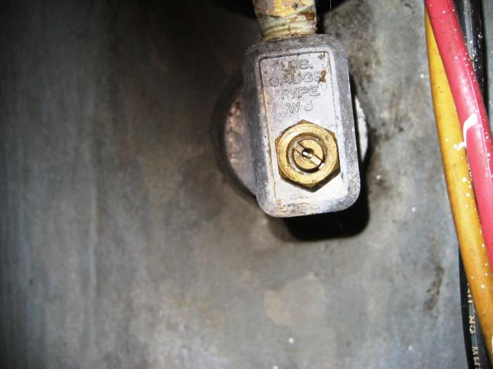

Does the tank have a strange looking valve like this ?
attachment.php

Sounds like the same setup I had before going to a bladder.
attachment.php
Nope. Just a 1-1/4" white PVC plug in the top.
