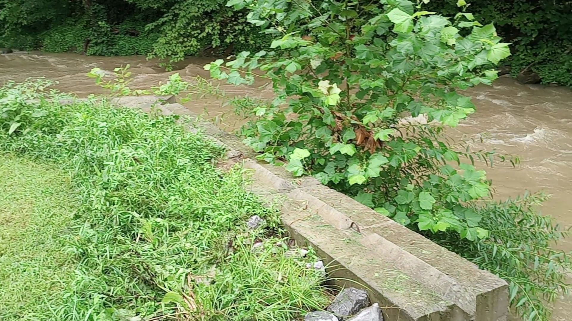

Testing...testing....after 1.25" of rain in 24 hrs:
The first two pics are the staircase behind the Weir at the 'Dam'. There is basically zero current hitting it.
The last pic of the one by the pigs is not getting the full force of water, but it is getting some. Curious to see what the base of each looks like when this goes down, which will take a day or two of no rain.
I will try an upload a video....

Someone else suggested it earlier in the thread, but it would be a good idea to add some rip rap along the stairs to divert the full force of the water away.
   / Pouring steps down to the creek/swimming hole...nope, never done it before!
#115
Agree, I did move some smaller stuff, filling in along the bases and pad. I will have to go get some from areas of the bank that have an excess and move it to the staircases. Picking up the tractor today after front axle bearing replacements, it will be good to have the hydraulic wheelbarrow back:cool:

Make sure to place riprap on the down stream side of stairs. This is commonly forgotten and can lead to failure

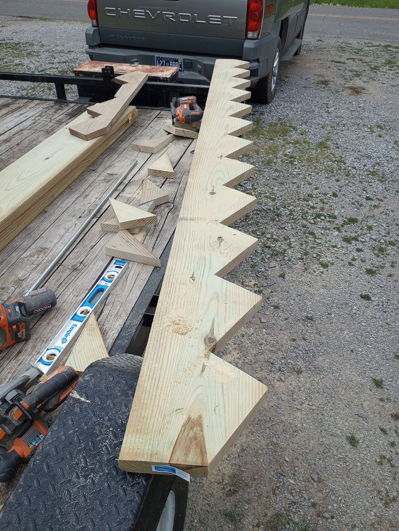

Last year, we had a bank erosion project completed on our creek that runs through the property. 300' of fabric and 120 tons of rip rap. In the summer, the water is low, and the creek is about 7-8' down from the pasture. So, with the angle of the rip rap bank, I need about 12' of steps. Trying to walk/crawl down to the creek right now is hazardous, but necessary if you are going to take a dip in the swimming hole. Flooding in spring can be 2' over the banks and completely cover my pasture out to the paved road. For this reason, wooden steps will not work.
Speed Test
Since I have never done this before, I Youtubed it, and now am a confident (cough)expert. Stair tread/rise calculations hurt my head, so I keep a 4' HomeDepot pre-cut Stringer handy as a template. I bought 4-12' 2x12x12 boards and marked out the risers and treads.
So, put 2x8 risers on the Stringers 2' apart(width of stairwell), drag it down to the creek and find a suitable spot to set it on top of the rip rap. I figure a 3x3 top and lower pad all tied together with some re-bar.
Will take new pics of the creek and proposed stair location......stand-by.
What could go wrong pouring 24 steps??
It still scours. Unless it's bolted to bedrock or on deep pilings, if the water comes fast enough long enough, it washes out.
