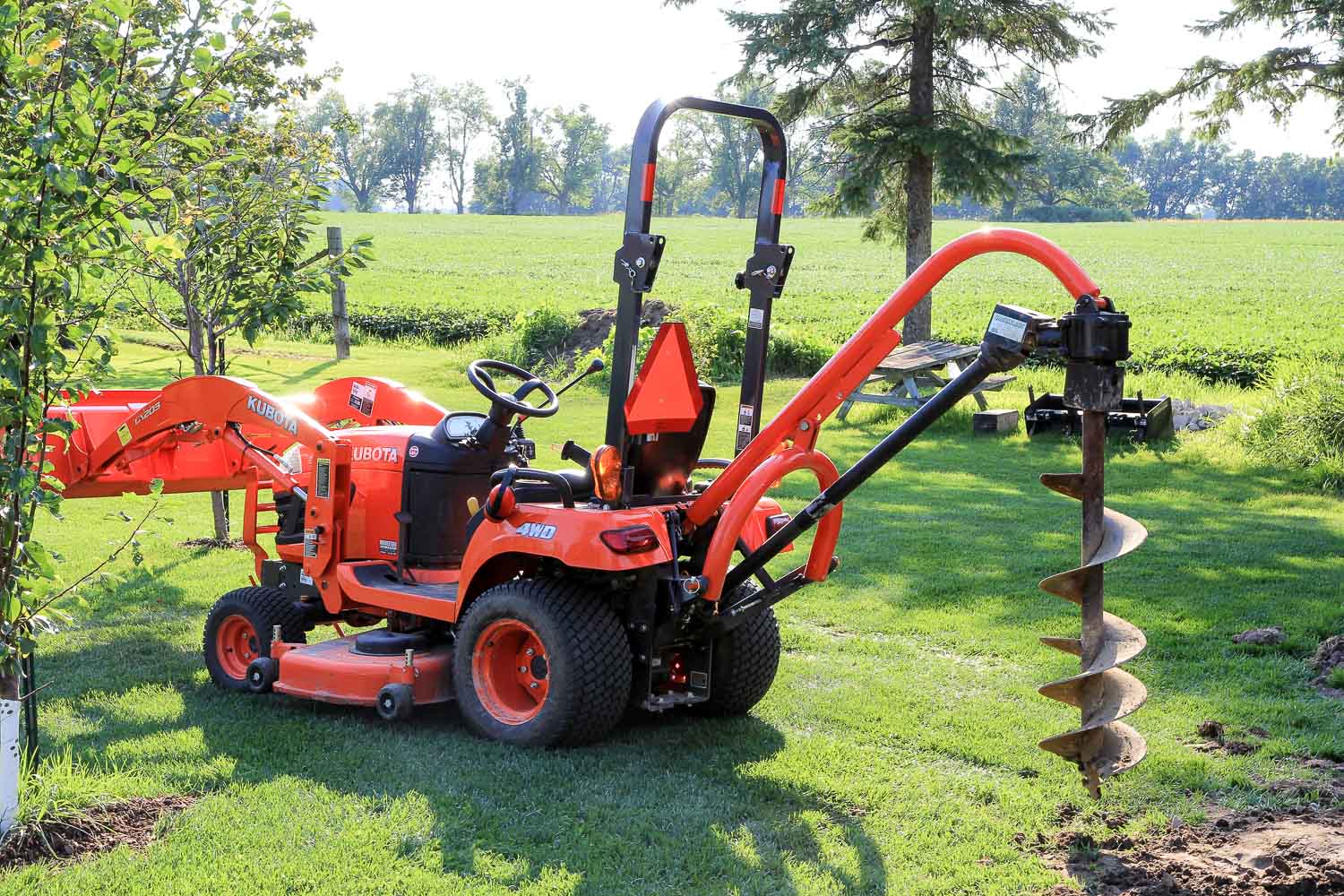

#13
Thought I should follow-up to my thread. I ended up buying a used Greenline EM5000. I had to drill another hole on the boom, to get the right adjustment. It sits about 6" above grade in the upright position and if I lift the front end of the tractor up withthe loader I can dig a full 4ft. And of course when Kubota spray paint came on sale I had to make it match. :)
