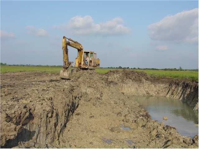

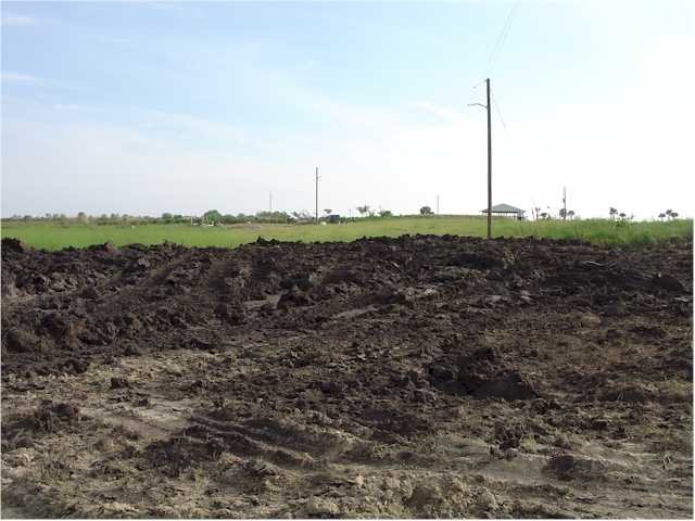

I am digging a 250ftx150ftx8ft pond and using the dirt to build a 225ftx160ft housepad, and 1100ftx15ft driveway. We first planned to use a huge tractor with a 30 yd3 dirt pan but couldn't fit him in our schedule. Now we are using a track hoe and dump trucks combo to do the work. I'll be posting some pictures of the trackhoe, dump truck, and the Case 65C dozer at work as I get them.
First we stripped some top soil off the pond site and moved it to south area in front of the house pad.

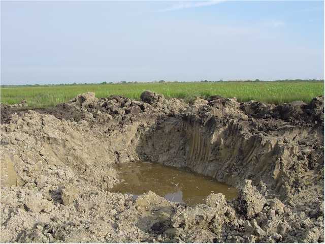

Then we digged a small hole and allowed the surrounding standing water to drain into it. This kept the small amount of water from poor drainage from muddying up our work area.

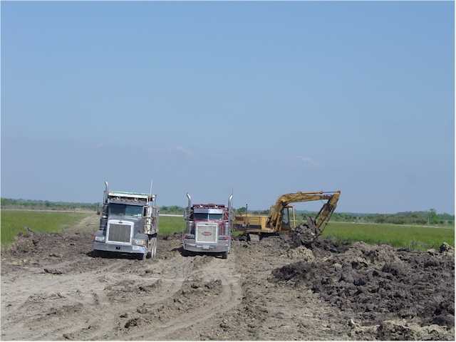

With my work load I couldn't do the work myself. Had to contract it all out.
Here's the track hoe working with 2 dump trucks.

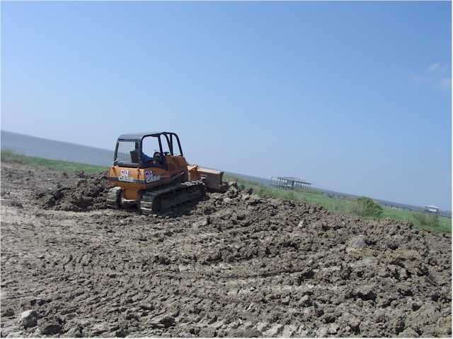

Here is the Case 65C dozer at work building the north side of the house pad.

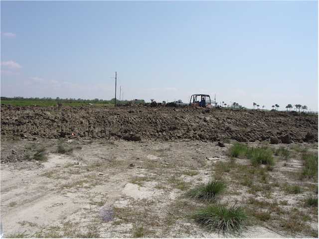

   / Pond and pad construction
Middle of day 2 and we have built a pad 160ftx40ftx6ftH. Final dimension for the pad will be 160ftx225ftx6ft so quite a way to go yet. The Case dozer looks good working on the dirt pad.
