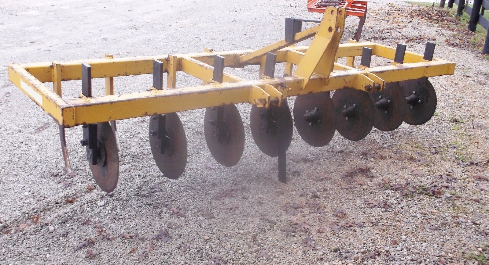

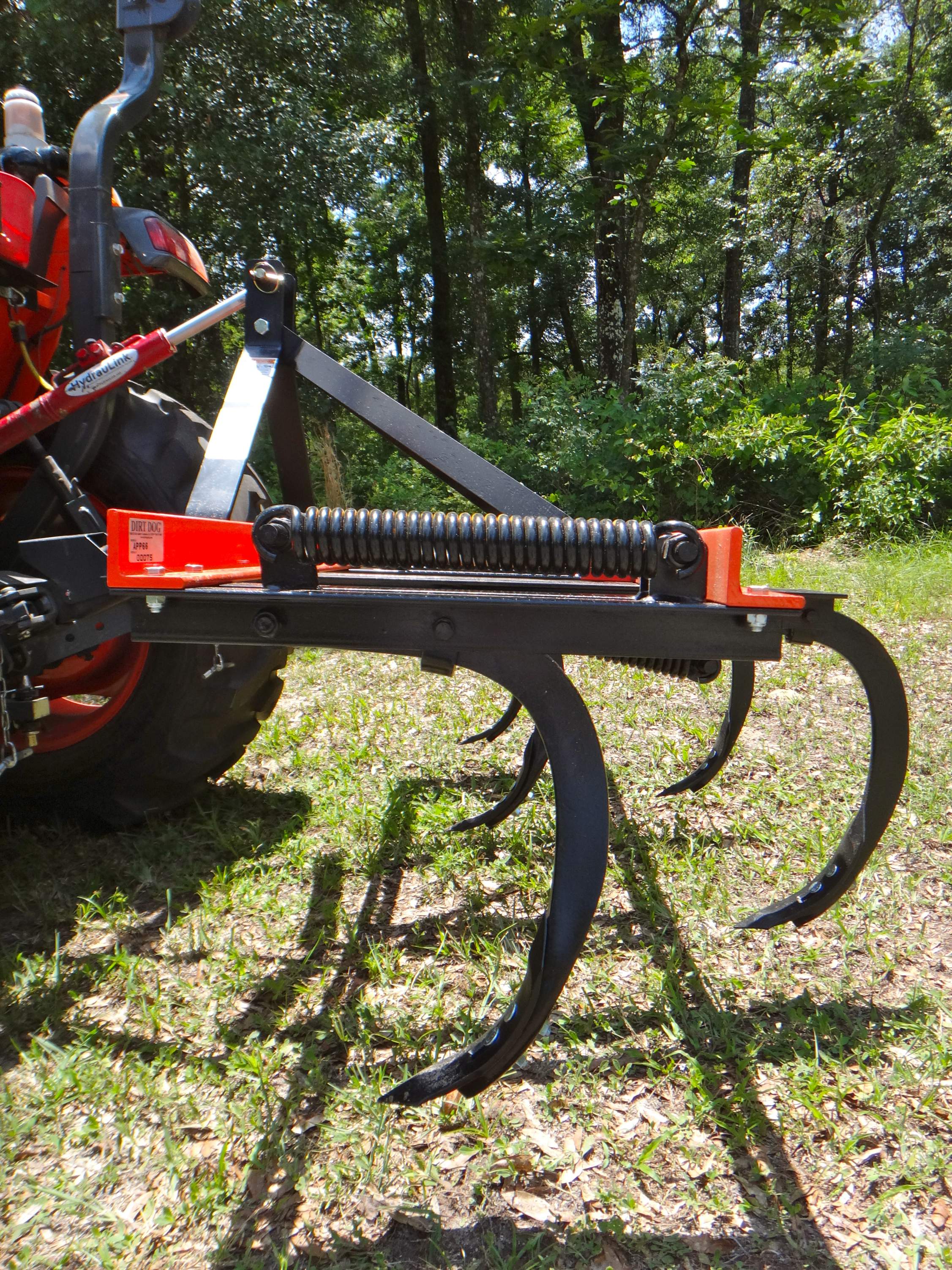

The HayKing is one of the best for pasture renovation and Tufline is also at the top of the list. Below is a Pic of a Tufline C-8 PR that we just traded for. Ken Sweet

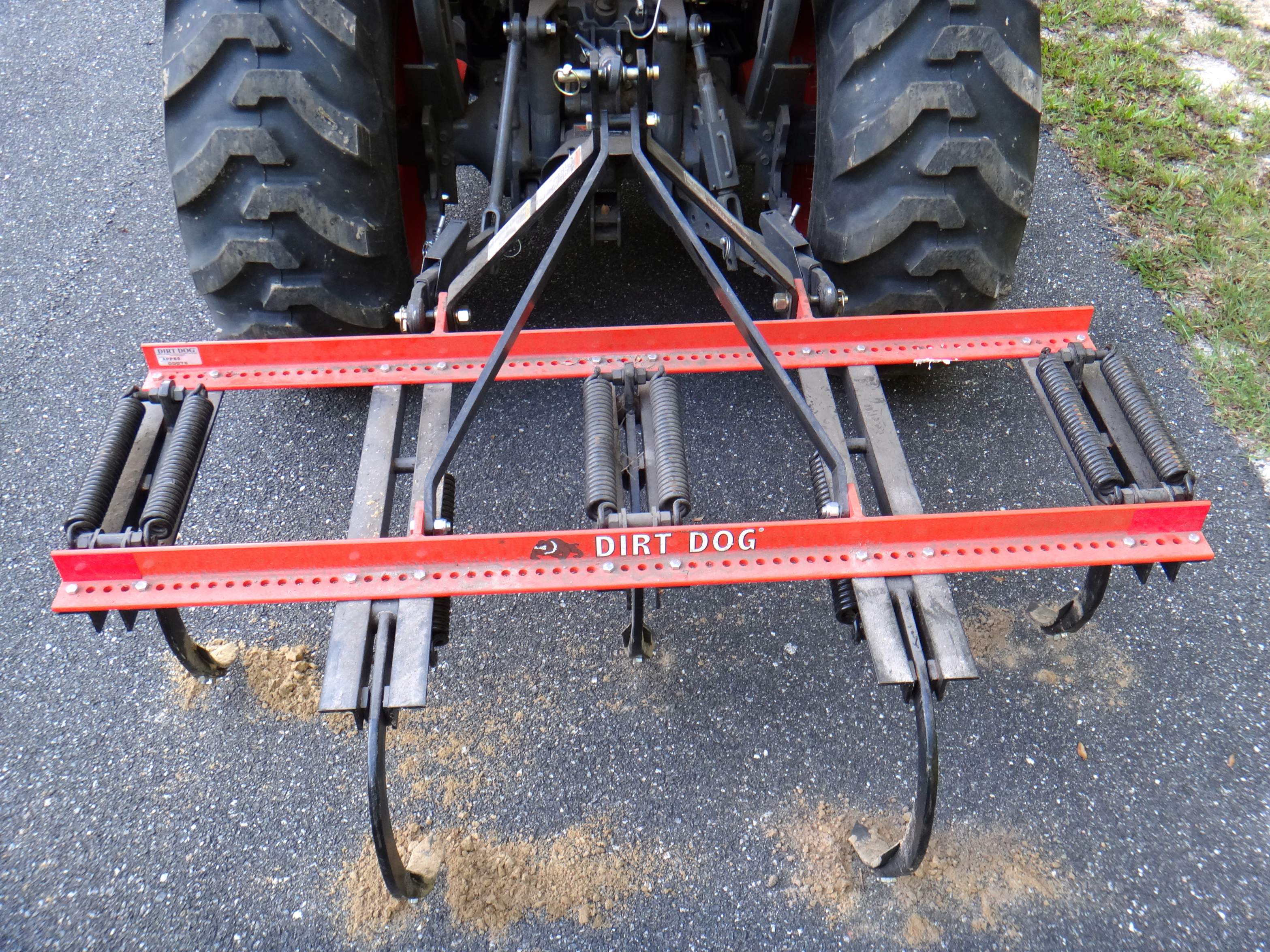

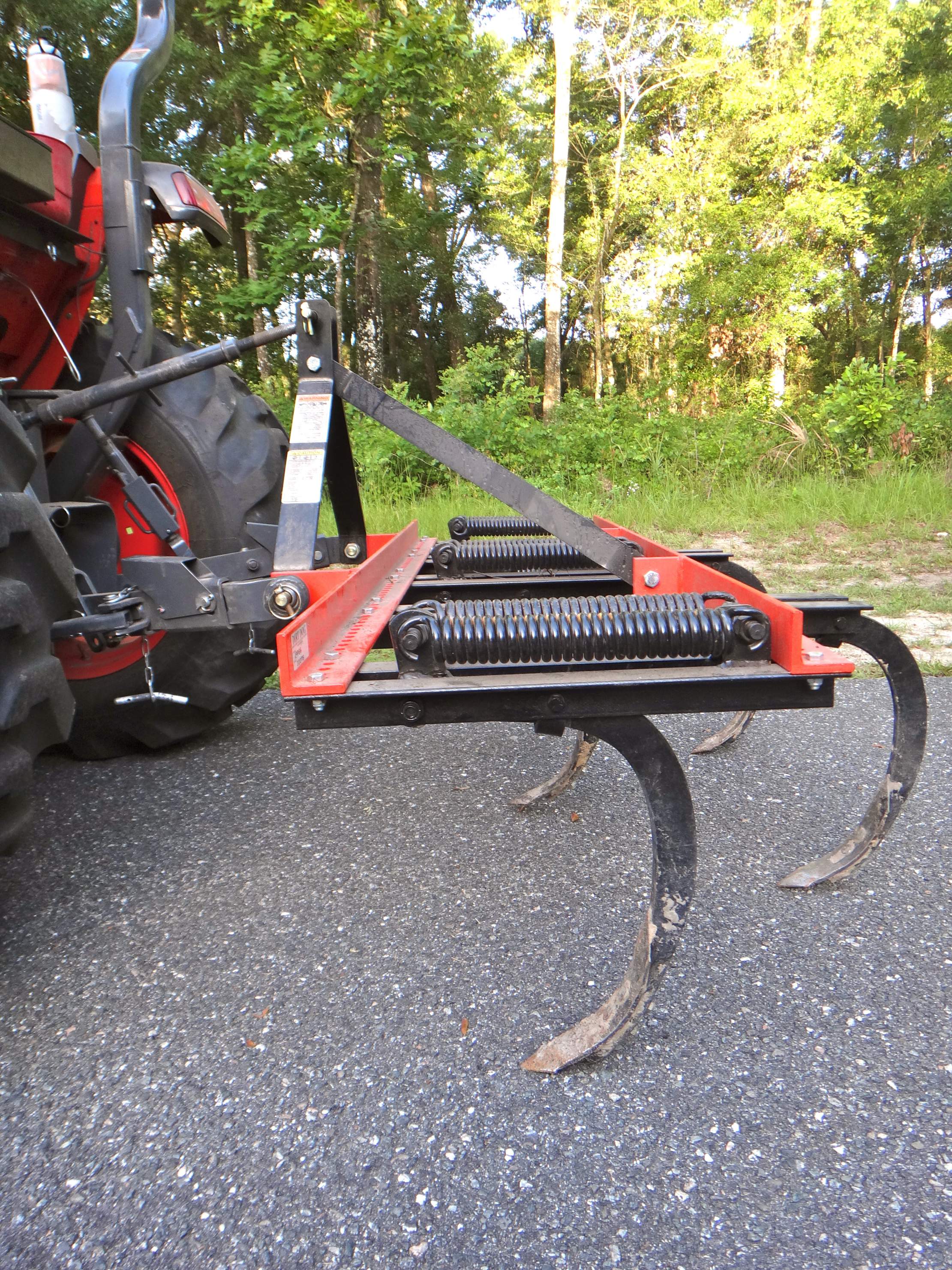

Ken: Lend me your experience.
Compare the function of the Tufline Renovator pictured in Post #22 to a Dirt Dog All Purpose Plow / Field Cultivator.
I realize there will be some overlap in function.
Thank you.

The dedicated renovators like the HayKing and Tufline PR series have narrower points and have the opening coulters that run ahead of the shanks. Ken Sweet

Butting in: I have both and the Renovator does two things that the chisel doesn't. 1. It has a coulter that cuts sod and runners, like in bermuda grass....reason for it's effectiveness in spreading that plant. 2. The cutting blade on the Renovator is only about ½" wide (but 2-3" long for strength), rather than 2" wide on most light cultivator shanks, with a sharp entrance to the soil so working with the coulter, even in Houston Black Clay, there is little if any topsoil disturbance.
So, if you want to cultivate, use a cultivator. If you just want to renovate your pasture....aeration and grass stimulation, use a renovator.

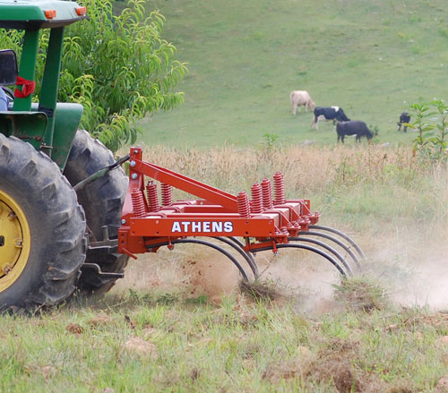

A Field Cultivator is a light duty Chisel Plow. Both the Field Cultivator and Chisel Plows are in the category of Conservation Plows; while they can rip pretty deep, both leave the surface fairly intact.
Each sharp chisel point on my Field Cultivator is 2" X 10" = 20 square inches, oriented horizontally in use. Chisel points are uniform 5/16" thick. Vertically oriented tines are 1/2" wide.
I had the Dirt Dog five shank Field Cultivator mounted on the 3-Pt. today, ripping pasture which was Disc Harrowed last week, 10"-12" deep prior to planting Blueberry plants. The HST+ was in MED/2, throttle full ahead.
