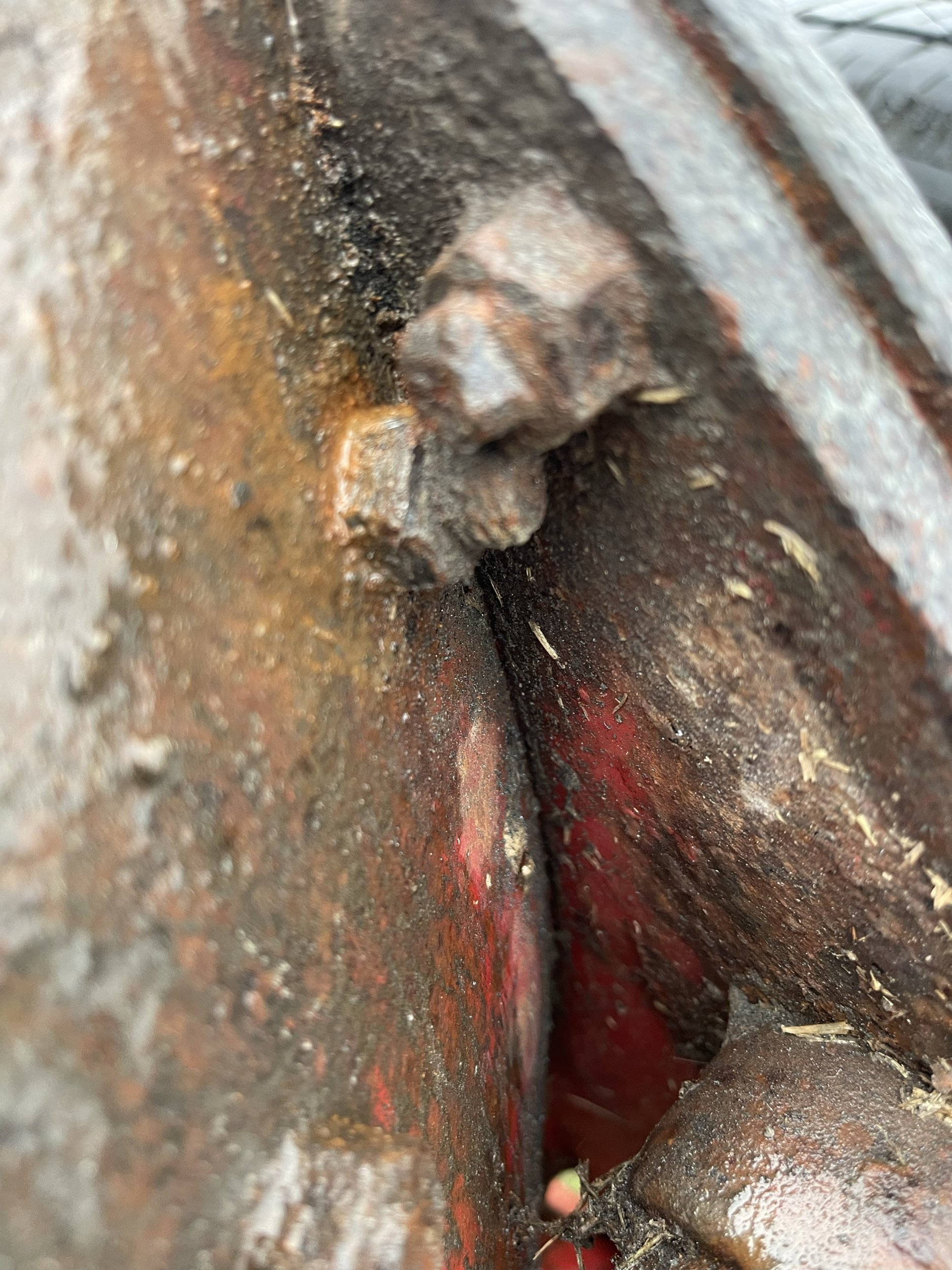

So I have this old (new to me) plow. Wanting to replace shins on it. There are 2 bolts and the lower one is in the picture below. It’s the one in back of course. About the only way to get them off will be to cut them, not a huge problem…. But.. how would y’all get it back on. It’s going to be very hard to tighten since it has the metal behind it and the bolt in front. Looking for ideas.
It’s a Massey Furgeson by the way, the plate says it’s an 80 I believe? 4 bottom and can be made to a 3 bottom.

Should be fairly easy, just start the nut as the bolt starts through, run it down with your fingers, while pushing the bolt on through, then tighten with the open end of a combination wrench.
