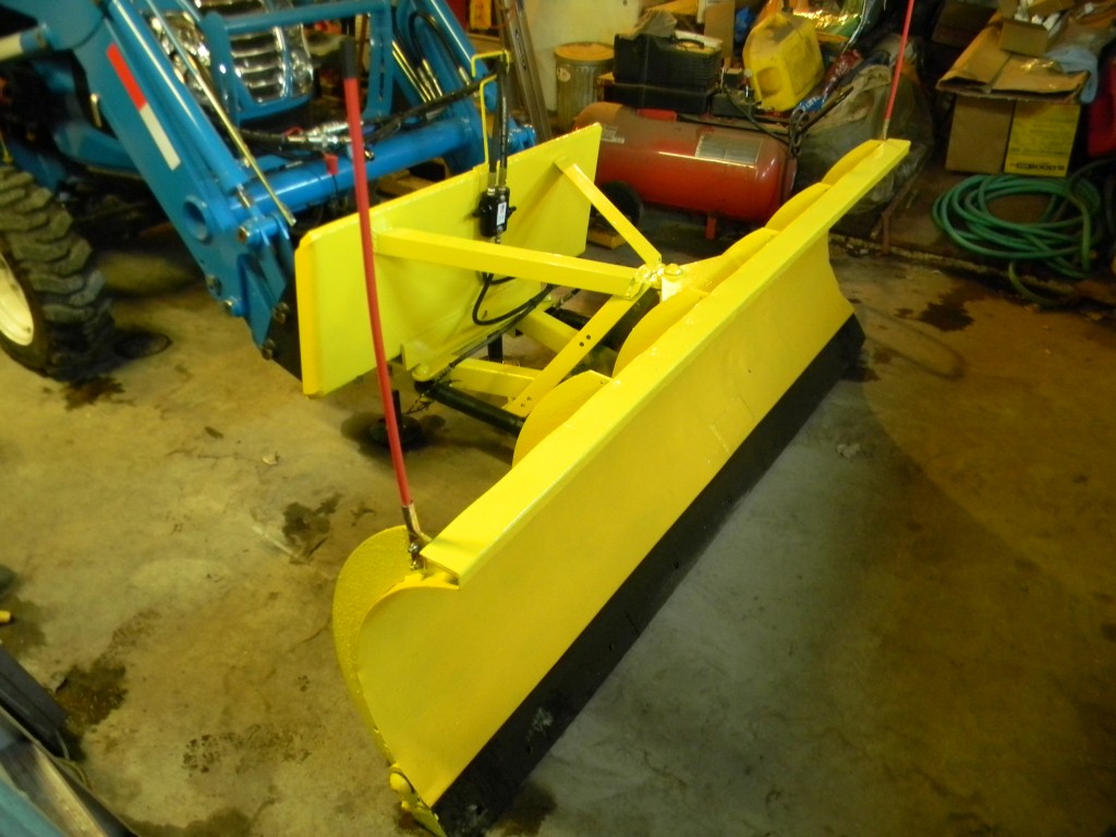

You already have the 84" plow. Make use of it. Mine is an old 7 ft truck plow I use on the LS 36 HP. I was originally going to scrap the plow but I figured a few hundred to rehab was cheaper than a new one. You shouldn't have to trim the plow down. For mine I bought the HD 1/2" SSQA plate (5/16" would be fine), 2 used cylinders, hoses, pressure relief, and some scrap steel and paint. I think you saw my build thread. Pretty much the same set up as yours and weight about the same, mines about 5600.

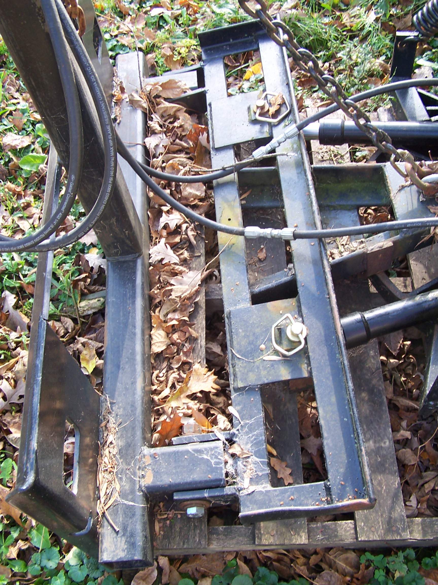

You have all the makings of a FEL mounted snow plow why spend a bunch of money on new.Purchase new cylinders
and hoses/QD's.
Mine is a 8ft.(old Curtis truck plow) and is a good fit for my L4240.Mine floats the plow with a chain and I like this set-up.Others have made it rigid and float the FEL.Make as short as possible.
