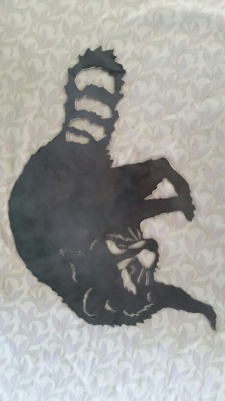

I'm new to the plasma and CNC table world ... Have made a lot of practice cuts and wasted a few 5x10 sheets of 14 gauge .. I added a water pan which made a world of difference next step is THC and Floating head .. I have found for my situation 70 lbs of air and proper amps and speed are key elements for smooth cuts and minimum dross ... Here's a piece today cut from 14ga 70 lbs 30 amps. 80 imp
Looks good.
What plasma cutter do you have?
   / Plasma cutting air mix #10
Looks good. What plasma cutter do you have?
I have 2 ... A longevity 62i that is dedicated to the table and a longevity 80i that's on the welder cart
