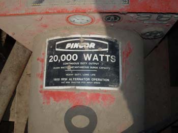

Thanks for the quick reply. Thats my next question. What is a "good" price to pay for this? It "looks" OK. It's dirty, but that is expected. It's a typical farm auction. The do have it hooked up to a tractor, so it will be fired up tomorrow.Auction link
