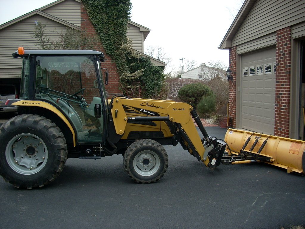

Hey Roy,
I built my rig based on Northern Maine's design but altered it by moving the plow pivot point back under the Quick Attach plate. By doing that, the plow is 15 inches closer to the tractor. For me, it makes it a much more compact unit. The beauty of this design is that the weight of the FEL arms have no bearing on plowing. The only weight on the ground is the weight of the plow.
I tried that last season with my Challenger, but didn't like it. The plow had no down pressure and was too light to scrape snow off driveways for my liking. It worked, though!
