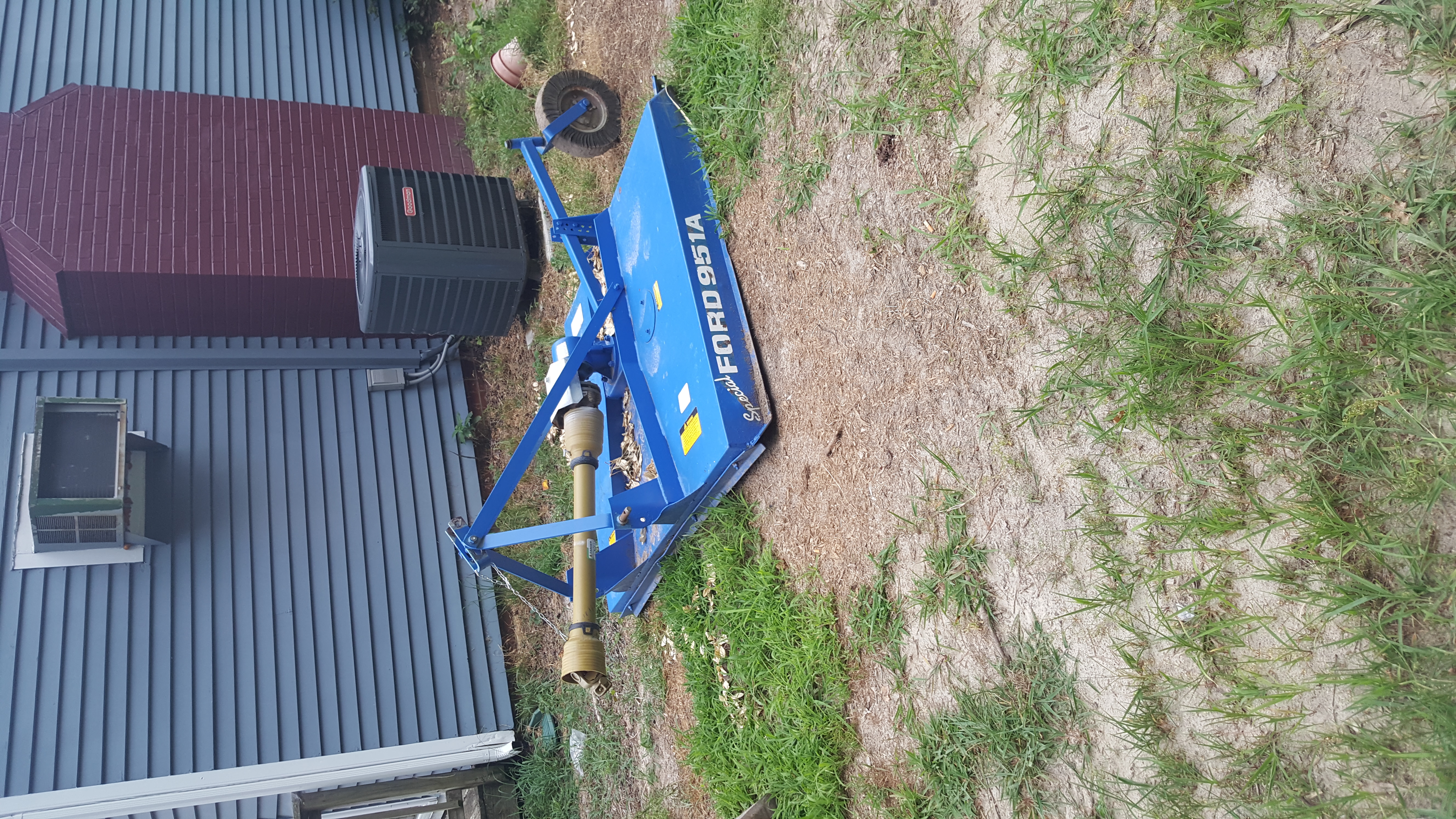

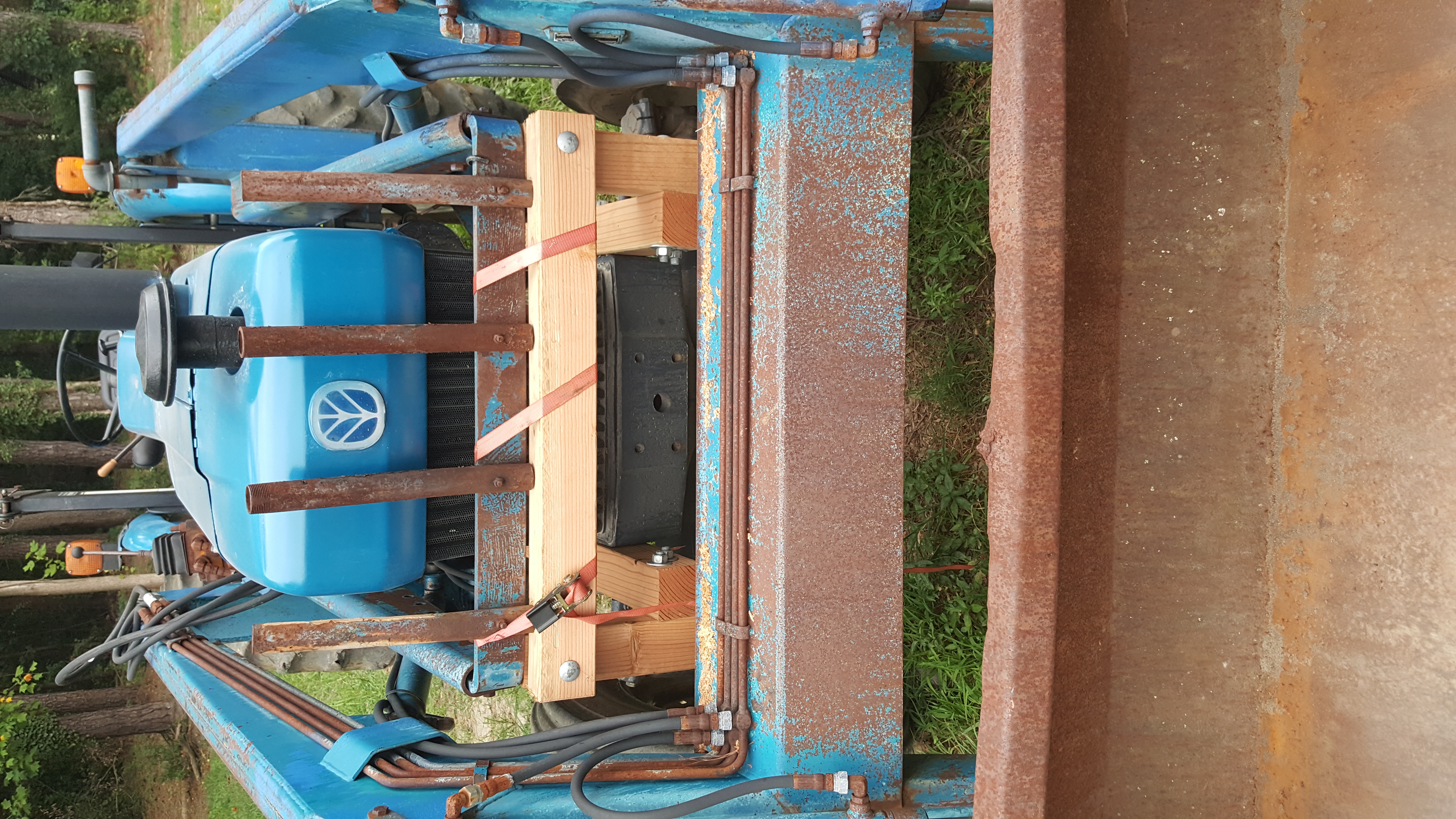

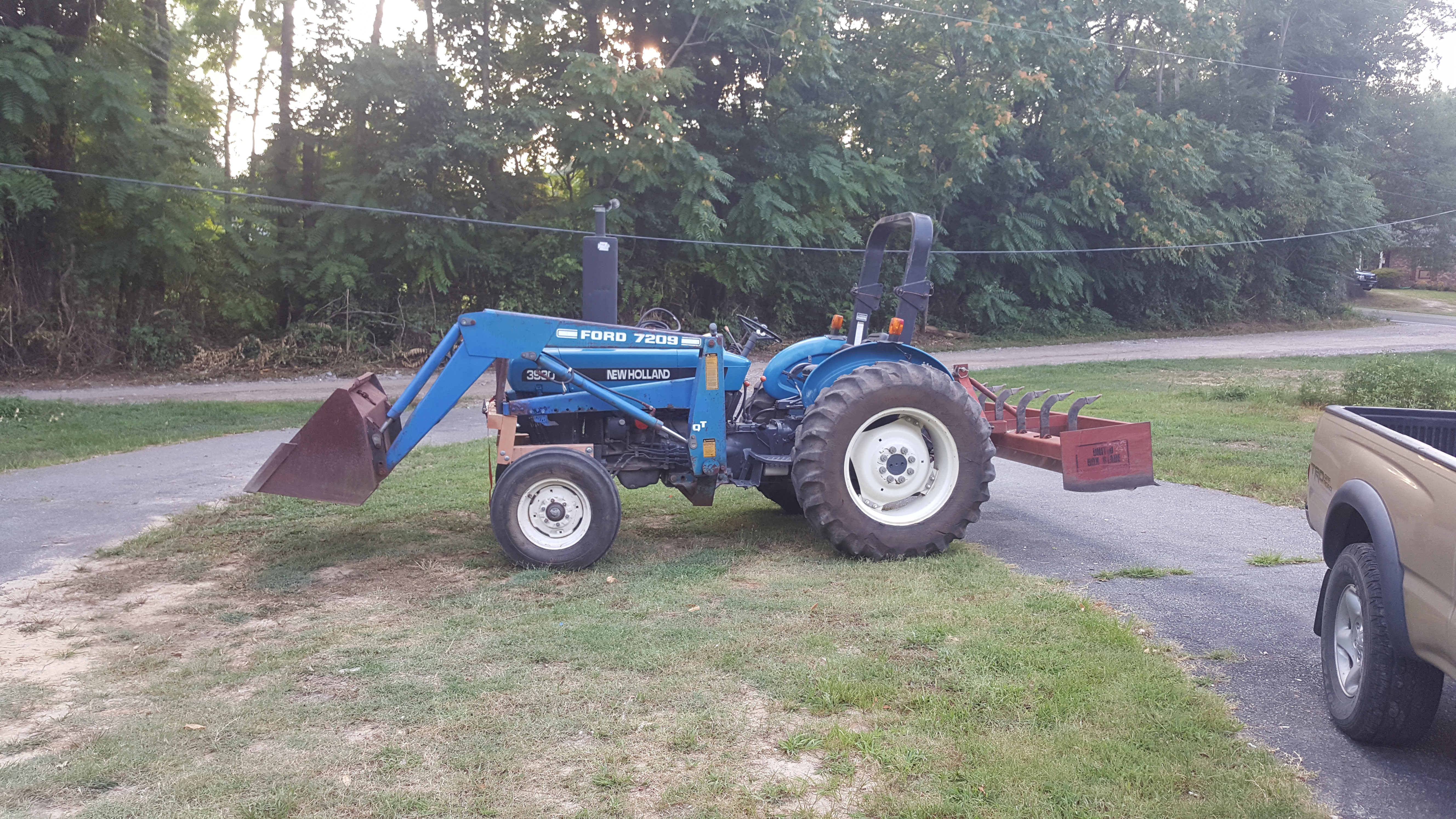

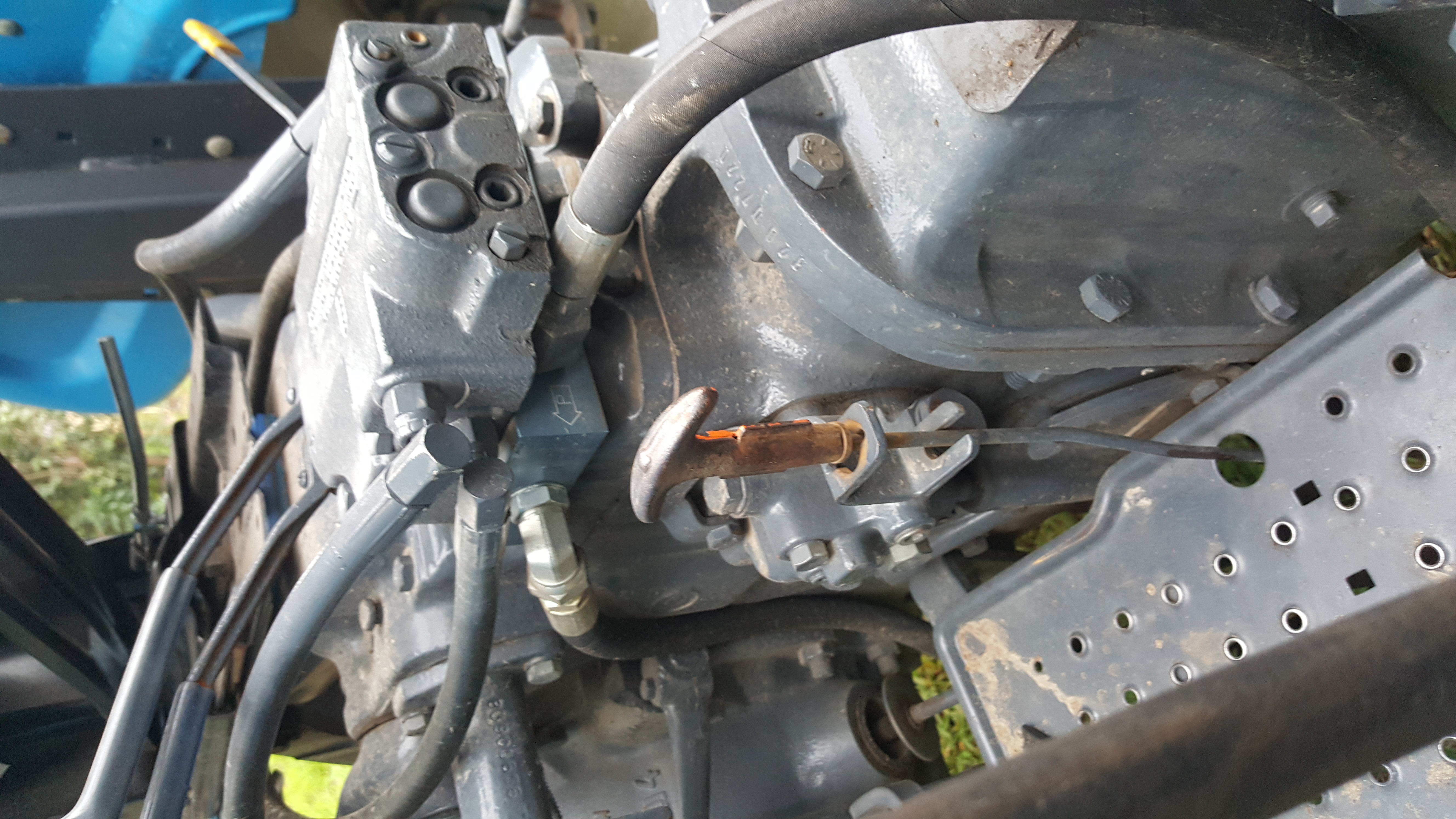

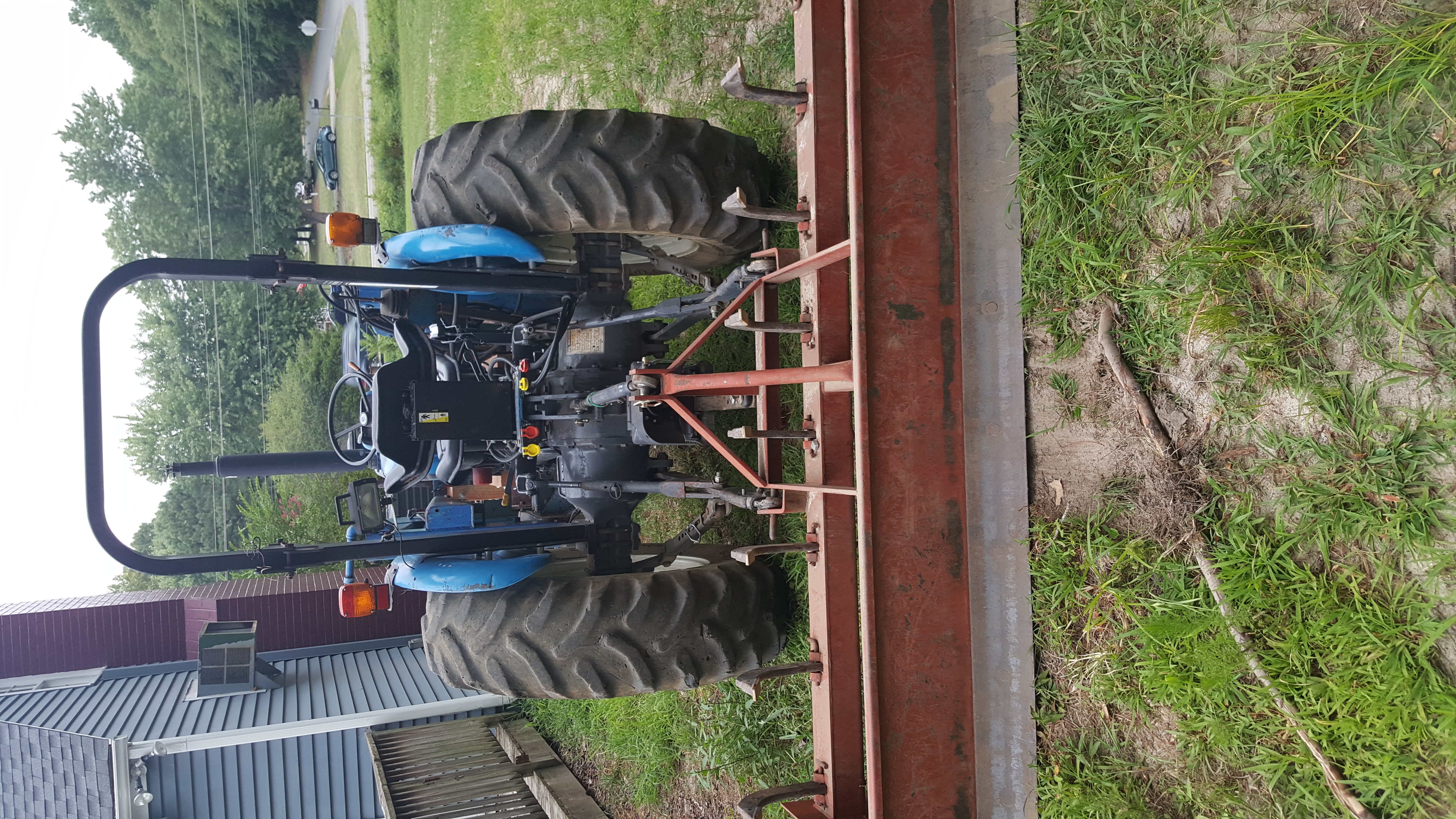

So I've made some progress and the welding shop I'd like to use is just too far for this project. Researching closer shops. But for now I can at least move it around. Bushhog I repainted, will probably upgrade eventually, it's a bit undersized and has a ton of flex when throttling up. Would hate to tear it up.

You really need to make use of the hooks on the side of the front end loader frame. They keep the loader frame from walking up and down on the rear mounts. When it walks up you will smash the nose cone of your tractor. Any decent welding shop should be able to fab a mount using the existing bolt hole locations on the sides and front of your front axle support.
   / Photos for 3930 and 7209 loader progress
It's a temporary set up to get it to a shop. Front frame is currently strapped to prevent it riding up and down. The one photo you can see the entire front of the frame work is resting on the wood with the strap. I'm not currently working it in anyway with that set up.
