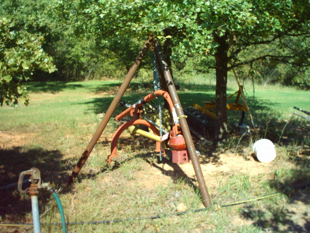

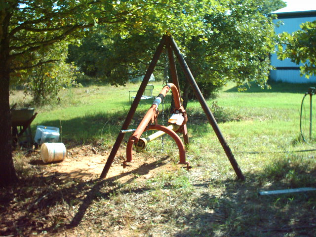

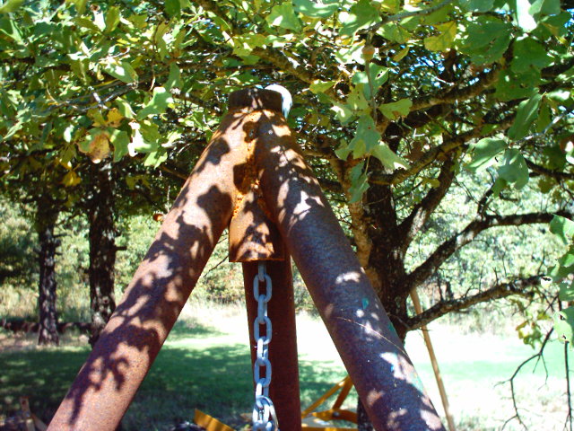

I finally got myself a digital camera. Here a few pics of a simple PHD tripod I built a few months back. The welds aren't pretty, but it holds. It makes my PHD the easiest implement to hook up now.
   / PHD stand
#2
Another view

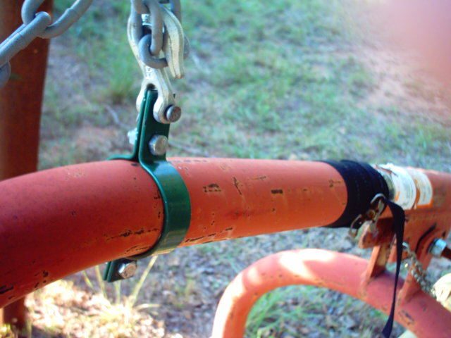

   / PHD stand
A view at the top. I need to paint it one of these days.
   / PHD stand #4
Looks good. Welds look like most of mine. Gives me some ideas for what I need in my shop.
Thanks
   / PHD stand #5
Thanks for the photo's, you did a great job. Do you leave it outside all the time?
PJ
   / PHD stand
Yes it stays outside. I do not have a shop building or covered storage. I figure if I can keep it off the ground it will be okay.

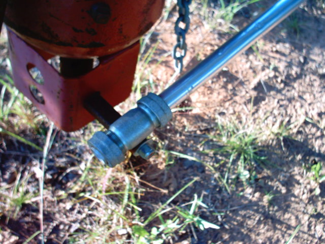

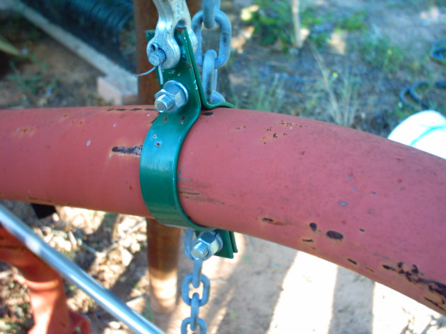

   / PHD stand
Here is a shot of how I have the chain attached to the PHD. I made this with a strap bender I bought from Northern Hydraulics. I did not want to weld directly onto the PHD.

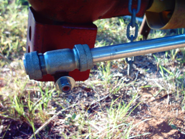

   / PHD stand
A shot from the other side

#9
And to help get the auger in a vertical position without getting off the tractor.
   / PHD stand
Another view.
