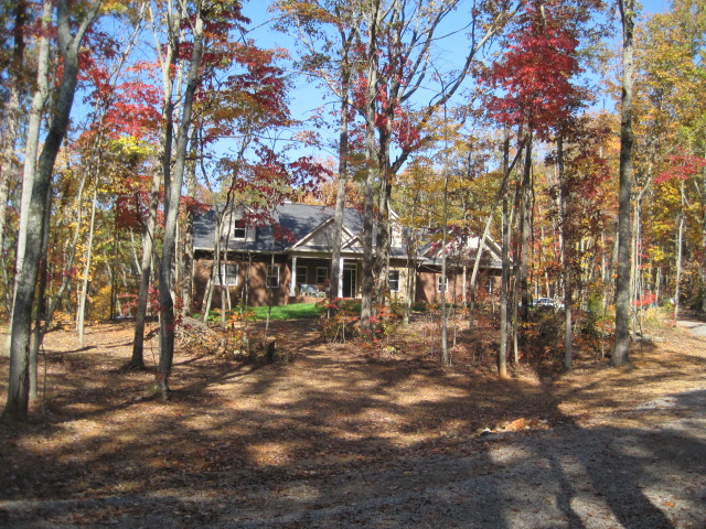

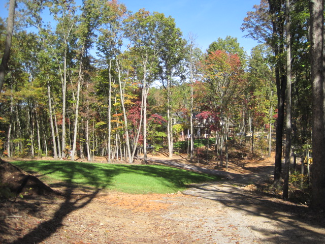

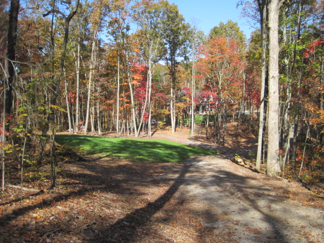

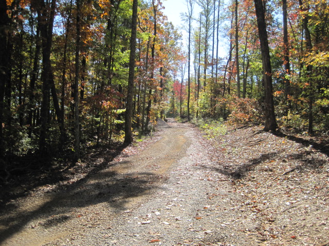

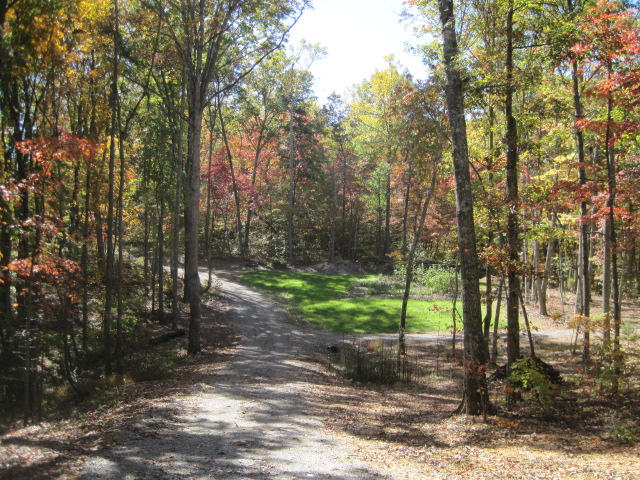

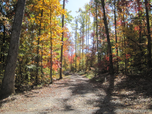

We have a 600 ft gravel driveway. Gravel doesn't impress broke yuppies but I don't really care what they think. Life is too short to worry about what foolish people think. Dust from our gravel driveway has not been noticeable for us but we don't live in AZ.
attachment.php
I would put in a gravel driveway and only pave the approach to your garage if you want the clean look of the asphalt. Drive a reasonable speed on the gravel and dust may not be an issue. You can always pave it later if dust is a problem.
