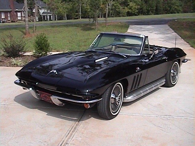

Yes, that's my (soon to not be mine) '65 Corvette big block. I just got a decent offer on it the other day and am just waiting for an appraisal to be done. Oh well, it hurts less than when my Harley went./w3tcompact/icons/smile.gif
4500 lbs......they sure made 'em svelt in those days, didn't they?

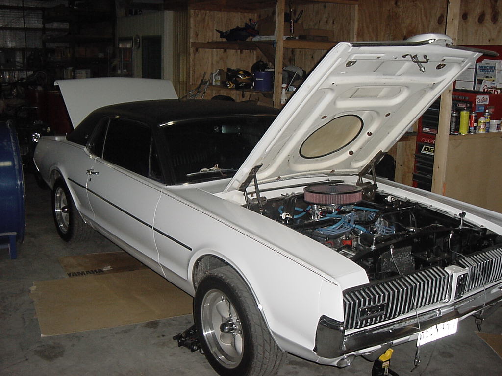

My partner just used a Master Power conversion kit for his '67 Cougar. It looks like good quality parts. Dual piston calipers too. Even though I didn't deal with the company personally, I know that they were very professional after the sale. The kit they sold him was for Mustangs, and the company told him they had little experience with Cougars. They worked with him to make the kit fit, and took back the parts that wouldn't fit. I will use them for my '65 convertible Mustang.
